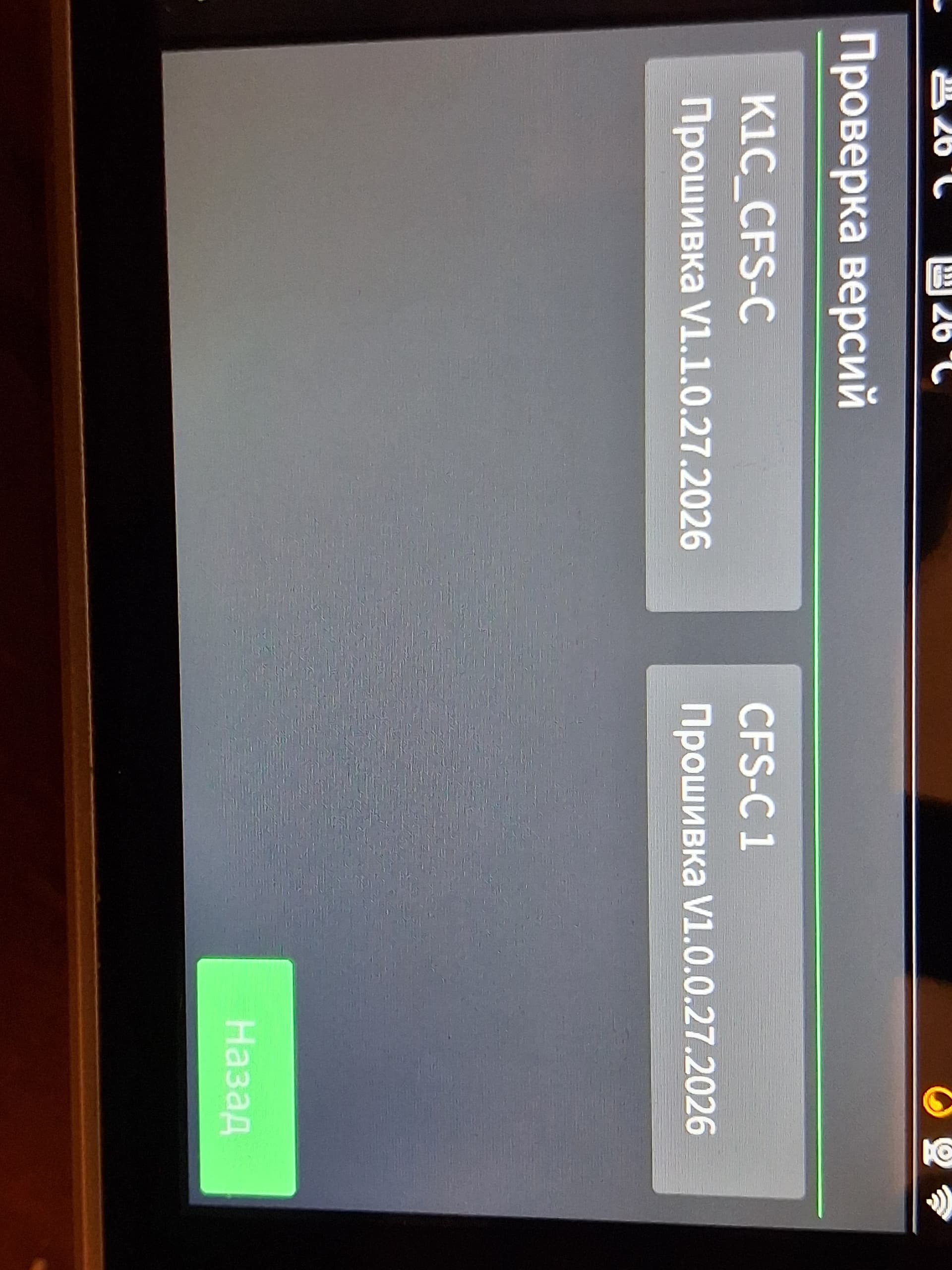

Thanks for the idea, but how would I go about updating the firmware? It says it is the latest, but I wonder if the latest for some reason doesn’t work.

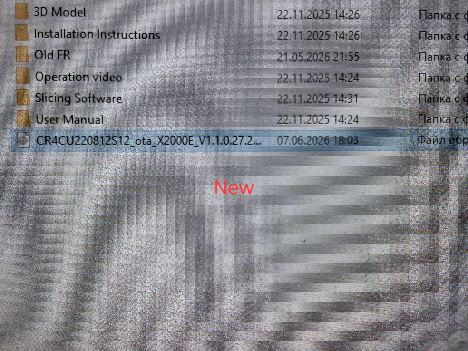

I installed the firmware that came with cfs-c, and then downloaded the latest update and installed it in the same way as in the instructions, placed the firmware in a folder and marked it as an older version, and replaced it with a new version.
I think I did your idea right, but every time I tap one of those under Version Checking, it just tells me I’m on the latest version and won’t update/downgrade the firmware.
When copying the firmware to usb and after connecting to the printer, he offers to flash in the menu, you need to agree and the firmware will go. I think the old version can also be put on the printer.
