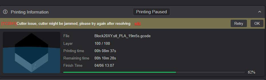

Hello,
i installed the CFS upgrade for the K1C, now i have the problem, evertime that my printer screams: "[TC2841]Cutter issue, cutter might be jammed, please try again after resolving "
I tried it a lot of hours, cleaned all, but nothing worked. I need HELP! I cant print now.

The cutter works with a magnet. If there is even a little piece stuk it wont work. Take the extruder out en slide the cutter by hand. If you feel resistance then there is a piece in the way
Everything is fine but I tested the connection of the “Cut” sensor with a multimeter and found a small short circuit. Unfortunately, I could not identify the cause, but I believe the issue lies within the sensor’s circuit board.

I had the same problem, then I realised that it only does it for one colour. I changed to another brand of filament and everything works again. Apparently the pla I bought on sale was somehow tougher than normal and didn’t want to cut
I mailed a lot with Creality Support, i get a new cutter and a new inspection plate. I will report if the Error is gone.
same Issue with K1 Max/CFS Upgrade Kit, a few emails back an fourth i was asked to run a multimeter, which i do not own but am awaiting a replacement extruder, potential for a now known issue with the filament intake PCB, as the little blue LED on the top of the extruder is no longer lighting up and then started having the same issue as OP
I just upgraded mine with the CFS and K1 Series Ceramic Heating Block Kit, and i currently have a black and white Hyper pla, but when its swapping from black to white it tries to cut but wont and fail, i cut by hand on the lever and its very tough. any help?

Слева и справа вы ославляли болты, когда прикручивали ножку для резака, ослабте 2 болта слева, вставьте отвертку в прорезь сверху там пружина чуть чуть ослабьте натяжение ремня и затяните не убирая, ослабляя отвертку. Далее опять самопроверка

Reviving this thread to share my experience.
The install was pretty straightforward—thanks to the Creality YouTube channel. But when it came time to purge, cut, flush, and prime, I hit the same cutting snag others have mentioned. I ended up spending half a day troubleshooting and wasting meters of filament.
As a last-ditch effort before calling it quits, I dismantled the tool head. Turns out the extruder wasn’t fully seated, causing the cutter lever to bind. After reassembling and running a full Self Check with Cutter Calibration, it is now purging, cutting, flushing, and priming.
