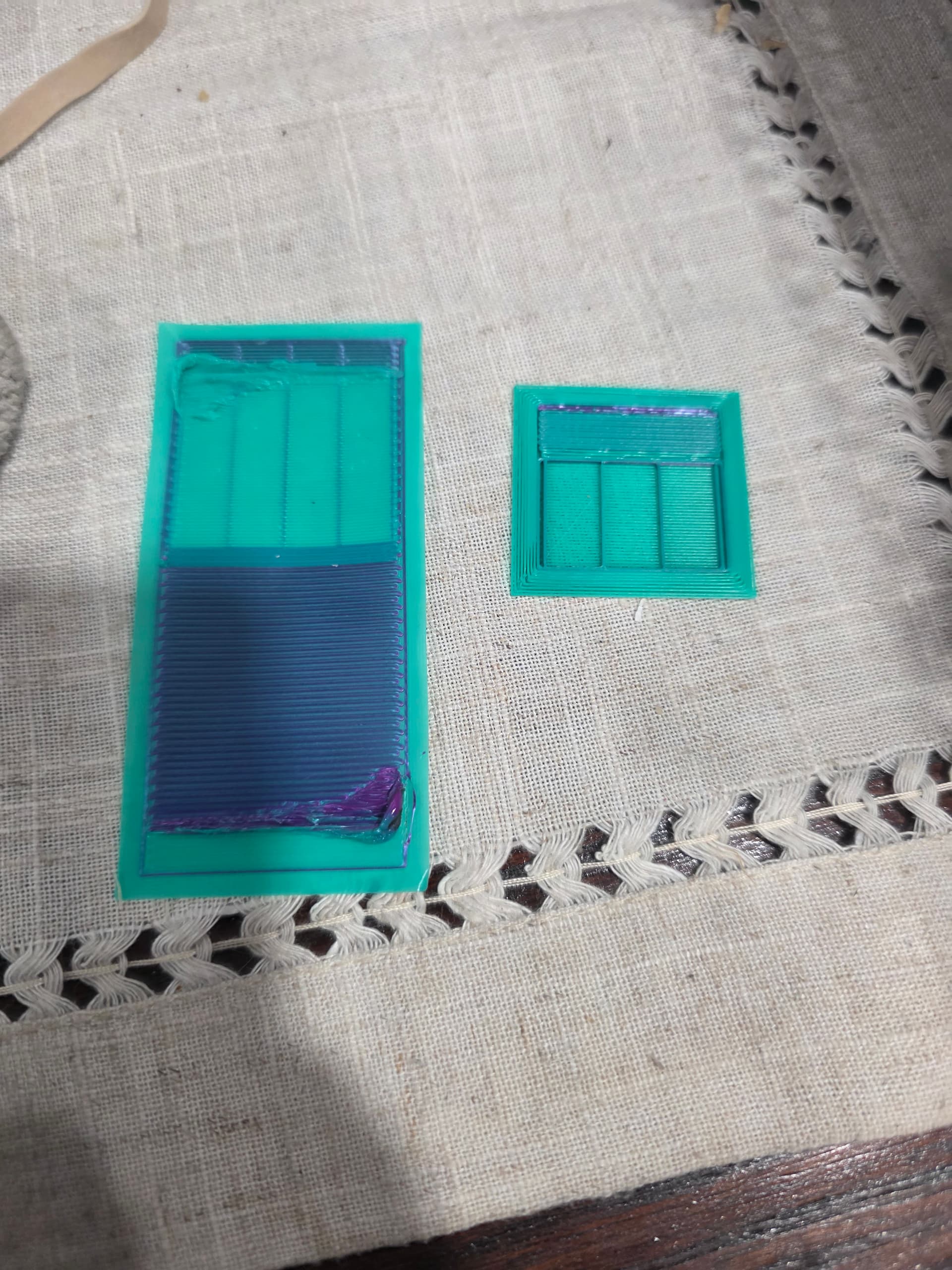

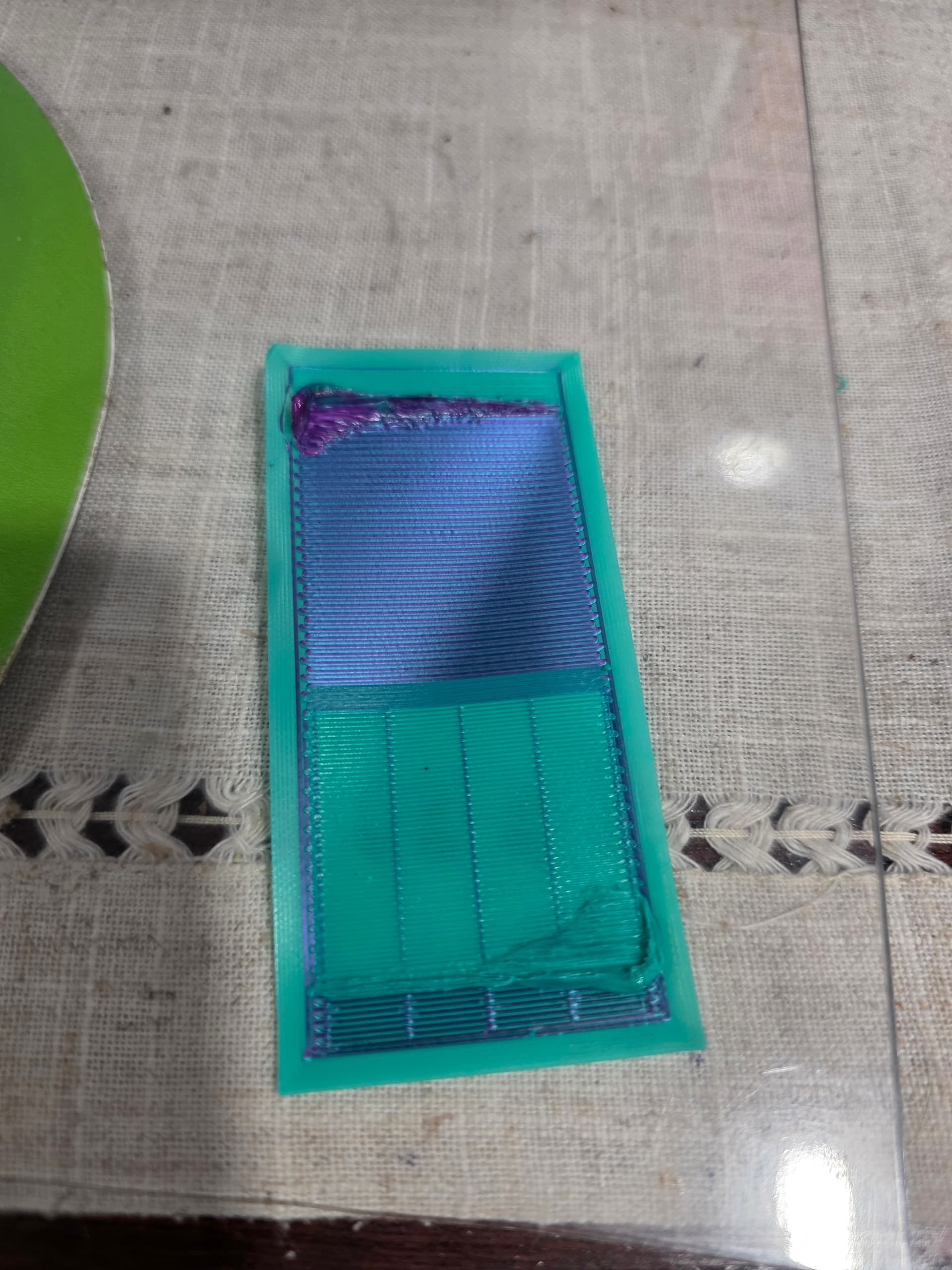

After every color change with my K1c with Cfs, it immediately goes to the prime tower and leaves an initial blob, than prints fine after that. The blob than causes impact with the nozzle when it goes back over that area in the prime tower.
The model seams to print fine, I am thinking its a software/setting issue and not a mechanical issue. I am using OrcaSlicer v2.3.1

The nozzle was clear. I am printing with a .4mm nozzle. This filament has only been used for this CFS multi-color model.
I am printing the model now with Creality Print, and after a few adjustments, it does not do the blob in the prime tower, or at least at the point where it was recognizable. So I am printing one of these models and see how it turns out.
The prime tower on the right is the one from Creality Print. This is before I tweaked a few settings that improved it even more. Also notice the size difference between Orca and Creality.
Do a cold clean of the nozzle.
@WVLarry The right prime tower looks good. Maybe this is the way. I’ve never used Orca, so I won’t help you with adjusting settings, but good luck!
