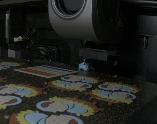

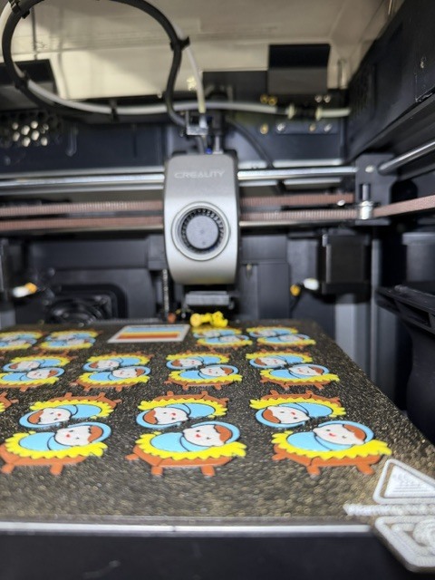

Hi;
My K1c usually directs the filament “poops” properly but sometimes also spreads stuff on the print field. Pics are from the same print in progress. I had redone the purge placement before this run as well. The whole structure leans slightly to the right since installation–but I don’t know if that would be the issue. I had tried to re-position the purge area but couldn’t get it perfectly 90 degrees.
Any thoughts would be great, thank you!
Try recalibrating the purge coordinates .
