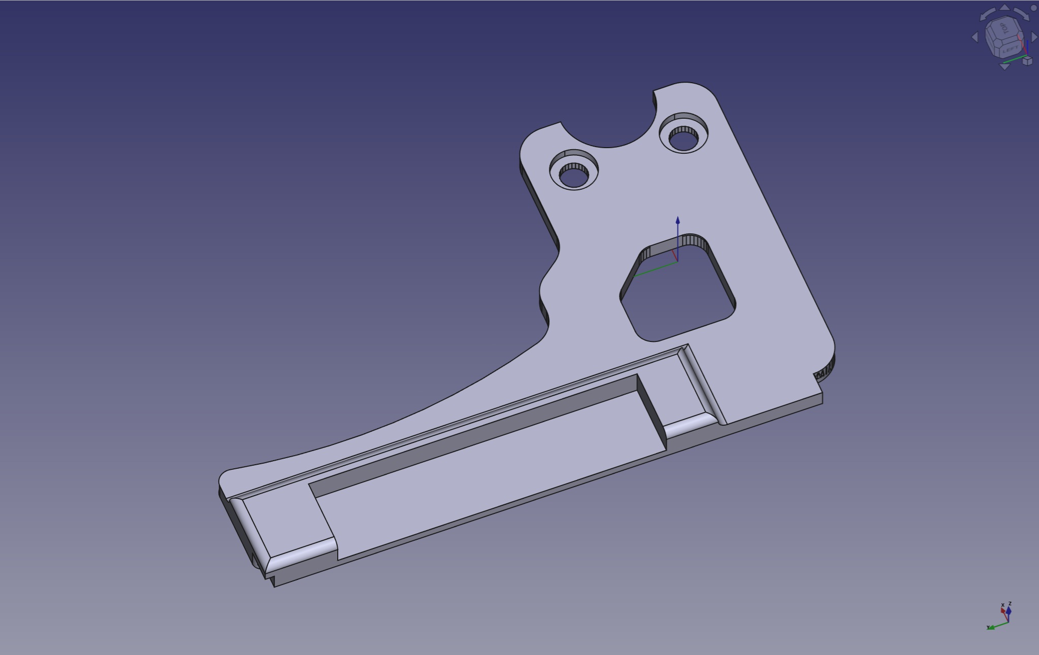

So, I wanted a 3D printer that would print out of the box, so I chose a K1c. I pieced it together in the cheapest possible way with printer, CFS upgrade kit and CFS box itself from separate sources. The printer came in first, and I’ve been using it using Orcaslicer just fine. I put about 20 hours on the thing, and in general I’m quite happy with it. Then the CFS upgrade kit came in. Earlier this week, I installed it, did the firmware upgrade and the printer still does what it needs to do. So far so good. But then I started noticing little things. First of all, the wiping thing. I didn’t stick on the new wiper on the plate as I hate that design. Who came up with that? I like to use different style of plates, also dual sided ones. And the original Creality wipers are unobtainium. So I found and printed the required offset wiper adapter that screws on to the Z-axis screw block thing. Then I modified it to take readily available 36mm Bambu silicone wipers. But when I paid attention to the whole process, I noticed that with the new firmware for the CFS the whole wiping process only uses like 5mm of the silicone wiper and the speed of the wiping seems to be tied to the print speed the model is sliced with. In short, the printer doesn’t really do much wiping and if it does it’s so slow it doesn’t do anything. I’m just as happy not to use any wiping at all (none of my other printers have this “feature”, but if it’s there (and can’t be turned off) it would be nice if it works properly. Anyone else have this issue with CFS upgraded K1c or just me?

You are correct, typical Creality 75% solution. This one is fantastic, works perfectly without issue with the CFS. K1/K1C/K1 SE Napkin Strip Saver for use with CFS Upgrade Kit – Nozzle Cleaner Mod by C3D Garage | Download free STL model | Printables.com

Yeah, that’s the model I modified and made into this thing.
It’s a bit rough still, but I needed something that worked with what I had, I’ll make it pretty $Later[TM].
