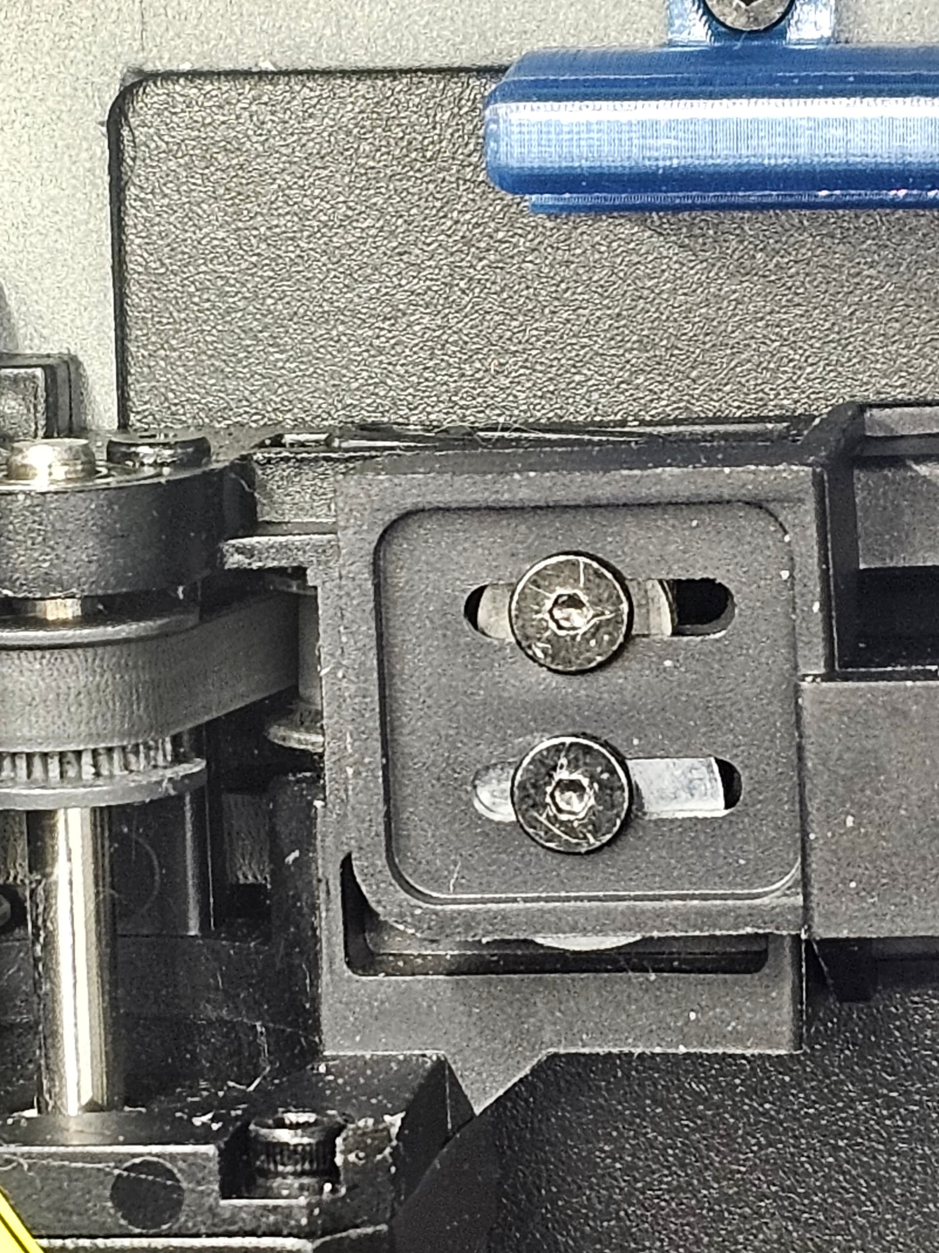

Having an issue with the Cfs upgrade for the K1 MAX. It seems that the cutter is not hitting the cutter block at all. I’ve done the calibration multiple times and it looks fine. When I go to print it does not even hit the block. Then I keep getting the dreaded Error Tc2841 which is not the case. Has anyone else gotten this issue. Any help would be great.
Can you take a picture from a higher angle so that the entire corner is visible and shows how everything is assembled?
I’m thinking it’s something software related because it calibrates fine and I also do the purge calibration but it still doesn’t even line up with the cutter or the Purger during prints
I put 2 tiny washers BEHIND mine and has cut with NO errors at all. works really well.

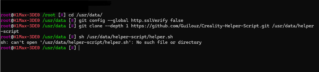

Thanks for the help, i keep getting permission denied when typing the above code in. Am i doing something wrong. it also wont even let me download the git helper to even dowload fluidd. It just keeps saying no such file or directory exists. Id appreciate any help
You can not install helper script this way. Try this way:
