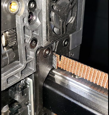

Any one here have had there belt slowly shred? I have about 500 hours into this and about few months of ownership. I can not find a belt replacement, amazon shows one but its aftermarket not creality, any one experienced this issue? Btw i also keep my printer maintained if it matters and calibrated.

My K2 has approx 130 hours on it, and I just purchased it in July, Last night after cancelling a print, the head thrashed to the left very hard⦠and then the same to the back wall of the unit.. and then it stopped.. the filament didnāt get cut.. and the CFS couldnāt retract either⦠Once I finally re-heated the head I was able to issue a filament retract command with the touch screen, and it successfully retracted properly. But then I noticed that the belt had gotten torn pretty bad almost all the way thru right near the print head on the right hand side. Just contacted them via cs@creality.com will see what they say. I would like to just replace the belting myself if I can, I dread having to ship this beast back anywhere, and Iām very printer tech savvy. Looked online in their youtube videos, and there is not one specificially for XY Belt replacement for the K2plus for some odd reason⦠but thereās tons of other videos⦠Curious as to why?

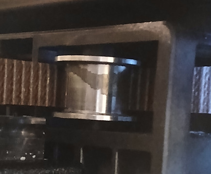

Yes - the belts on my K2 Plus are shedding material that accumulates on the pulleys and results in a squeaking noise during rapid movements. I clean it off with a cue tip dipped in methylated spirits, and also wipe the belts themselves with a paper towel (Creality support however have recommended this cleaning procedure) - itās clear the material is coming off of the belts. Iāve since had to do this several times over the course of a few months.
Iām considering replacing the belts, however noticed that though they are GT2 pitch, they are NOT 9mm width as expected but instead 8mm! This is a rare width for GT2 belts, however I have found a few links on AliExpress including this one.

Here is an image showing the material deposited on the pulleys:
The rest of the belt still looks good. I think there was a small defect from the start. I would try to claim this from Creality. Dont know what the effect is of a defect belt on the pulleys bit i think i see it on your picture.
Update, I got ahold of a customer service rep tonight via chat and She is going to get a new belt sent out to me within the next 10 days. A bit slow but acceptable. I also ordered a set from the link above, but thats also from china so it will be about the same shipping time or longer. There are a few on Amazon for about double the aliexpress price, 16bucks but I think Iāll just probably wait for the one from crealilty than order a 3rd replacment. Once I have the replacements knowing my luck Iāll never need them again LOL. but it was fairly painless to get this replaced so Iām happy.

Latest update.. Creality support got back to me fairly quickly and fedexād me a new replacement belt that was the proper length. I just put it back on using a combo of a few of their repair videos becuase they still donāt have a belt replacement video that actually shows how to replace the belts.. I had to remove one of the auto-tensioners to thread the belt around the motor gear properly but that honestly wasnāt that hard, just an extra step.. Printer is calibrating as I write this and I think everything is working again.
BUT⦠if you look at the picture above that I originally posted.. I have a new theory about how this happened.. it was actually a manufacturing defect. now that I have the belt out of the machine and Iām looking at the āripā , firstly I canāt even begin to rip the belt in my hands if I yank on it very, very hard⦠Its STRONG⦠so looking at the angle of the āripā and the slight off angle of the end of the belt where its folded over to insert and lock into the head , it appears that actually whoever assembled this unit snipped thru half the belt when they were cutting off the excess belting during installation. I never noticed it until the gantry crashed but it honestly appears that it was definitely cut thru with nippers. Iām gonna follow up with support on their e-mail but at least I can be fairly sure that the belts will last a while now that I really see how strong they actually are.
