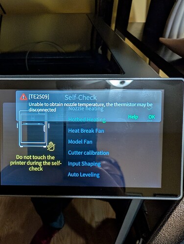

I feel your pain, I have been trying to get my printer functional for a week. Multiple factory resets. Support seems absent in response. I am feeling I got a boat anchor or paper weight. I chatted on the site this morning, which they just seem to be the front end for support. I said either I need a resolution or you need to start to process my return. My ender 5 pro has been working great over all these years. What a joke.
Open the back panel (Switched off and disconnected) and check all the wiring terminals. Also check thermistor connecter at hot end in case it is loose etc.
Back Panel is off, I don’t see anything that is obviously loose. I have checked for loose wires and have reseated on the front, so I know it isn’t there
MettaUK Thanks for the reply. I also have check the panel inside the unit upper right side. there is a lot of wires and I couldn’t find anything loose or labeled like I would have thought. I also inspected the cable that attaches to the print head. I honestly wonder if it is software or a bad board inside of the unit.

Yes it does take time for them to get in touch with you and reply back. After doing so they sent out a new door, a strain gauge and a y axis calibration. The strain gauge was incredibly complicated to change out. The door was pretty easy. They told me to contact them after that for the y motor board but now it calibrates fine and works. On the flip side if you got the worry free protection from their site when you ordered it, go on their site and file a claim. I will say that creality has really tried to do their best and I am sure with a ton of emails it is the best they can do … but Seel, the insurance I got for the K2, has been amazing and when I was asking them to please get me a machine that worked they really stepped up and made me their fan. If you bought the insurance, file a claim…TRUST ME ON THIS…if you didn’t, then I am sorry but you will have to have patience and wait for them to get back with you.
If it helps, they are on a different time then we are, so while I am on central time, when I was dealing with them I would wait to send my emails until about 2am and I would get a response within like 40 minutes. If I sent it during regular daytime hours here, it might take a day sometimes 2… All of that to say I hope you got the insurance, again file a claim, and I can tell you that after going through the same issues my printer is running amazing now, except for some network issues it has with creality print I am having to work around but they have dropped 2 updates in 5 days trying to fix it so you have to give them credit, they are working on all the issues.
