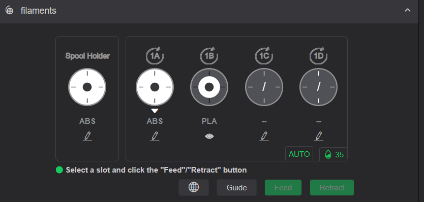

Yes, should see something like this :
in Creality print and be able to edit filament to be used or RFID scan the external RFID reader and load that spool onto the external holder, but manual intervention of some form will be needed to change from CFS to external filament feed. There are Y couplings available like this one K2 Plus CFS Y-Coupling by shenanigans | Download free STL model | Printables.com that I am looking to add to my K2+. These remove the tedium of disconnecting and reconnecting PTFE tubing on a stock K2+ however the external filament will have to be manually pushed all the way into the extruder after all CFS filament has been extracted. To my knowledge there is no way to automatically switch from the CFS to the external spool because the external spool is not able to communicate and auto push into the buffer.
Apologies if I was too verbose, missed nuances or assumed something incorrectly.
If you go the other way and use external spool first, before switching to CFS in theory you should be able to auto print 5 spools … as long as the external is the first consumed, then when the filament detector recognizes it’s runout switch to CFS…
Not tried that myself…
