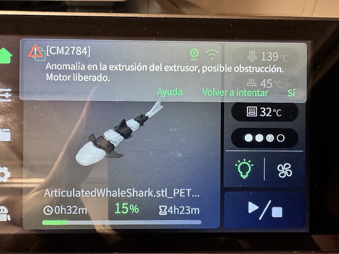

Now I have the same issue in the 2 k2 plus I have and I think the issue could be the filament sensor because it has a warning in fluidd. I sent an email to Creality and also I ordered two filament sensor. I hope they will be here soon, I can’t use the machines now because they are sending errors all the time because of that

Mine two had the same error, I don’t know if it is an error from filament sensor or what but the truth is I can’t print anything with them

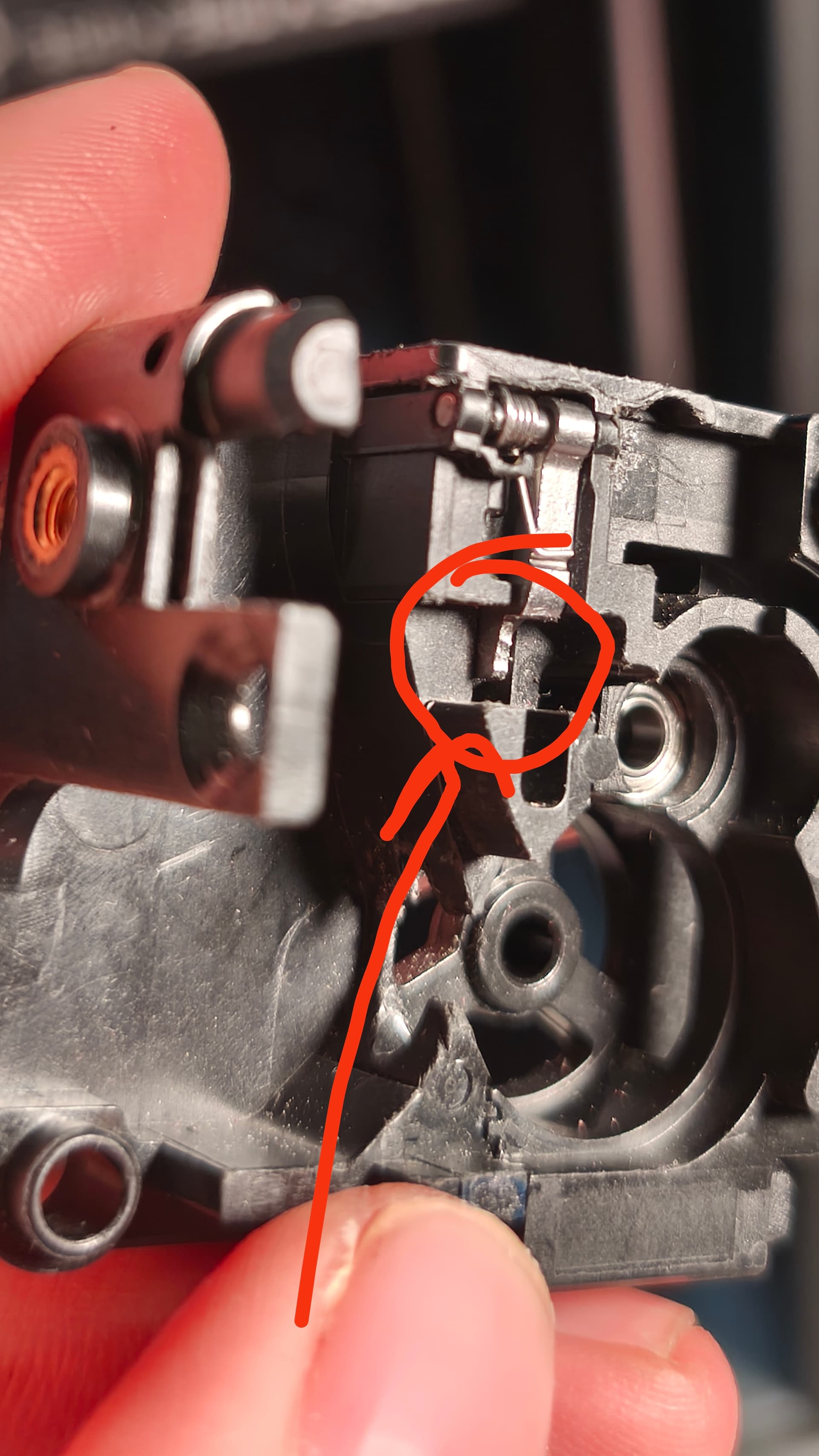

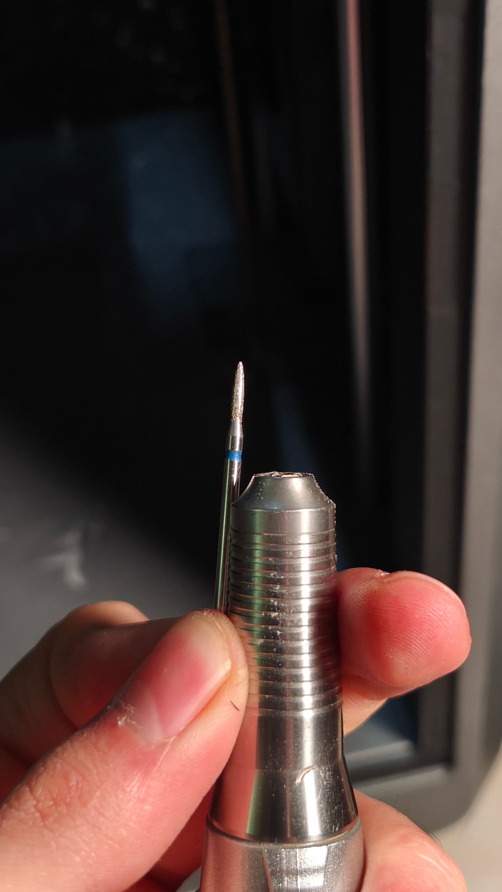

Hi I have used a electric nail file to smand the part I have showed in the photo
In my case nothing helped me but this thing did it and I haven’t have any problem and any errors
Sometimes the trigger gets stuck or is to close to the sensor
So sand this don’t tighten the screws so much and then change filament
If this didn’t work change the fillament sensor that they have gave you with the printer it’s in a small box change it and this may help you
