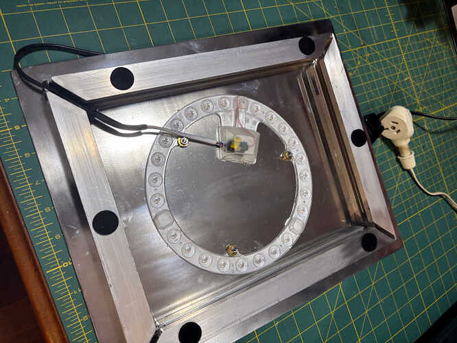

Made up a polished Aluminium light holder that sits sandwiched between the top of the K2 and the CFS.
Couple of views.
Illumination on the top of the lowered heater bed is now 1175 lux, up from 375 lux without the reflective light holder, ie from just sitting the light on top of the K2.
Am more than pleased with this. Thanks to my Aluminium Boat builder BIL who came over and supplied the Al and incessant chatter for 2 hours while he knocked it up - all I did was polish the Al top and and supplied him with necessary tools and laughed at his dad jokes.
