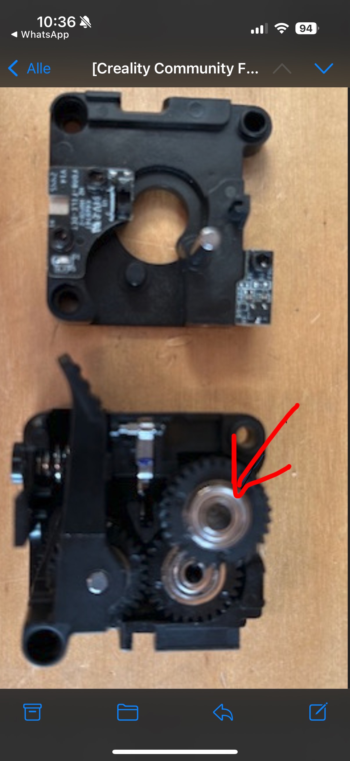

Then i opened the extruder Front and found a totally damaged gear. After more research i found out that i am missing the bearing on the cover side which holds the motor gear in place.
Does someone know where i can get a fast fix, maybe just the bearing dimensions so i can replace it fast and dont have to wait fir the support to clear that.

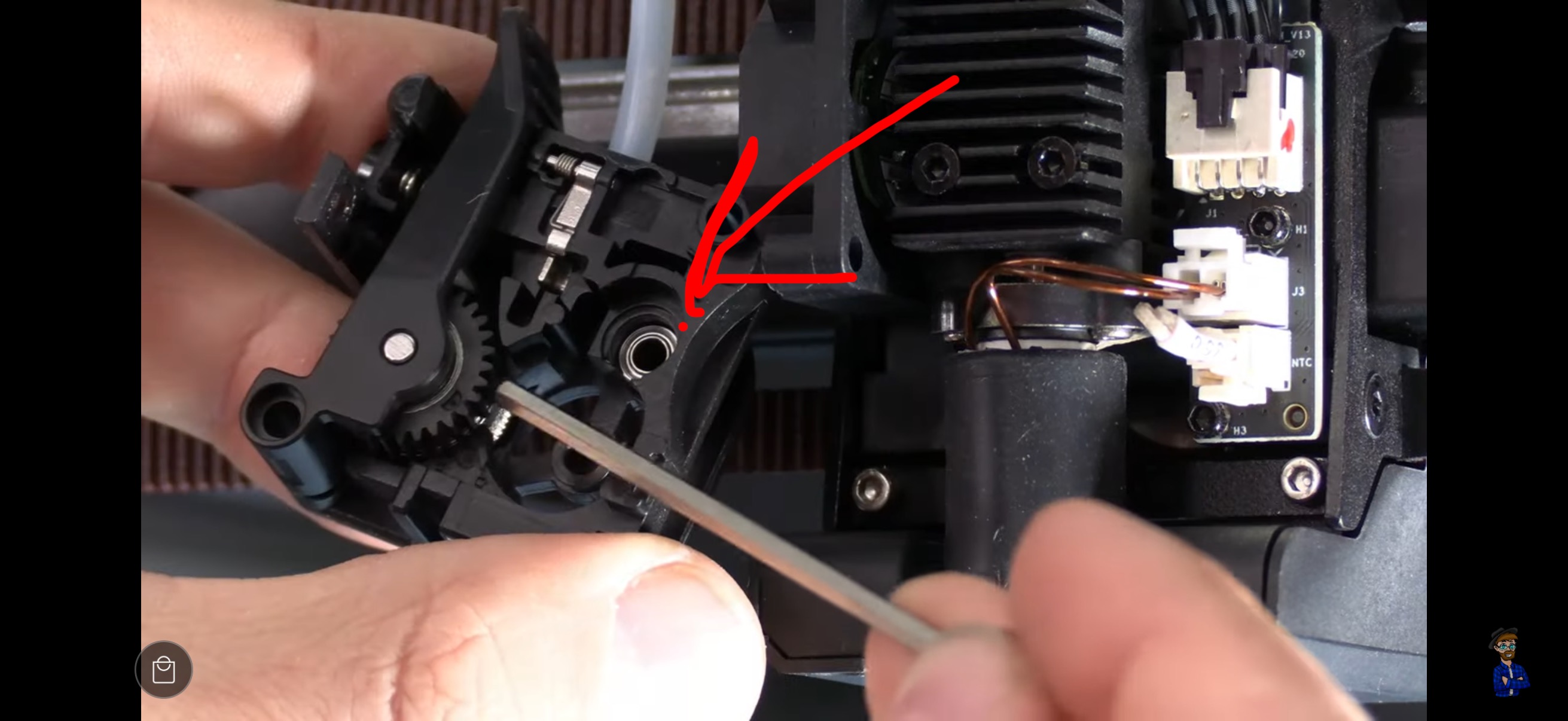

Are you sure your missing a part. Here is a picture of what it should look like
There are 3 gears, 2 on the same plane and the third can sit as per this picture and fits into the rear portion of the extruder. When it on the pin (on the rear part of the extruder) it will appear that there is a hole in the front part but it is just where the bearing sits.
Under the marked gear should be a bearing inserted in the plastic cover as far as i am aware

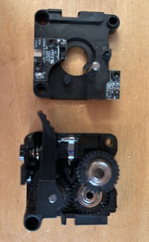

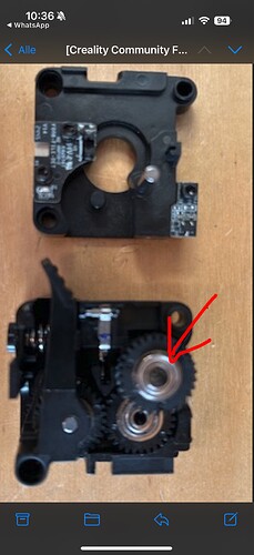

This one is missing in my front plate
Unfortunately it only comes inserted into front extruder. Can’t see its available on VIP Mall.
I believe its 3mmID 4.8mm OD 4mm wide. Could be wrong though. far easier to buy replacement front .
