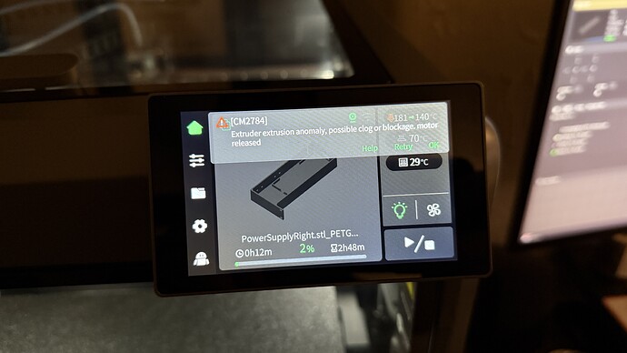

So, I was sure that reverting to the November firmware was the fix for me, and it was for a couple of prints using the PETG filament that was failing after the new update. But, I’m now once again getting error CM2784. I can still print just fine with my Hyper PLA filament, really no issues with that at all. But, when I print with the Hyper PETG I get to around the second layer and then it quits with the “Extruder extrusion anomaly” error.
I’m guessing that like others that are having issues just getting their extruder motors to work, my issue is similar. It will work, but maybe the PETG filament is just tougher on it than the PLA and it fails after that first layer. This is really annoying. I will contact customer support, again, and see if they can send me a new motor… if that is actually the problem. Who knows.

Yeah this is definitely not related to CMS. I also had printed a bunch of prints with the PETG filament before. No issues until the firmware update, but now I’m thinking it was just a coincidence and the extrusion motor just happened to start dying at that time. Right now, it wont even extrude anything. If I manually tell the printer to extrude, I dont see the little gears on the right side of the extruder assembly moving at all. So I’m guessing that that motor is either completely or mostly dead as of now. I might try again tomorrow. Maybe a good nights rest will make it feel better.
More data: today I replaced the nozzle with the spare one included in the box. After replacing it, it extruded perfectly and with no problems. I then calibrated and attempted to print. When the print started, nothing at all was being extruded, and also no errors showed up on the printer screen. So that’s where I’m at, sometimes the printer decides to extrude, and sometimes it doesnt. The problem is not the nozzle, not the print settings, not the filament. I can only guess that it’s the extruder motor.

For reference, here’s what I get from my Clear Hyper PETG when the printer decides to actually extrude. Sometimes it just wont extrude. (this same model with same settings printed very well before the latest updates. Not saying the updates are the cause, just that that’s when the problems started) With the Hyper PLA I do get a better ratio of success and will sometimes even print a full model with no problems.

My issue has mainly been with the CR-PETG to date. I can get first maybe second layer and then error code (pretty much every code that has been listed in this thread and then some). It would usually stop with no filament extrusion. Had a chance to really watch the machine as it was doing it’s thing the other night with PETG and noticed how the nozzle seemed to push the material a bit and not leave a even first layer. I am new to 3d printing (this is my first machine) so any issue is a mystery to me right now. I ended up going into the Setting>Expert Mode>Z_Offset and lowered the Z-offset by .1mm. The layers started to print smooth and the periotic buildup around the nozzle stopped. I was able to finish a 5 hour PETG print. Going to try again tonight starting off with the Z-offset. I’m not sure that this is my only issue, but it seemed to clear things up for that print.
All that being said, this machine was flawless up to the new firmware update. It may be a coincidence, but why should I need to go in and adjust the Z-offset for this filament (Creality CR-PETG) where it had always worked per the printer settings. Like I said I am new to this, but it seems as though some of the filament parameters have been corrupt.
