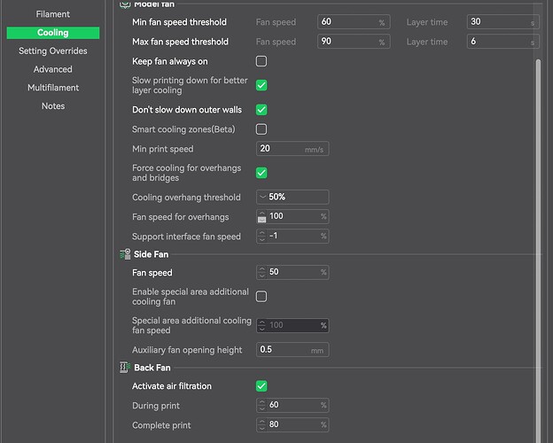

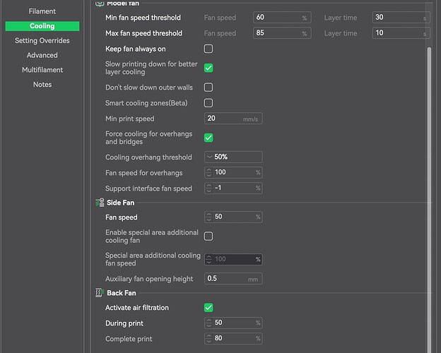

    • Adjusted fan speeds and timings of fans because large gaps were seen between some of the initial layers

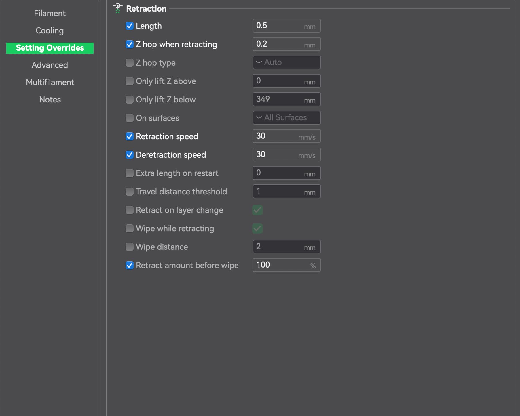

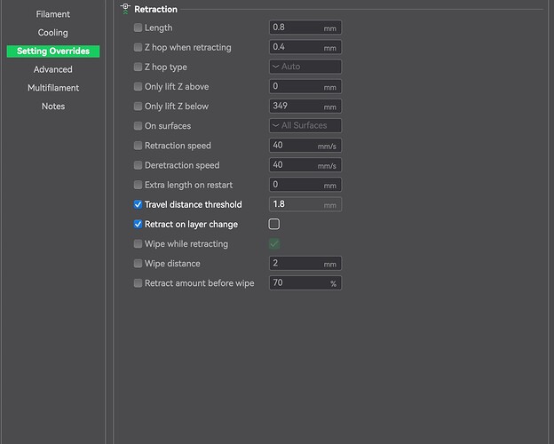

    • Adjusted extrusion and retraction lengths because some layers were “under extruding”

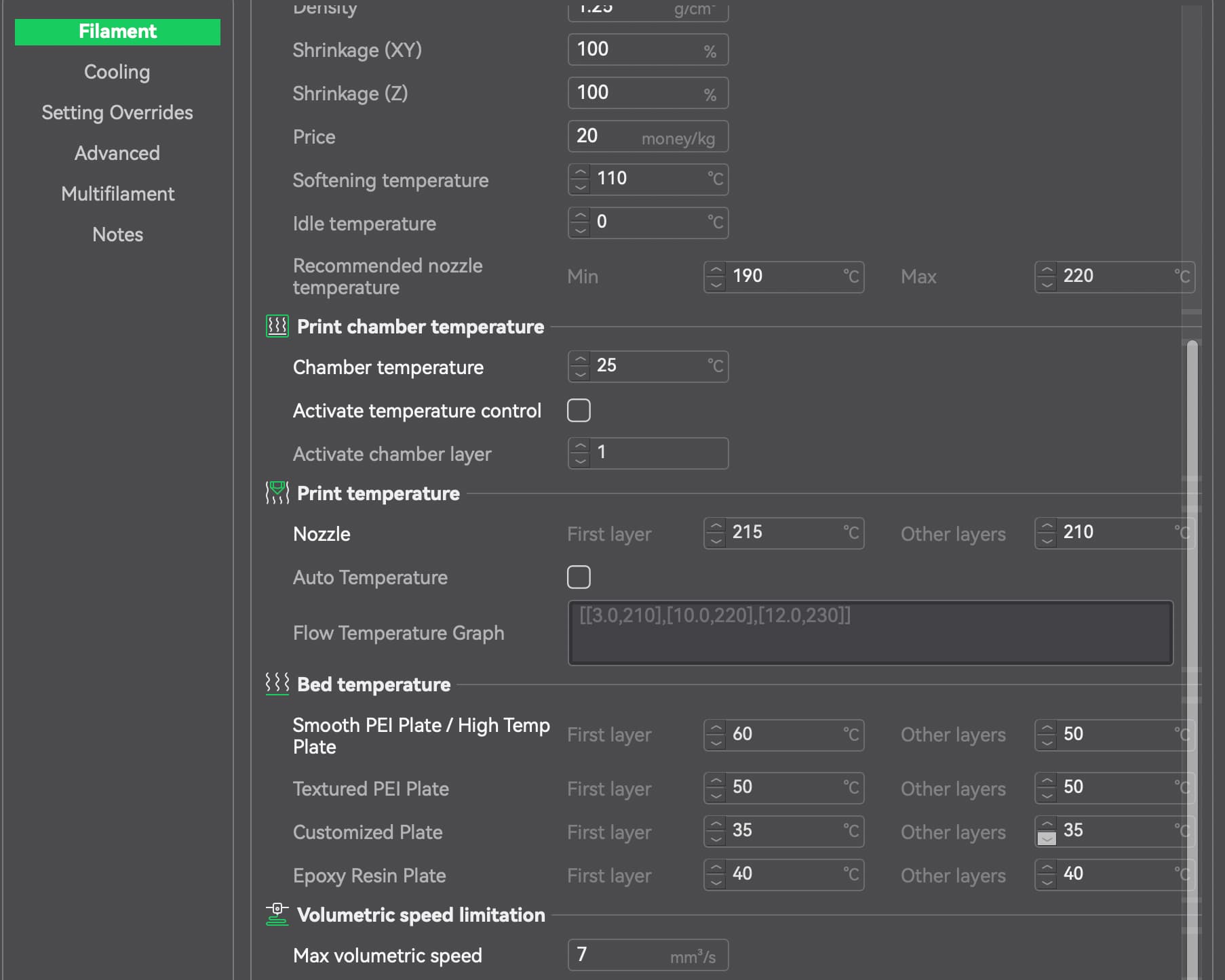

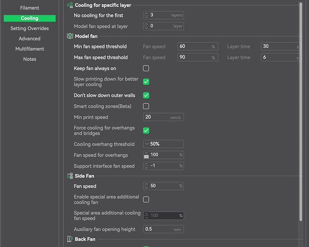

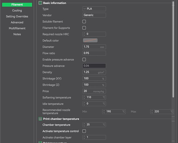

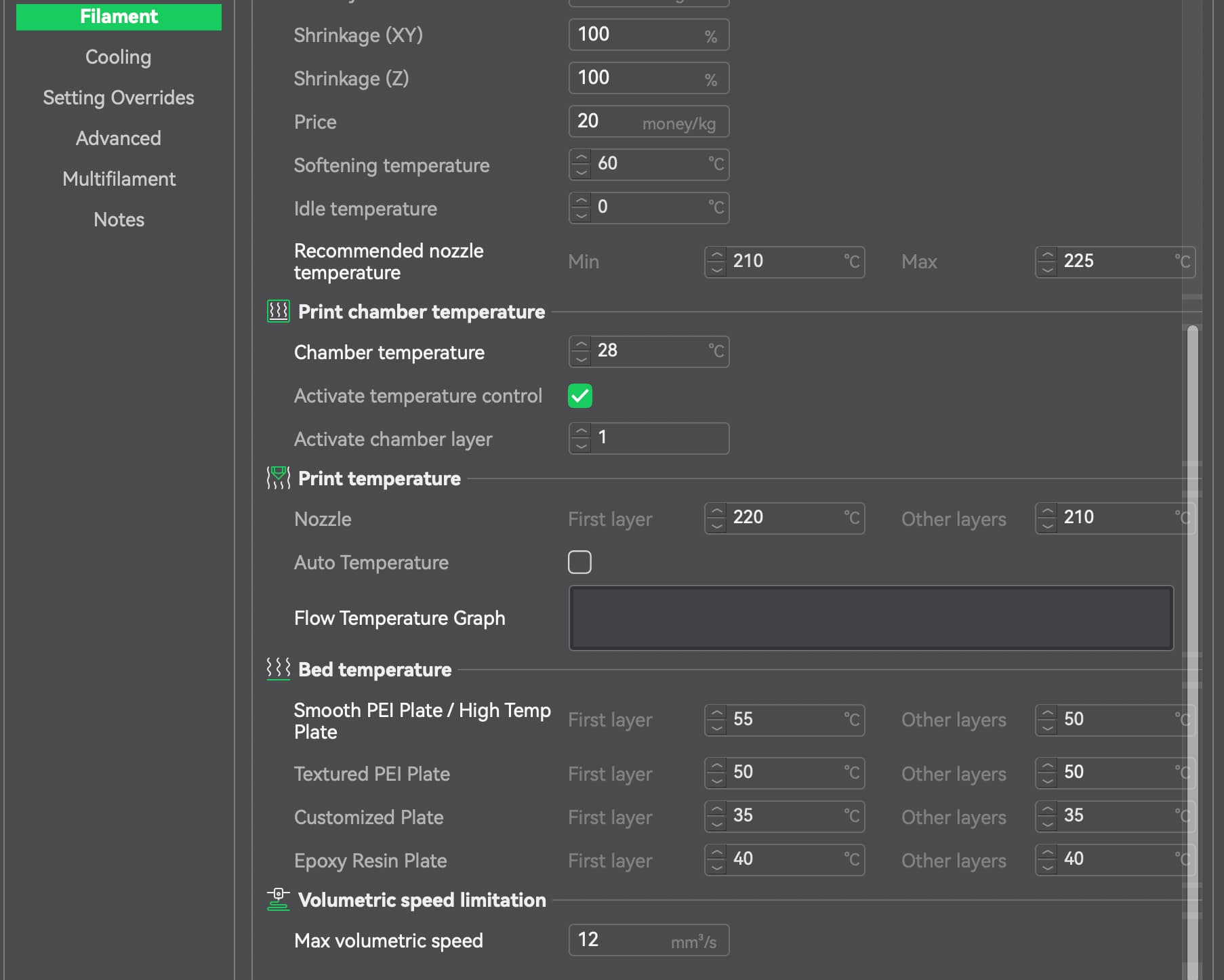

Hyper PLA Updated Profile settings:
Filament:
Cooling (Hyper PLA)
Settings overrides (Hyper PLA)
PRINT SETTINGS in Creality Print software (Hyper PLA):
  • First layer: 20mm/s
  • Outer wall: 45mm/s
  • Inner wall: 130mm/s
  • Sparse infill: 120mm/s
  • Internal solid infill: 120mm/s
  • Top surface: 90mm/s
  • Gap infill: 120mm/s
  • Support: 120mm/s

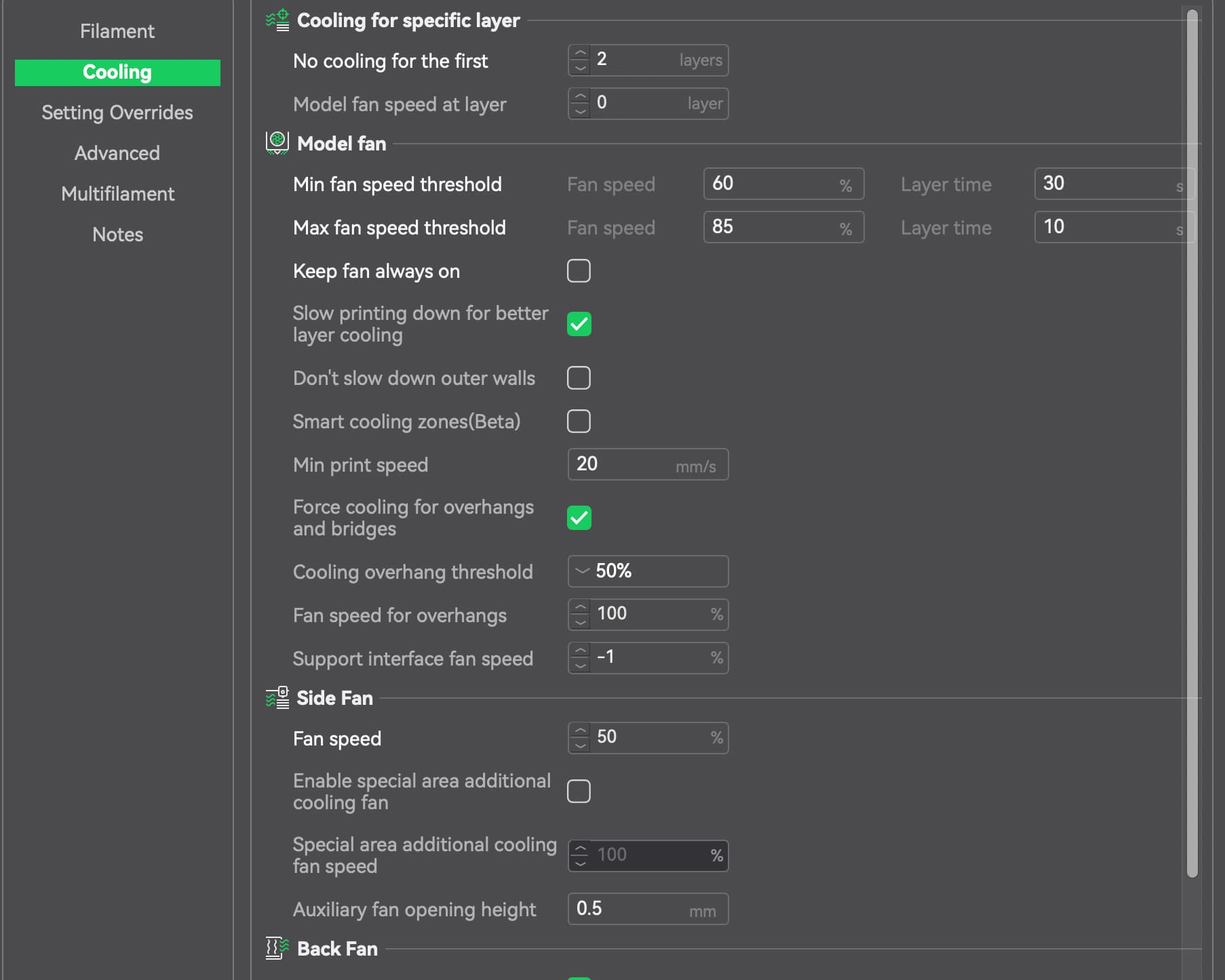

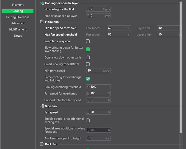

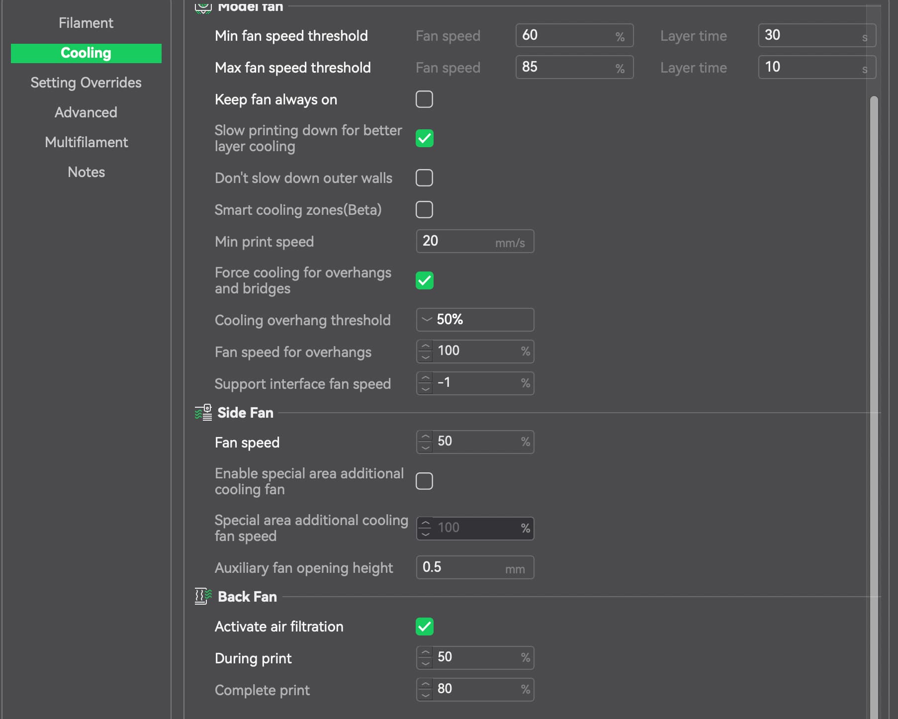

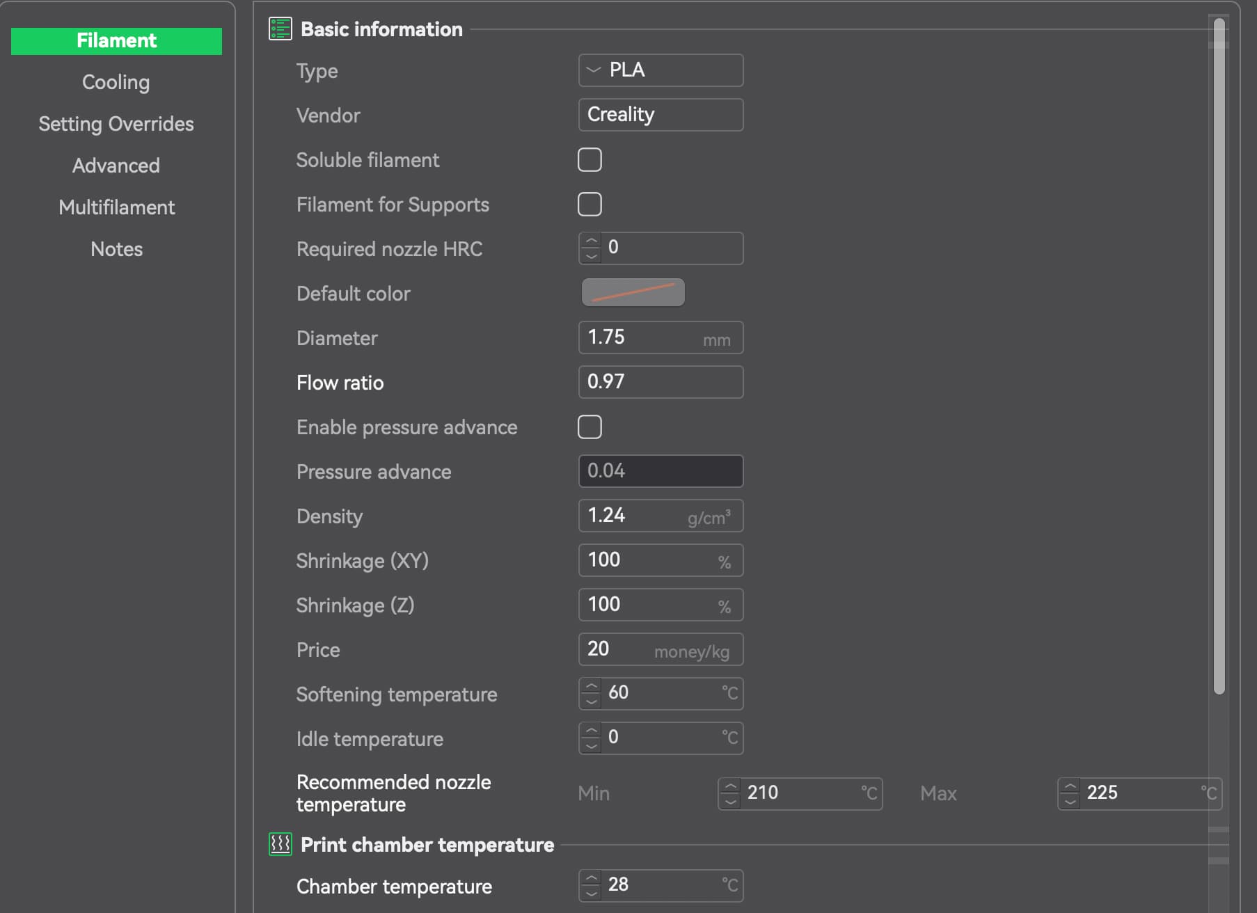

Overture PLA updated profile
Filament:
Cooling (Overture PLA):
Setting Overrides (Overture PLA):
Overture PLA settings in Creality Print software:
  • First layer infill: 40mm/s
  • Outter wall: 40mm/s
  • Inner wall: 40mm/s
  • Sparse infill: 110mm/s
  • Internal solid infill: 110mm/s
  • Gap infill: 100mm/s
  • Support: 100mm/s
  • Support interface: 70mm/s
