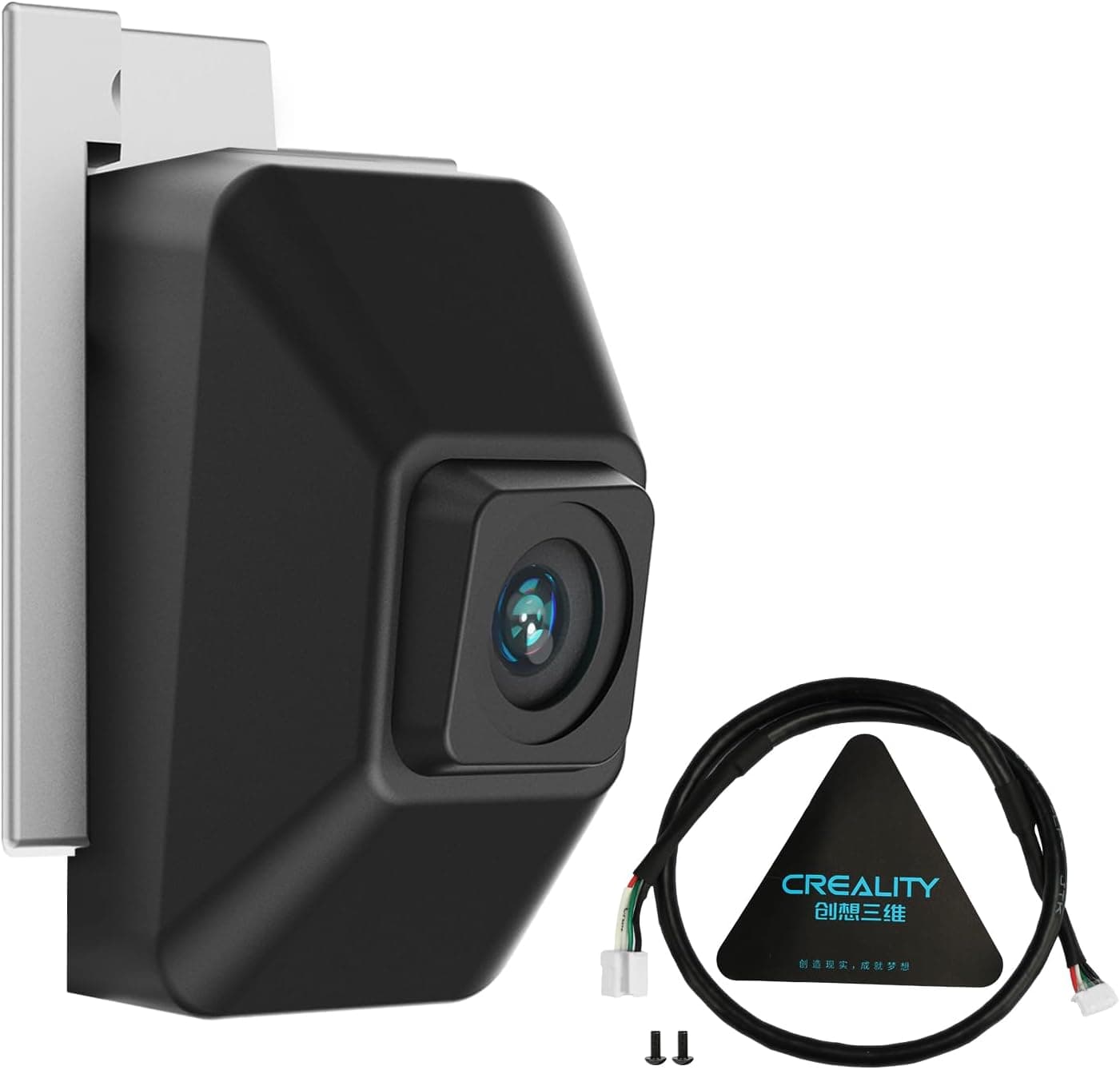

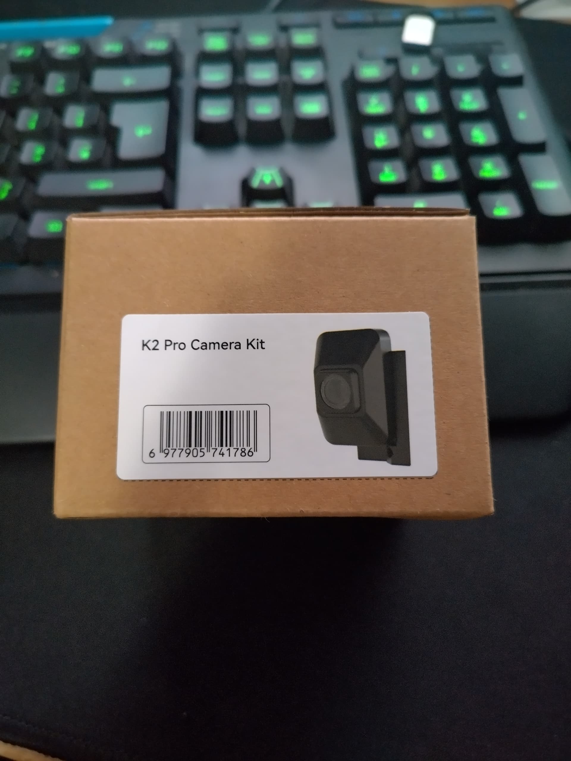

I got this camera directly from Creality when i got the K2 - Chamber AI Camera for K2/K2 Pro
As you can see there is zero information on this camera on Creality’s site.
I did contact Creality via the online chat to explain this situation and request a return and refund, the response was it needs to be sorted via email and they gave me a ticket number and that was it. I have not received an email as of yet, So I doubt it go anywhere with them.

Pics of the camera box.
Oh yea, must be an upgrade ‘cause mine didn’t come with fog lamps! :rofl:

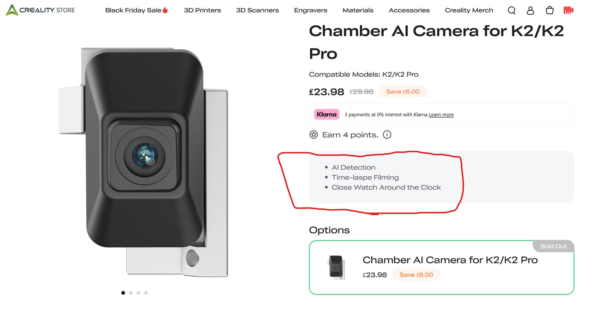

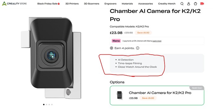

The page for the camera on Creality’s website - Chamber AI Camera for K2/K2 Pro
there is even a typo on the 3 lines of info they have for the camera.
For now, I highly recommend that people avoid buying the Chamber AI Camera “accessory” until we can get clear information as to if it is a “accessory” upgrade or just a spare part.
When I have further information I will post here. whatever the outcome.
Hope this helps.
Decoy
EDIT: Also note the three feature points listed of the camera (red outline). The Camera that the K2 comes with does this already.

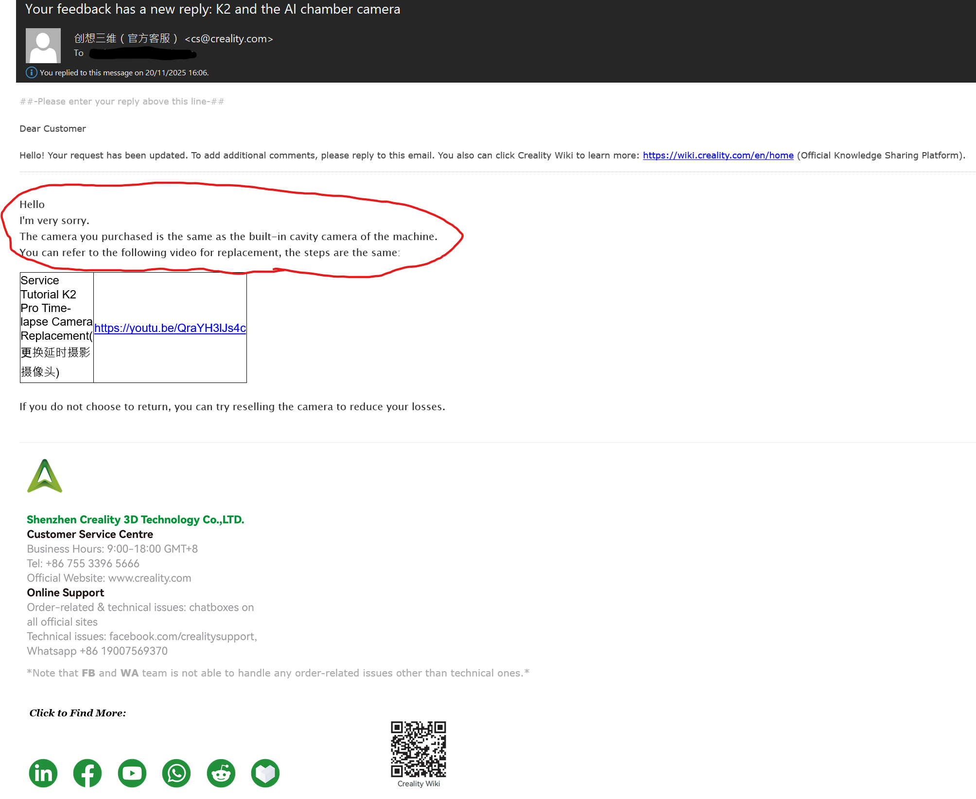

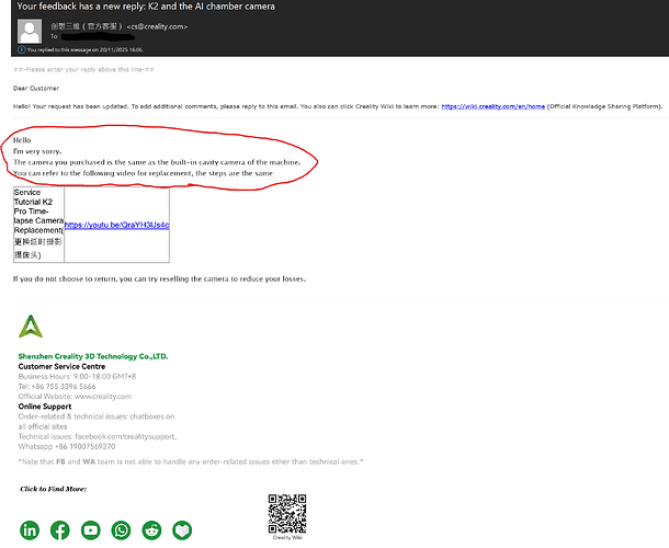

UPDATE:
Creality finally answered my questions about the Spec of the Chamber AI Camera found in the Accessory section on the Creality UK shop.
This is the response I got from them.
(hers the link in that email if anyone needs or is interested to see https://youtu.be/QraYH3lJs4c)
So, my suspicions were correct - this is a spare part and NOT a accessory.
That means it is being Miss-sold and miss-represented (in the UK)
I have returned it for a refund.

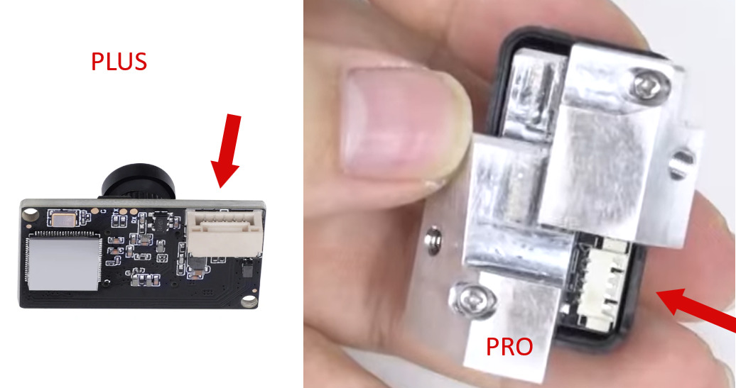

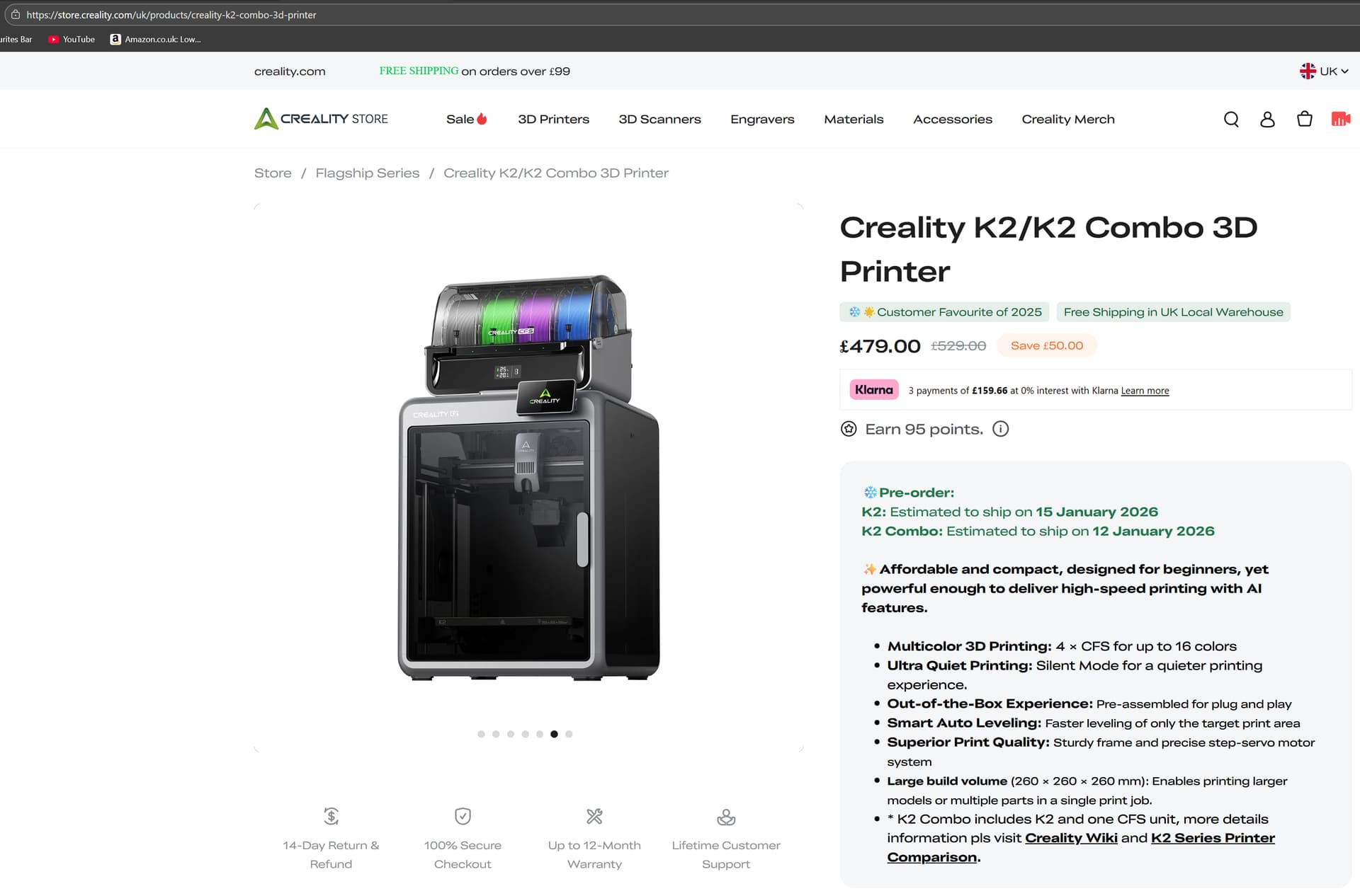

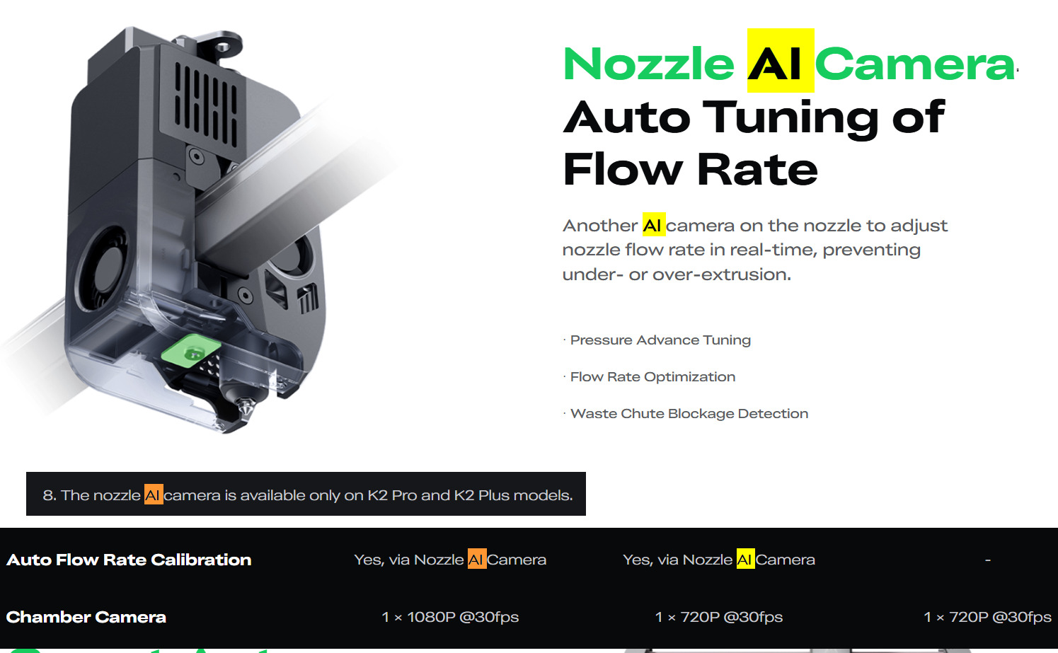

On the K2 comparison sheet on Creality’s website (K2 Pro Combo | K2 Series 3D Printers - Creality) it specifies the cameras on the K2 and K2 pro are 720p

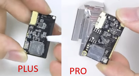

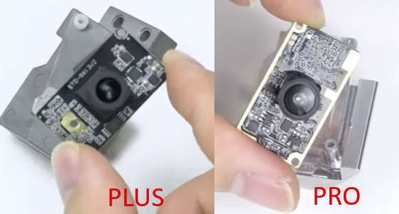

Interestingly the camera on the K2 Plus is 1080. I looked at the replacement vid for the K2 Plus and its a different fitting to the K2 / K2 Pro. Link if anyones interested.. Replace K2 Plus Chamber AI Camera | Creality Wiki
Note the camera on the K2 plus comes as a PCB the Camera on the K2 /K2 pro comes with a plastic shroud and attached to a metal bracket. I can also confirm the PCBs are different between these two types of camera.
((side note / random thought – if you could fit the K2 Plus camera into the K2/K2 pro would it then work at 1080 or is it limited in the printers firmware…..))
