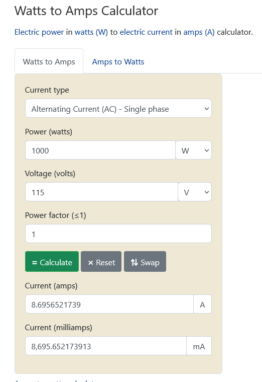

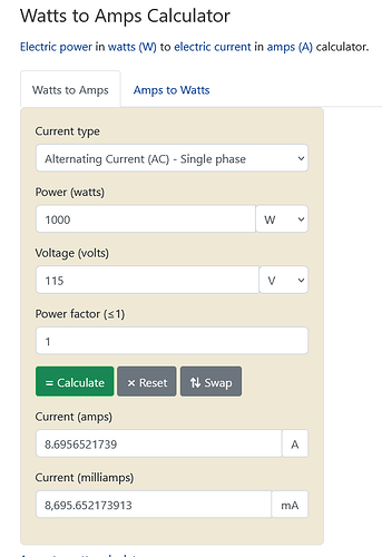

I assume we are referring to US 115 volts AC and power factor of 1 ?
That is 8.7 Amps … a long way to go yet unless there are 2 printers doing the same thing at the same time, or, making a coffee maybe. ?
cheers.
I tried to help.

That is the thing we all need here and it is good that you do help !
I have probably not the best way of going about things, it is just that if I see something different to what I think is likely, then I show why I think so.
As it is, you could quite possibly be right. It would be interesting to find others with the same problem and see how their printer is located within their power distribution.
Cheers.
