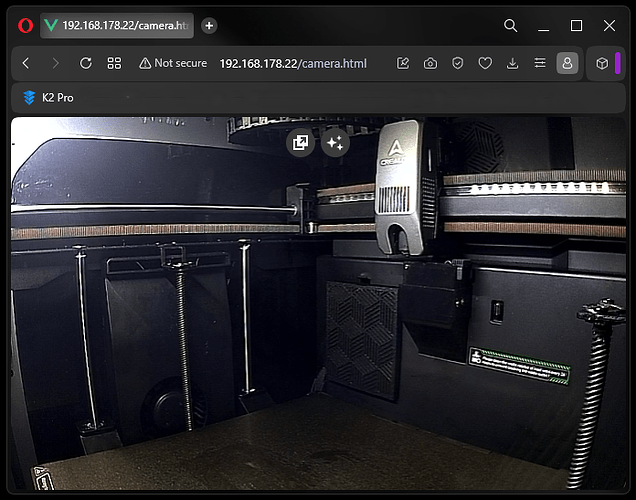

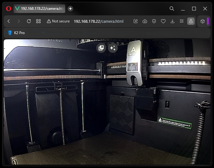

I endorse this product. Thanks for the code.
For me the
  • http:// your-ip/camera.html
works fine (Firmware V1.1.5.5)
H37Z3US
it is little slow to start streaming about 1 minute delay, but it works, however can you add functional “enter” key, and history so we can choose already entered ip’s from input dropdown.
