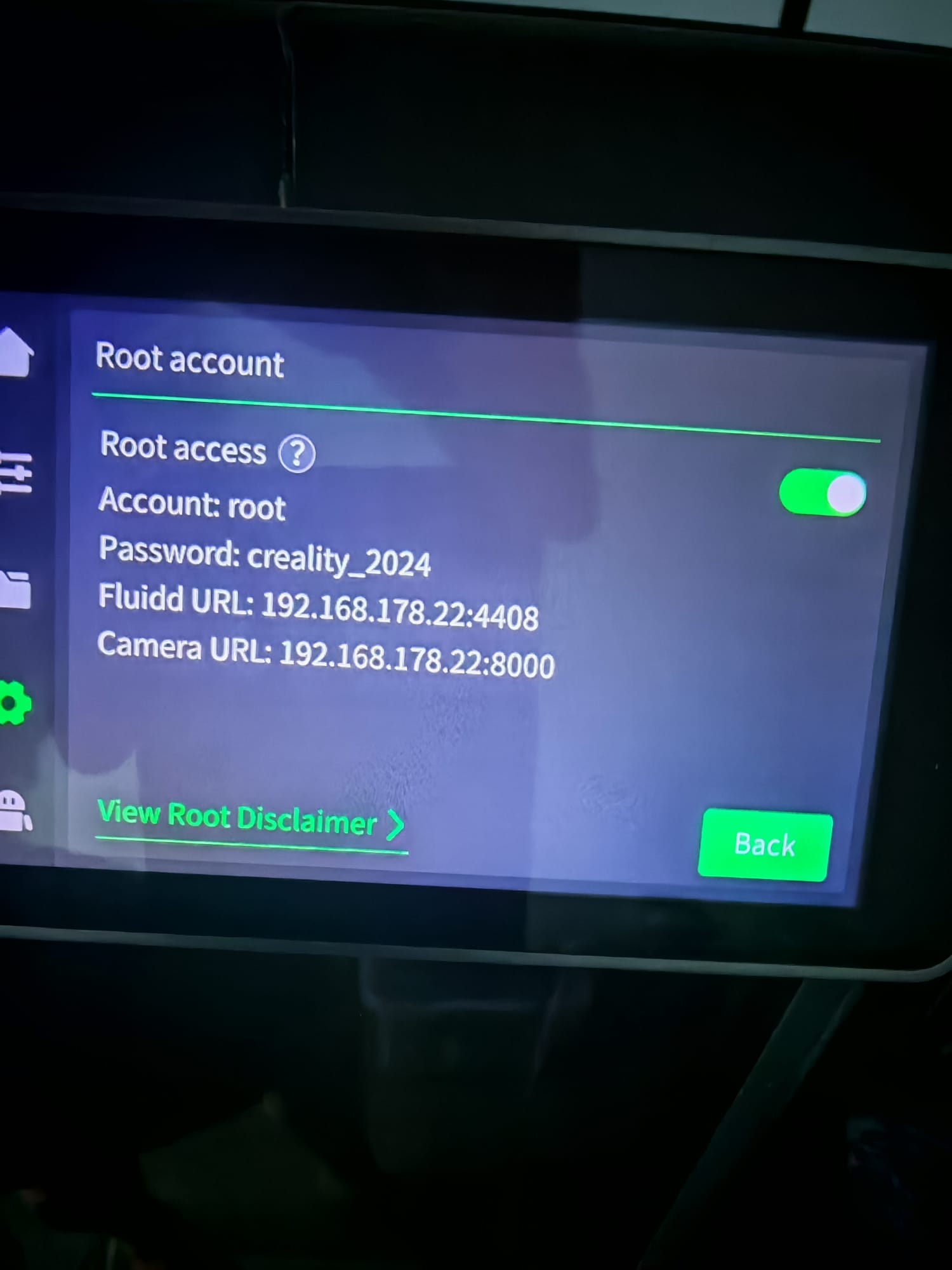

Don’t know how to respond to this. This is totally unacceptable.
They close the port but the port info is still in K2 Root menu. Well done…:blush:
Yes indeed. They are also actively advertising this feature of the K2 plus on their website.
