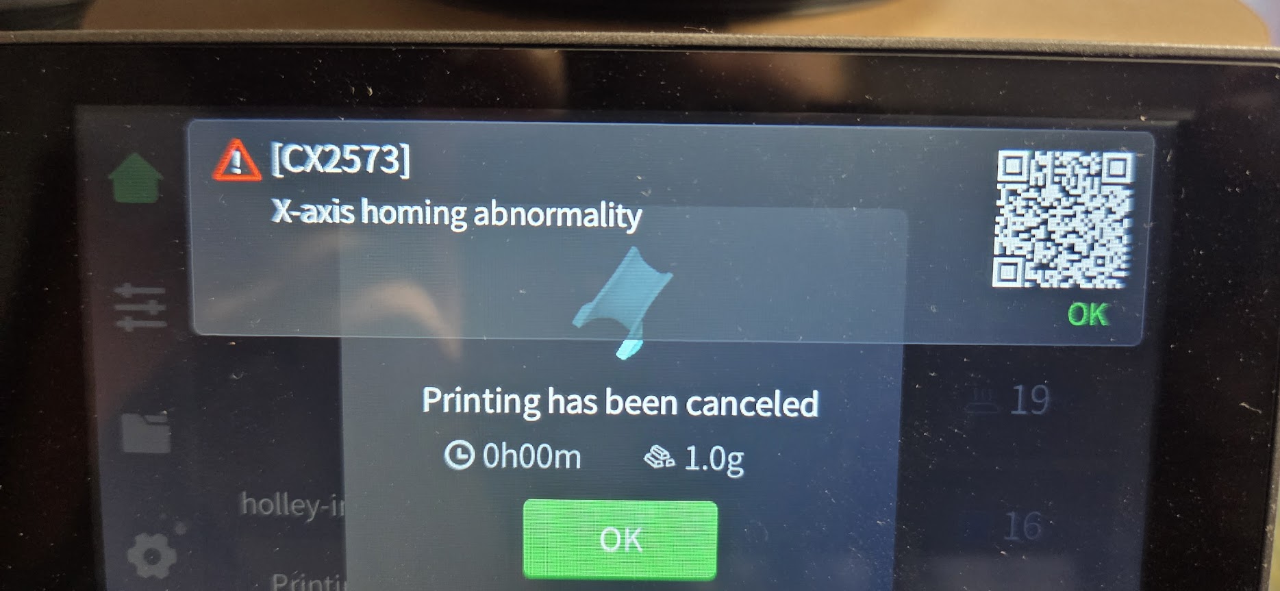

I’m not exactly certain what’s going on with my K2 Plus. I can slice and upload a file to it just fine from orca, and as long as I use the actual K2 screen to select/print the file, it prints without any problem.
However, if I try to upload/print in one move, or upload the file, and try to tell it to print when it’s there, I get an error of:
10:26:18 !! {“code”:“key22”, “msg”:“No trigger on x after full movement”, “values”: [“x”]} along with the error on the screen I’ve attached.
The printhead will bash around and lose it’s position requiring a reboot of the printer to be able to use it once more. This happens either under fluidd or under orcaslicer. The same file if uploaded to the printer and selected from the screen on the K2 to print, prints fine without any drama.
Same problem here. It comes after updating to the ne last Firmware upgrade. Before i never had this Problem. It´s sound like hard blocking during homing… hope they fix it soon.
Another finding. I uploaded another print that I have sliced to the printer. This time, instead of kicking off the print from Orca or Fluidd, I used crealitycloud.com workbench to start the print and it’s started without any drama.
