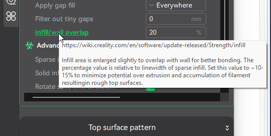

My “blob of death” issues all went away when I switched out the included PEI plate with a new one from Amazon (under $20). It seemed that the original PEI wasn’t anchoring the object properly, Once it moved even a bit, the nozzle caught and started the blob.
I went thru that stage but it was caused by the software infill / wall overlap defaulting to 30 by Creality design even though their own highlight notes 15 should be the default. (Bambu has 15)
At 30 it caused the nozzle to bulldoze the filament thereby pushing the item over.
Changed to 15 and it never happened again.
AND they still have not changed it to default to 15
@Lu_Zhang
Yes I know it says 20, just testing :slight_smile:
“infill/wall overlap” 30
wonder if this is the reason the default creality petg profile is so bad??
