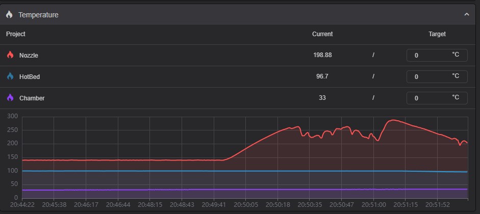

I’ve been using my K2 Plus for a few months now and hadn’t had any issues until about 3 weeks ago. I started getting occasional “Nozzle not heating as expected” failures, then they started happening more often. I can rarely get a print to work now.
Printing in ABS, nozzle @ 240, bed @ 100, chamber @ 60
I’ve tried nozzle PID calibration a number of times - I thought a new heater in my printing room was causing issues, but have worked out that is probably not the issue.
I’ve tried checking, tightening plug connections on the thermistor and the heater, they seem nice and tight. No damage to the circuit board either.
I’ve tried using previous firmware (1.1.2.10) in case it was a software issue but it has very similar problems to the latest firmware (1.1.3.13).

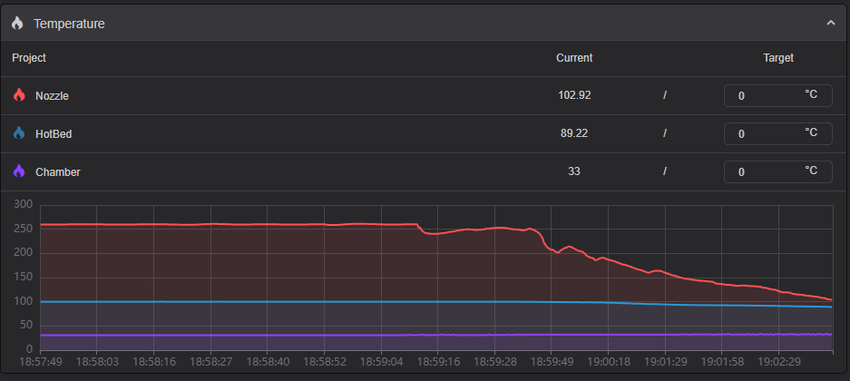

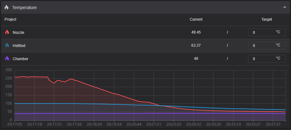

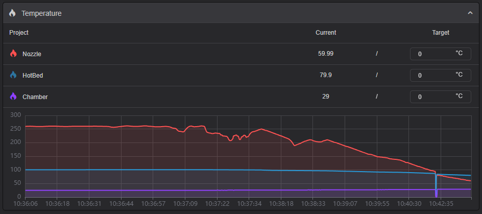

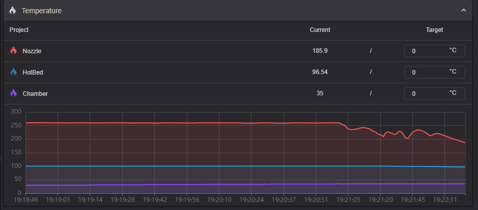

The failures seem to happen after the chamber heater tries to increase temperature. I’ve managed to get some prints to not fail by turning the chamber heating off.
Since this is an issue that has suddenly appeared and is getting worse, I am guessing that it is a hardware failure somewhere, but I’d like to nail it down before trying replacement parts. The printer is still quite new, so its a bit disappointing that I’m having problems so early on. Any help would be appreciated.

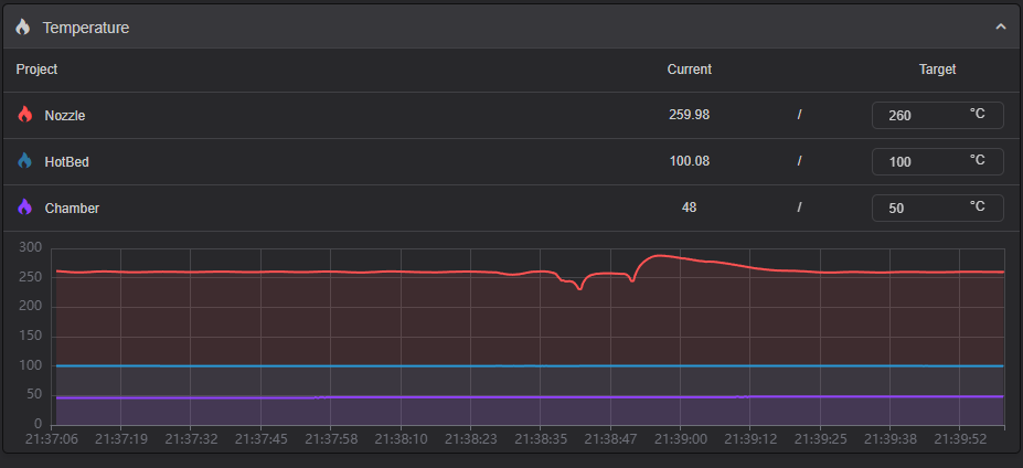

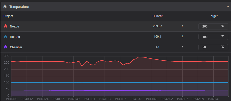

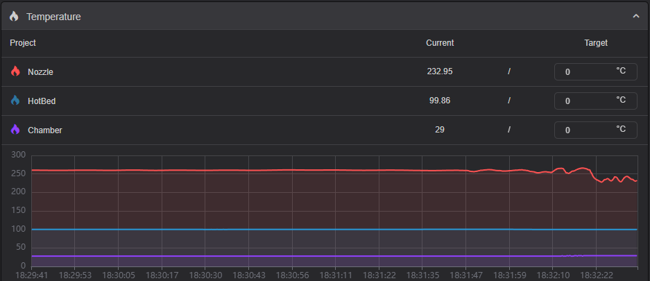

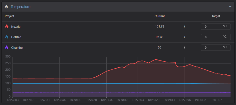

Below are some temp graphs of some of the failed prints if that helps:

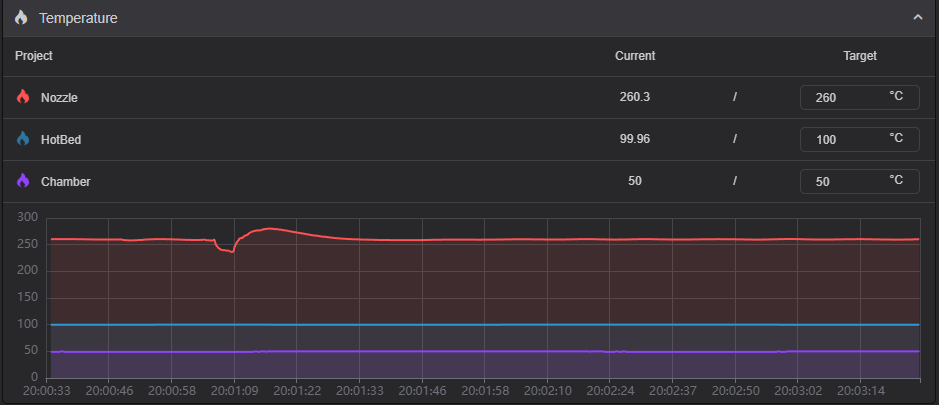

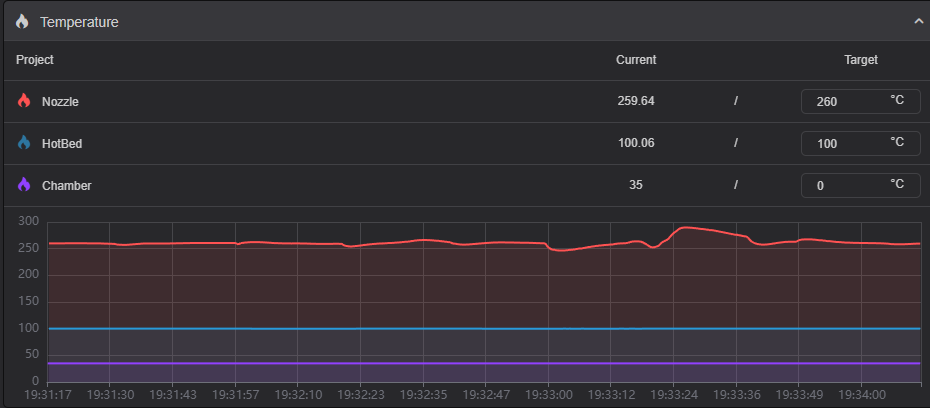

There was also some nozzle temp “wiggling” without the print failing:
Hi, your hot-end likely needs to be rebuilt.

Just thinking about your reasoning about the heat sink paste being the issue.
If the heat sink paste has gone to crap, more heat is needed to get the nozzle to and hold temperature, so when the chamber heater kicks in, the power supply might not have enough power since the nozzle is using more than it should.

UPDATE
Took hotend off the printer, dismantled it, removed all the previous heat paste, put new heat paste on and reassembled.
Tested using same settings as before that was causing failures, printed two small prints before it failed again with same error.
Performed a PID calibration since I forgot to do it after rebuild.
Tested again with small print and same settings. Had a bit of a hotend temperture wiggle, but 6min print finished.
Print 50min successful.
Print failed before starting to print – nozzle not heating as expected.
Replaced hotend with a new one.
Performed PID calibration.
Print 40min successful.
Print 2hour successful.
More testing will see if problem is solved, but I’m cautiously optimistic that a new hotend has fixed my problem.

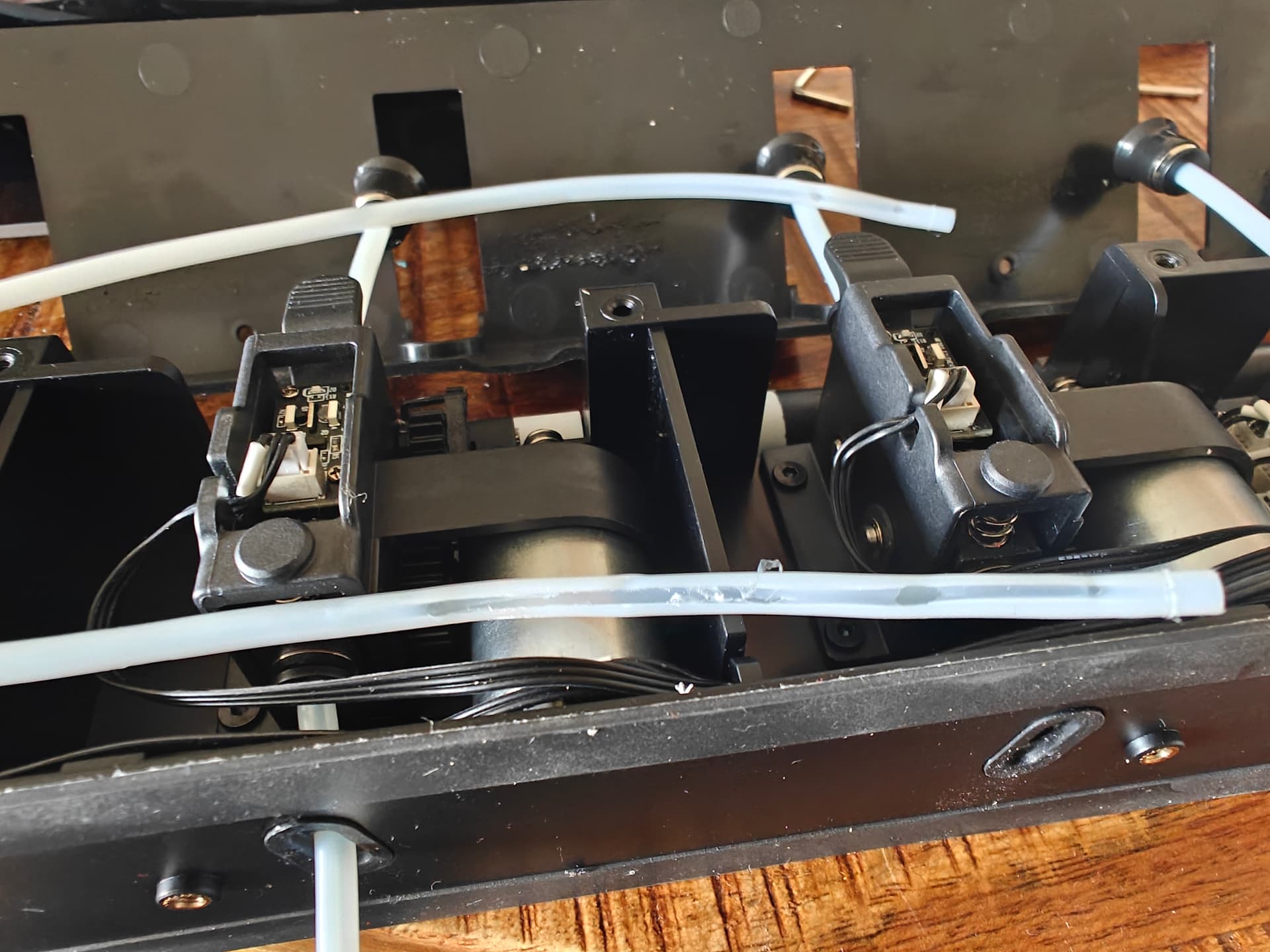

Its like the Devil play with it. Last couple of days printing abs get the same problem. It was the thermal pasta it was powder when i removed the nozzle. Have renewed it and that problem solved. Now i got the retraction problems again have replaced for the third time the 4 way hub under the cfs. the hub begins to eat the fillament and then the tubes tears. The last 4way hub had i installed some extra washers under the spring it held out couple of hours think 150. I did that because i got retraction errors. Dont know what the problem is anymore for me the hub can print like 500 hours without big problems then it start al again.
