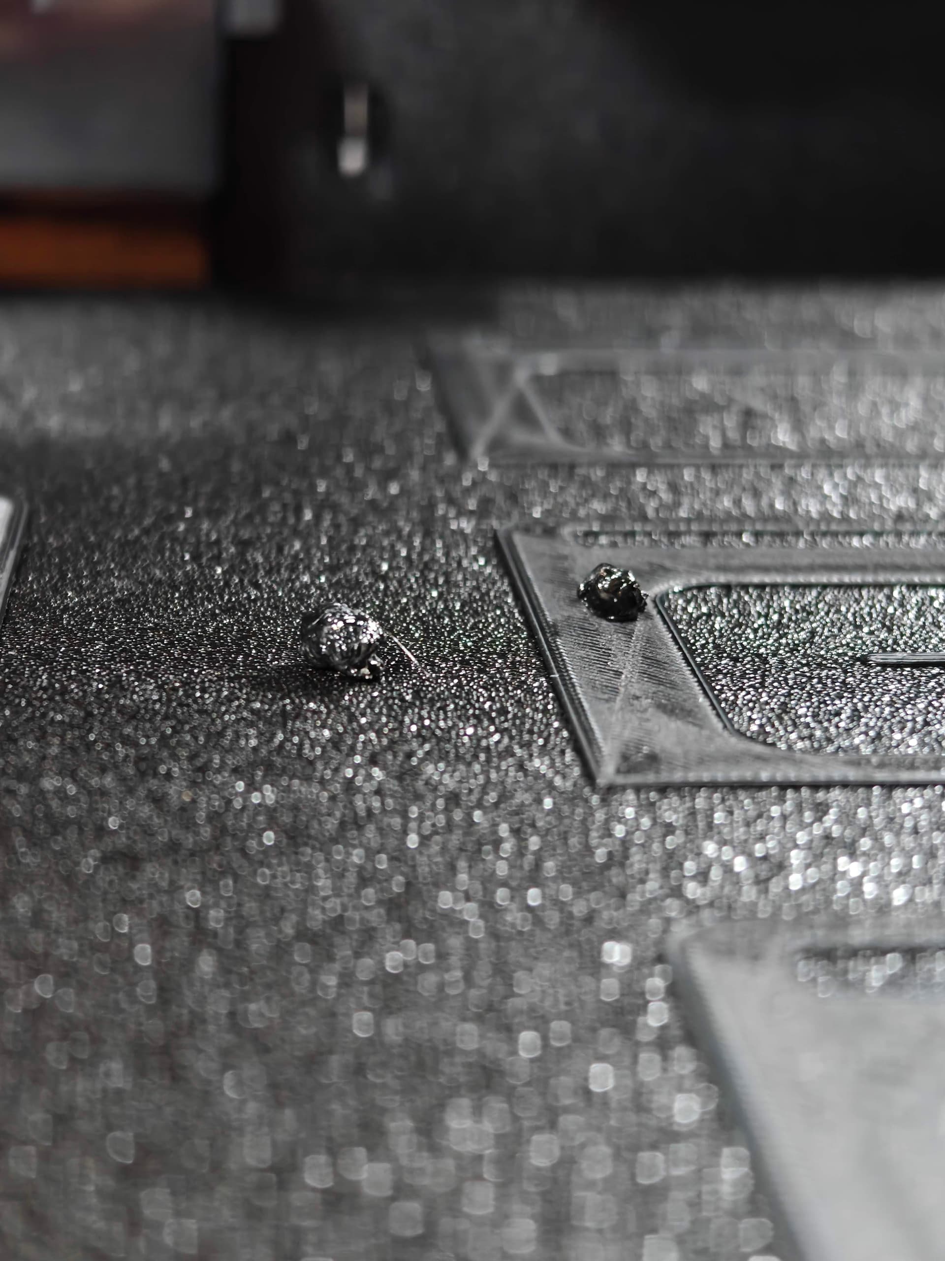

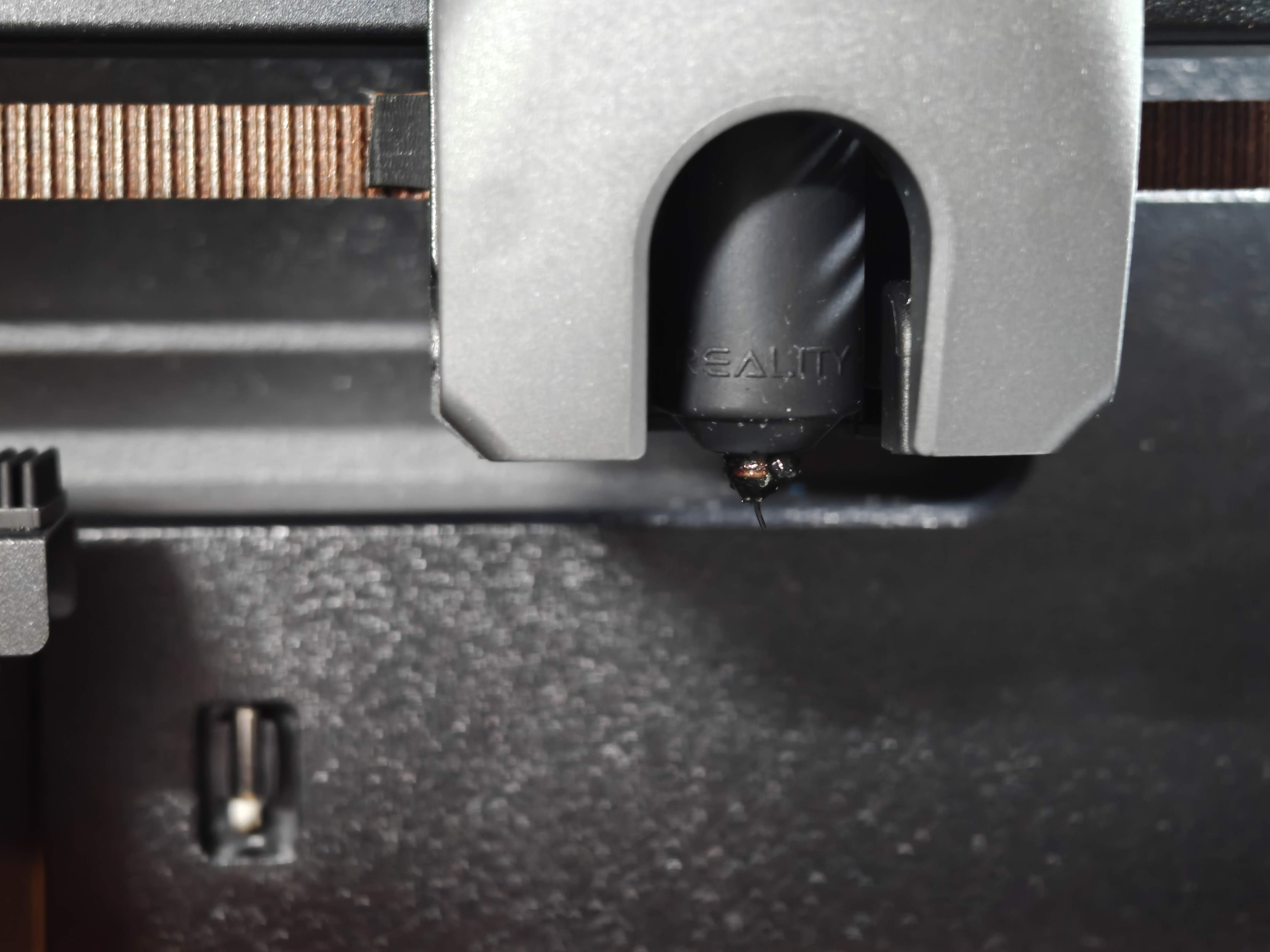

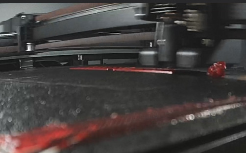

We recently got a K2 Plus with CFS just for printing functional parts out of black PETG. I’ve had several issues getting the system to print well including extruder jams, poor dimensional accuracy, print to print precision, and calibration issues. I’ve been able to solve all the above issues (mostly by switching filaments and doing extensive testing and calibration), but I have one remaining I cannot seem to solve: nozzle buildup leading to clumps of PETG shedding onto the build plate. If these clumps happen to fall on the prints, they often will bond enough and the print be ruined. The PETG on the nozzle also adheres to new layers while printing, messing up dimensional accuracy and print quality.

From what I can tell, this buildup seems to occur on layers 2-5. There is no build up after layer 1, and I’ll often pause after layer 5ish to clean the nozzle and any chunks (sometimes there are chunks, sometimes not, even if it’s the same item being printed. It’s weirdly inconsistent). If I do that, the print usually comes out great with minimal buildup after that.
I know PETG is sticky and there are non-stick treatments for nozzles and such, but I’d prefer not to go down that road, as that seems to be sidestepping the real issue. I print these same parts with my BL A1 with the same filament and similar settings, and I’ve never had any nozzle build up, ever.
