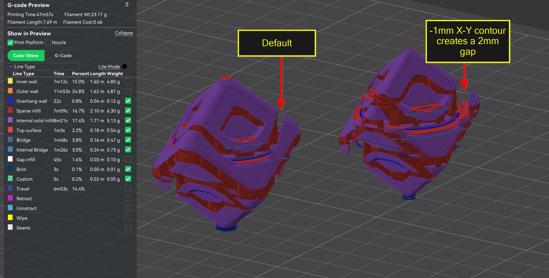

It’s actually a trial-and-error approach, but assuming you have mastered supports, organic works better for this type of shape. You’ll want to start with X-Y contour gaps at a negative number. Here’s the parameter.
What this will do is make the outer portion of each segment smaller by 1 mm. This will allow you to control the gap between the two pieces you want to have moving.
The 1 mm value in this example is extreme, but I am using that for illustration purposes. I turned off the display of the inner and outer walls so that the inside is more visible.
One thing that is important is that at a 45-degree angle in this example, the slicer will produce no supports using the default setting. But you may have to either force supports or create an unusually large brim so that the block stays at the tipping point of 45 degrees. The challenge then will be that the nozzle, at default speeds, will likely knock over the model and it will detach from the build plate. So I recommend that once the print has started, go into the Device menu and slow it down to 50%, which will give you better odds of not knocking over the model. Again, this is trial and error.

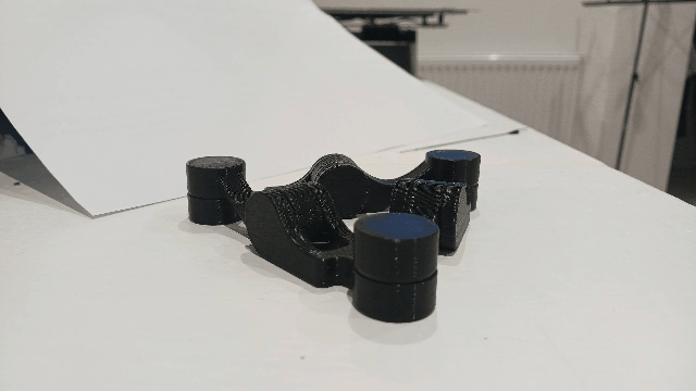

Of all the print-in-place fidget toys, the kaleidoscope fidget is likely the easiest to master, and you can use both X-Y contour and X-Y hole to adjust it. X-Y hole makes the axles smaller.

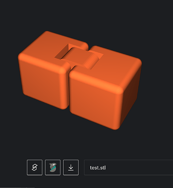

For that, if you want to save filament, start with just a two-segment cube until you get the X-Y contour not too loose and not too tight. Once you find the Goldilocks zone, then print out the entire 8-segment model.
