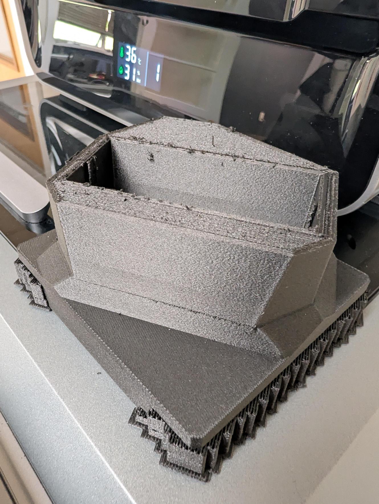

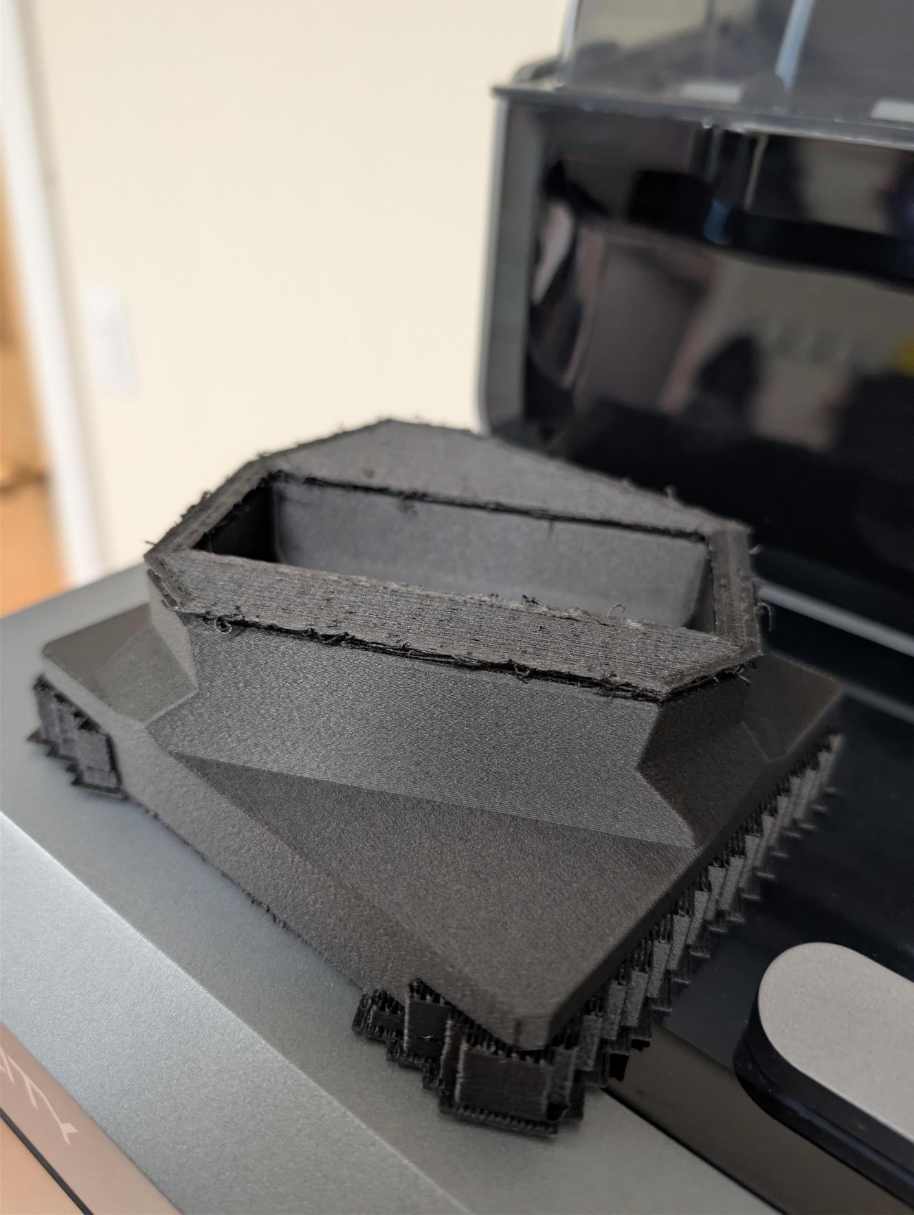

Below, you can see two previously failed parts. These were mostly okay up until the clog point, with a little evidence of under extrusion.

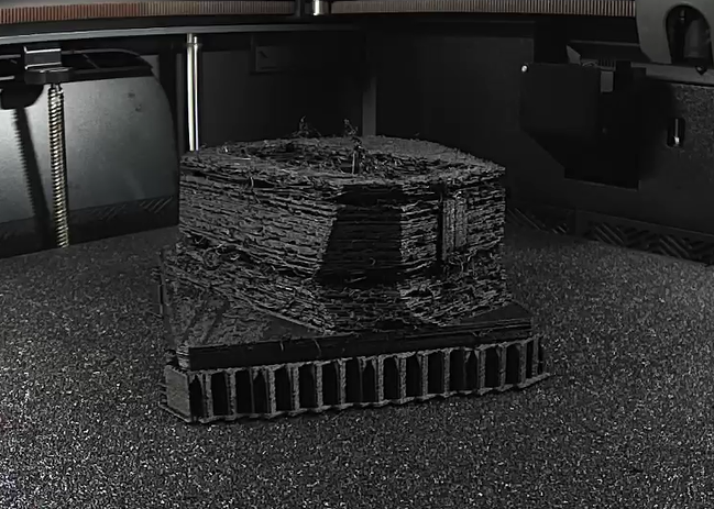

Below, you can specifically see the most recent failure, which seems to have severely under extruded for a good chunk of time before eventually clogging.

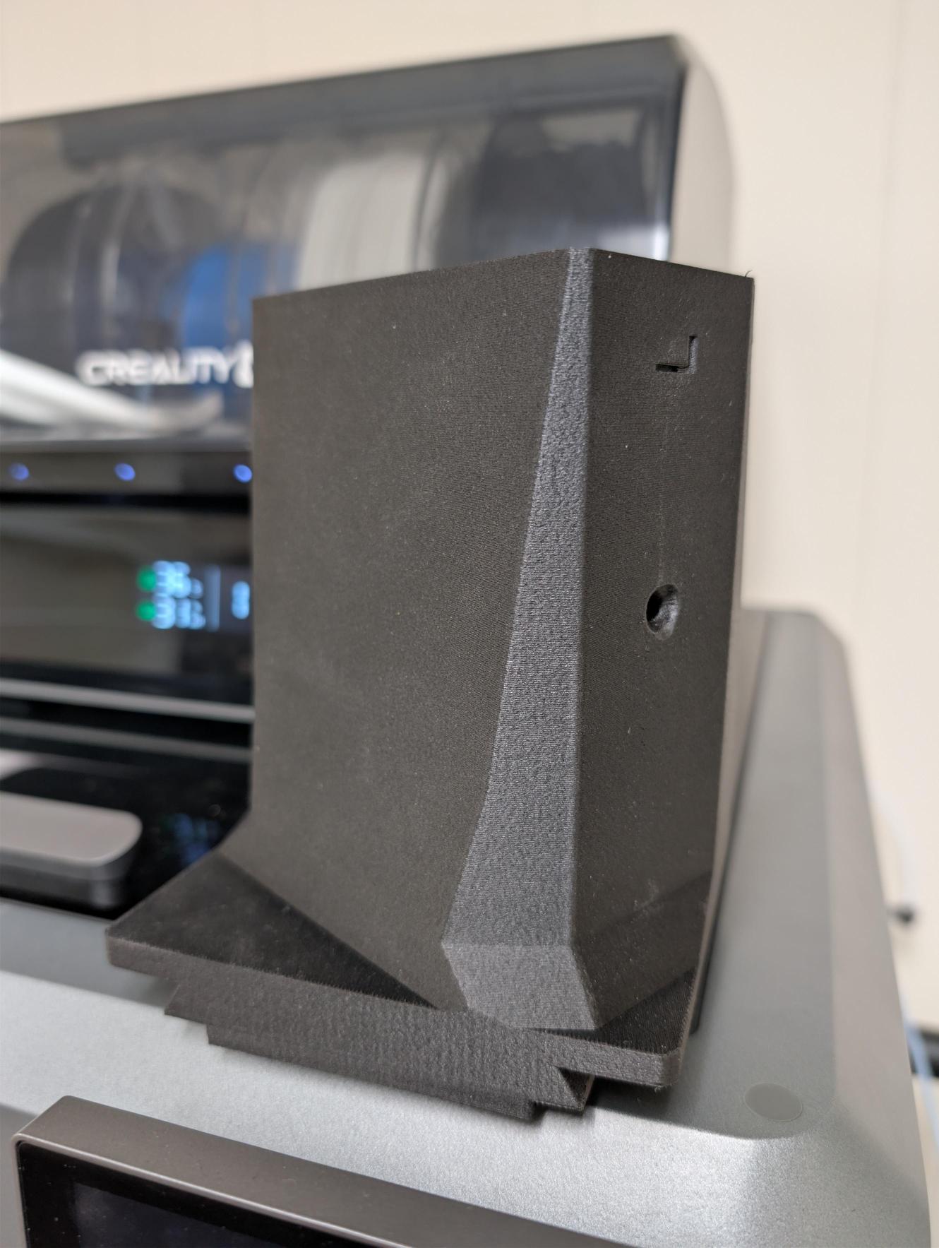

And here, you can see the same part (mirrored, though) that I printed successfully. In my non-expert opinion, I’d say my settings must be dialed in pretty well because it came out really good.
