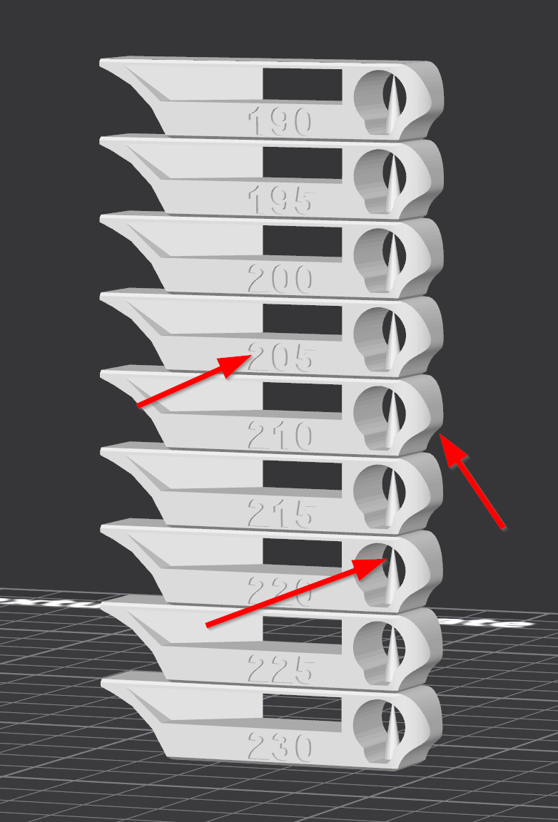

This is one of the few cases where a temperature tower is genuinely useful. If you are willing to print one, post:
  • Two photos of the printed tower
  • One screenshot of the sliced model showing the temperature transitions
I’d be happy to help you analyze the visual data and offer up what the optimal temp for that filament should be. Don’t be surprised if you find that for less string, one temp is optimal, while for tighter overhangs, another temp is optimal. I’ve often had to set up more than one filament profile for the same filament to achieve optimal results depending on the print I was trying to accomplish (i.e. accurate parts vs visually appealing).

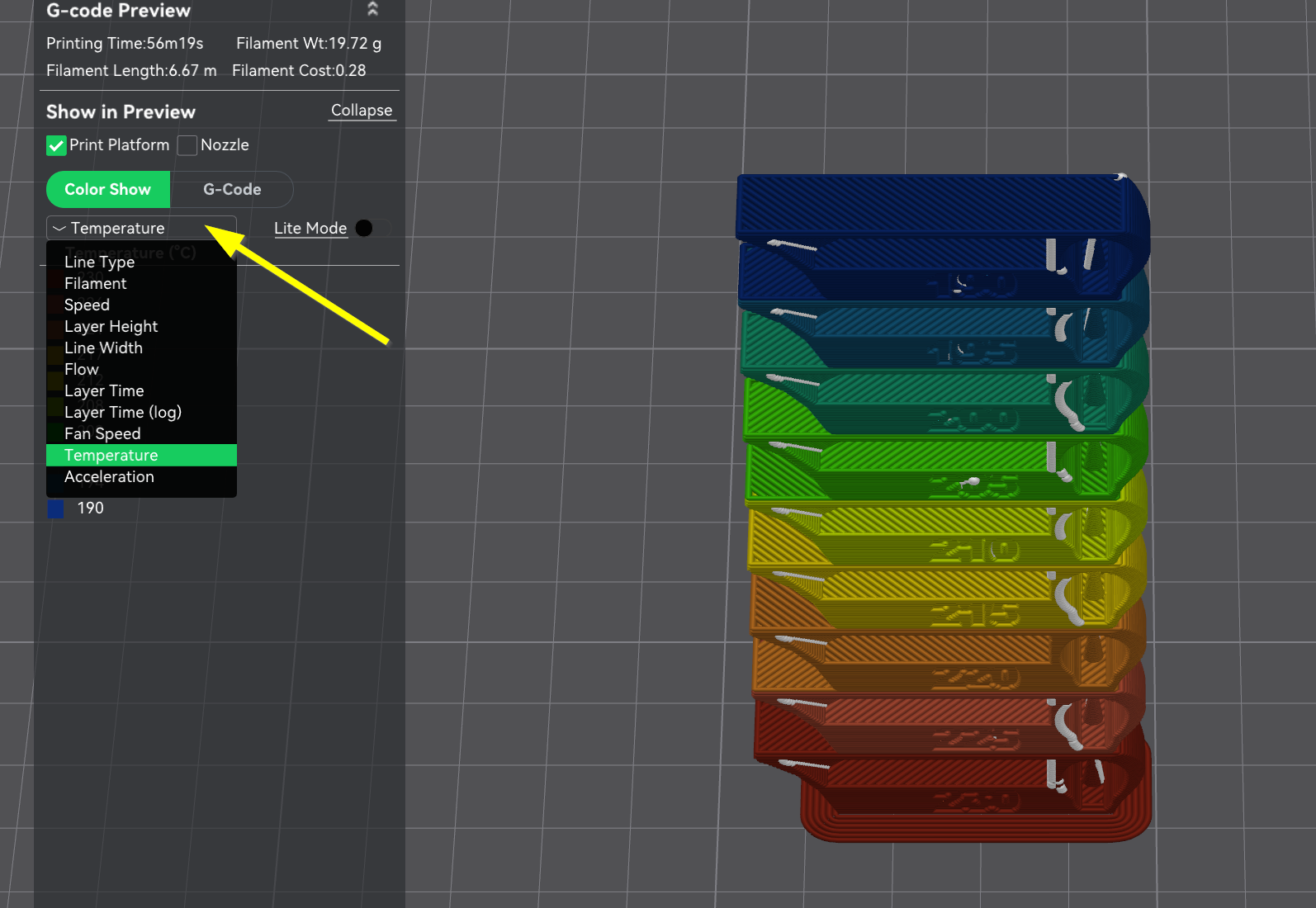

If the sliced model does not show the expected rainbow temperature bands, you are either using the wrong model or the G-code was regenerated incorrectly.
Photography guidance
Take photos from farther away and use digital zoom to minimize parallax.

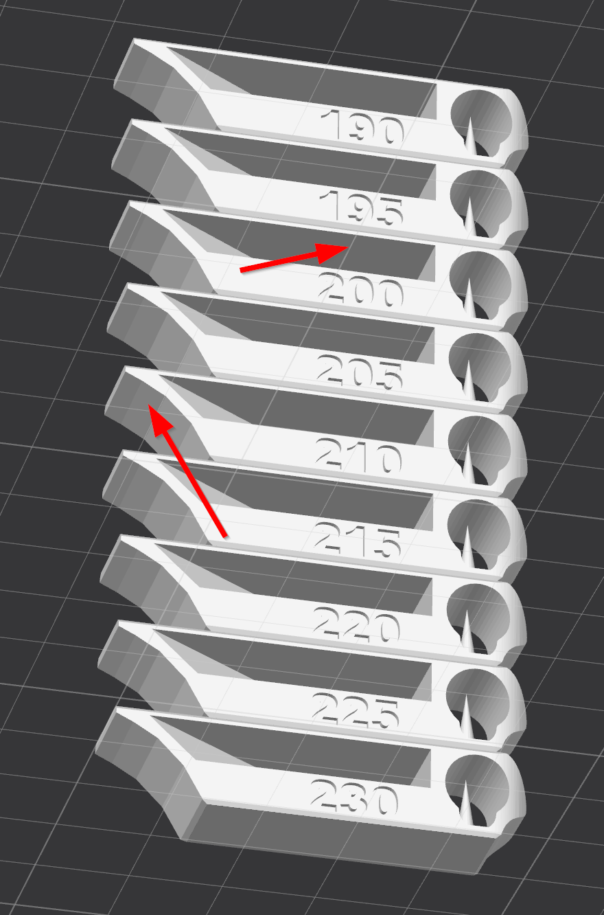

Orientation 1: Upright view showing lettering, backside edges, and spires.
Orientation 2: Model upside down on a flat surface to show overhang behavior from below.
Before printing, verify the sliced preview shows clear temperature segmentation:

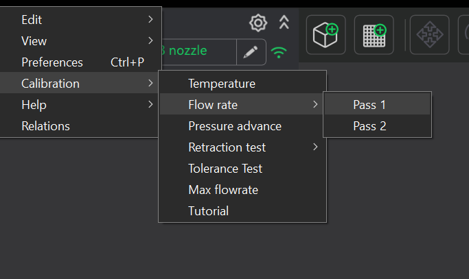

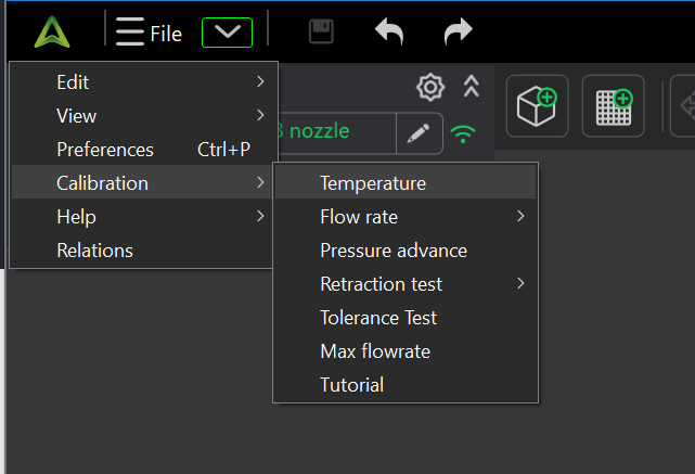

Flow calibration
After selecting an optimal temperature (this is inherently subjective), perform flow-rate calibration. Pass 1 is usually sufficient. Pass 2 can provide incremental improvement but often yields diminishing returns.
