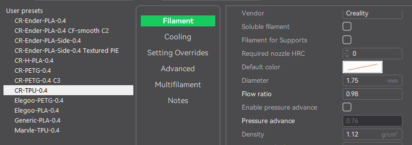

When you print filaments that are not the 3 defaults CR has settings for, (or even sometimes with the brands to fine tune)..
when you run PA & Flow calibration, it populates the details of what it did those 2 tests results, into both the console & dashboard of fluidd… But it doesn’t save them for reuse.
i.e.
(its easier to see the results in the dashboard than going to the console)

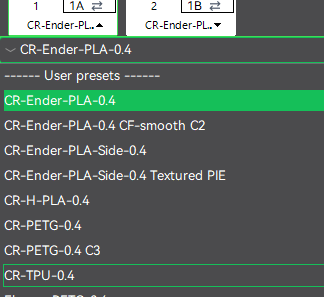

you take these settings and edit the system filament setting (generic or CR, whatever TPU you are printing) & update the values in here, then save a “user” profile.. next time you print using this saved profile, you a) don’t have to run calibration to get the same values used, b) save filament & time.
(you can choose to use PA or not depending on if you increate speeds from slow TPU printing or not)
running calibration gets you the numbers you need for a custom profile, creating a custom profile gets you consistent printing at “good” flow & PA ( if PA used) values.
it also shows that your setup “can” print TPU at the lowest speeds..
once you have this, you can run a print speed calibration tower, or just increate via fluidd until you see negative effects during a print), to know what max volumetric flow to set in the custom profile. this gives you “slice - send to printer - walk away - it will work values”.. that should you want to you can increase speed of during print for faster prints if the objects / layers are simple geometries (up to the max speed test values)..
these are the basic steps, to deterime how fast you can consistently print (for any filament type), so that you buy more filaments (same brand) in future, and not have to do any of this again, you have a saved profile you know “just works”
once this is setup/saved, you can confidently via your mobile app, see something you want to print, cloud slide using your filament settings/profiles, send to printer & get things to print, without any faffing around wondering if it will work or not.
means you don’t have to do calibration every time to get something to print well.. you have saved profiles for different things (strength vs fast vs detail etc) if you combine that with a saved bed mesh (per heating temp, per nozzle size, per bed type) you load via the nozzle gcode start print sequence, you cut out about 15-20 minutes per print if you are switching filaments a lot (PLA 0.8 on a smooth bed to PETG 0.4 on a textured bed to TPU etc)

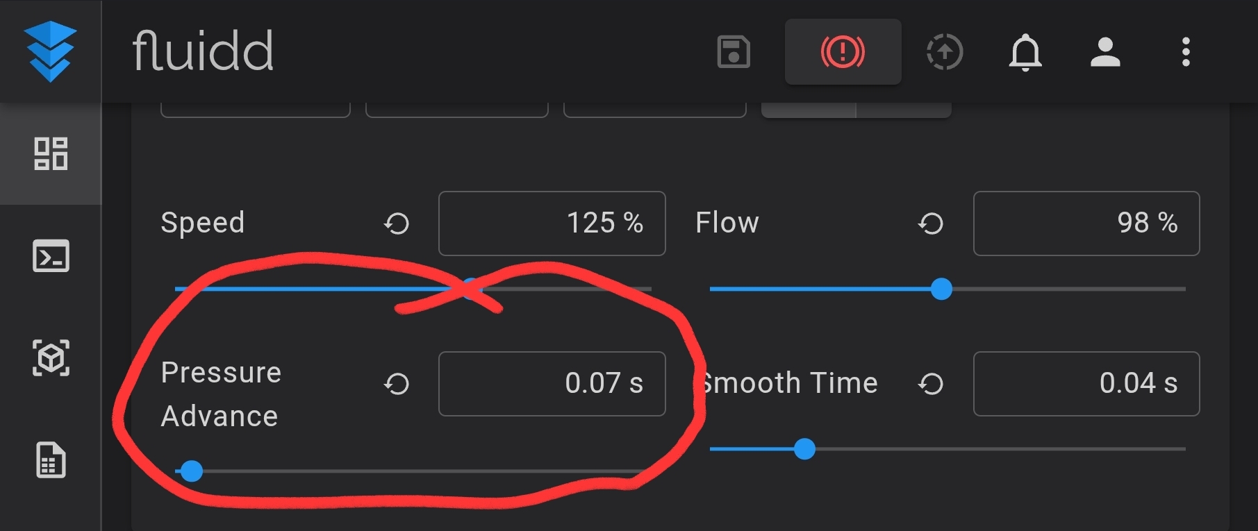

Fyi, you never need to run the CR menu “calibration” options for PA & flow, as those are the 2 that are run when you send a print to the device and don’t untick the " run calibration" button, on the preview page . These 2 tests are the left hand side squiggly lines and right hand side rectangular strip… So while good you are calibrating, you don’t need to run specific “calibration tests” to get these 2 sorted.
Fluidd captures these and displays the optimal values from it’s self calibration & scan “only while printing the object”, so capture fluidd info while your project is printing

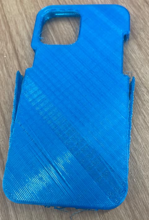

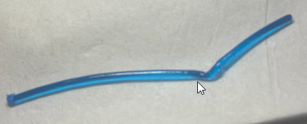

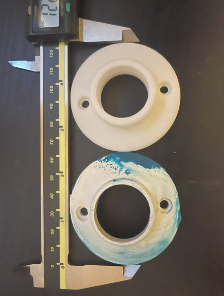

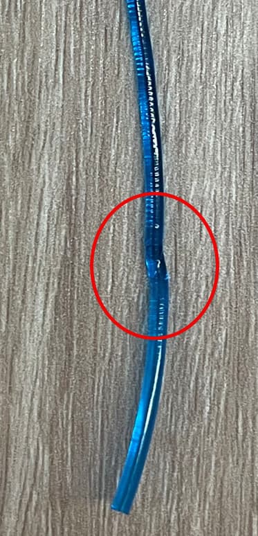

Thank you for the detailed reply. I really appreciate you taking the time to explain. I’ve never heard of Fluidd but looking into it. I’m new to the Klipper FW stuff and will take some time to look into these. One side note of the issue i’m still experiencing with this Sain Smart translucent TPU is this area I have highlighted. Although not as severe, the “kink” shown keeps happening after a certain amount of time during a print. This is the area that gets sucked into the extruder gears.
-is there too much retraction?
-or is there not enough force on the extrusion gear because i put in a less stiff spring?
Fluidd is your printer web interface, browse to {ip address of printer}:4408 (found in your printer network setting page)
And it will load this web interface. I recommend setting a static IP via your router to the printer that way each time you turn it on you don’t have to find the IP address from the machine .
That looks like too much retraction to me…what settings are you running ? I use 0.2 using the non-spring method

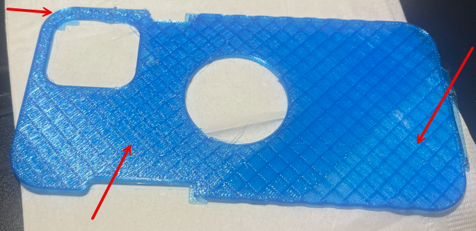

I was using 0.2 for retraction but with the spring method. I’m going to try your non-spring method this evening. I’ll let post results. (FYI, I used three TPU colors, all Sain Smart. Opaque orange and black, translucent blue. Only the blue fails this way.)
Hmm, while I’ve not used translucent tpu I can guess what the issue is, with PETG the translucent colours require a different profile to the solid colours, in order to print well… this is due to different processing/content in the filament
So if my non-spring method gives you the same results, make sure you run a temperature calibration, + auto calibration & at the translucent start of the print, to check PA & flow values against your solid TPU profile, I suspect they will be different from solid to translucent TPU profile…

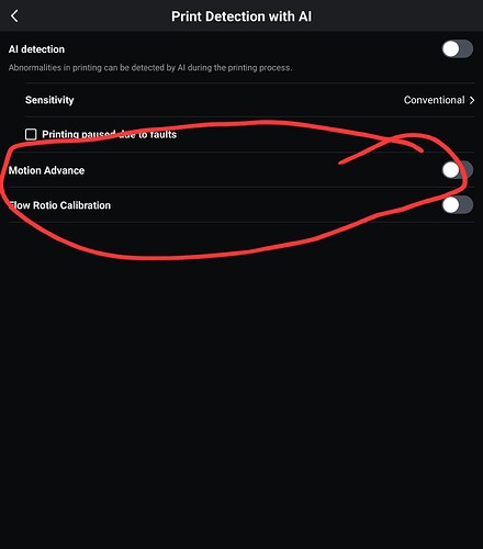

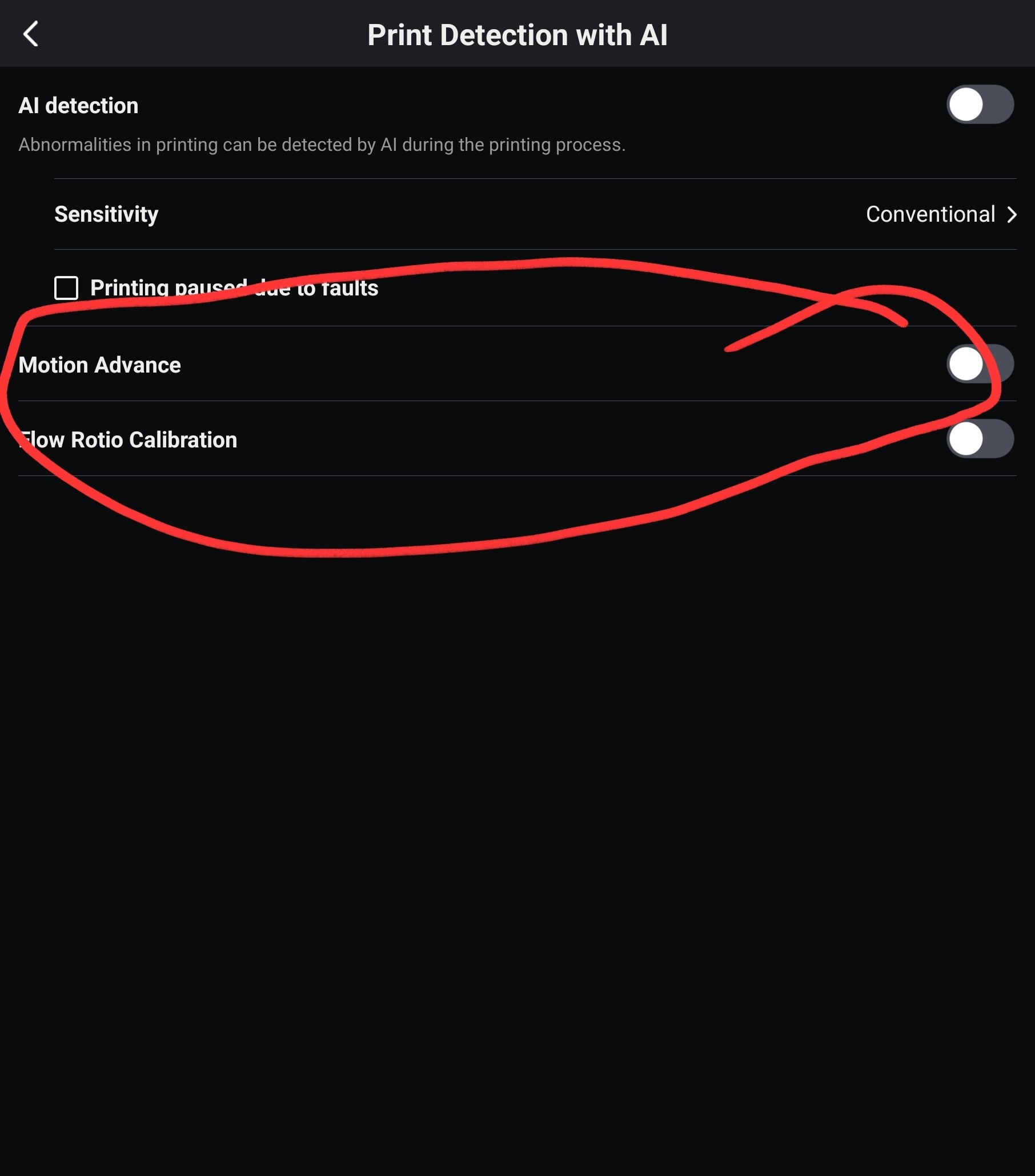

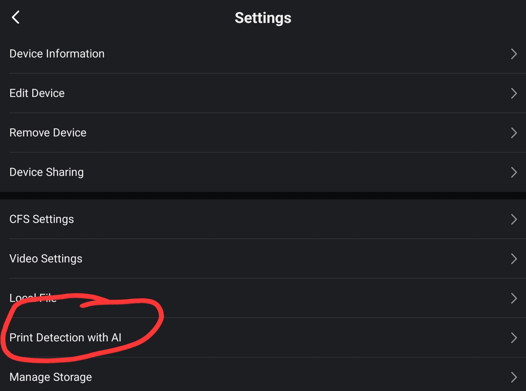

There are 2 boxes, that control what tests actually run, when you choose auto calibration from the CR software.
On Mobile app you can change these (or via system menu) 3 dots top right, then

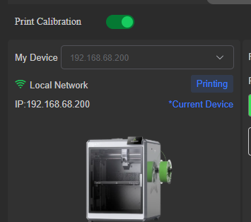

Then when you either use CR software on a computer in preview - screen, send to printer, there is an auto calibration button usually enabled by default..
This option, runs which of the 2 on the system are enabled .

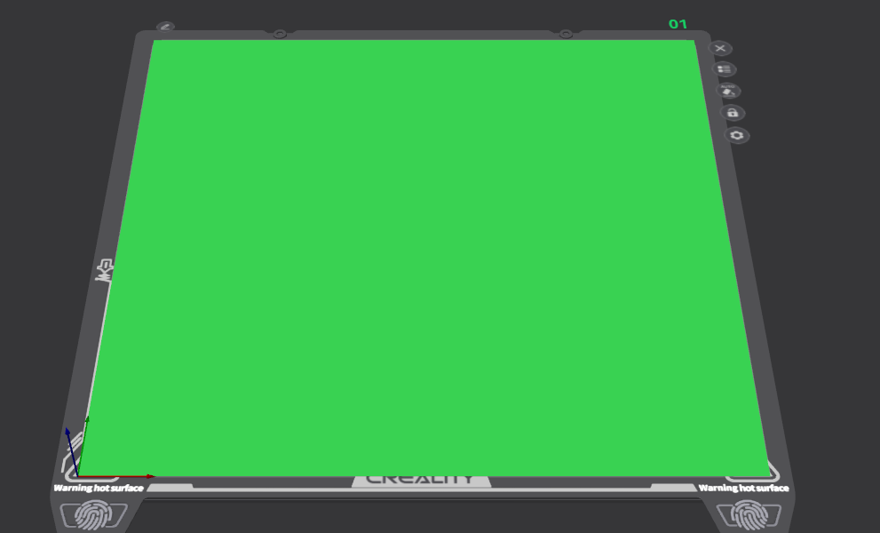

So if PA is enabled on the K2, running auto calibration as part of a print, prints the squiggly lines on the front left of the bed.
This tunes the PA values which are displayed in fluidd
Note, this isn’t saved anywhere .. so if you don’t have a “filament user profile”, and only use the system profiles for filaments, then you have to run this test every print, wasting time and filament. To get good prints. Saving this as a filament user profile allows via CR object menu to choose K2 filament with these settings, so you get good consistent prints.

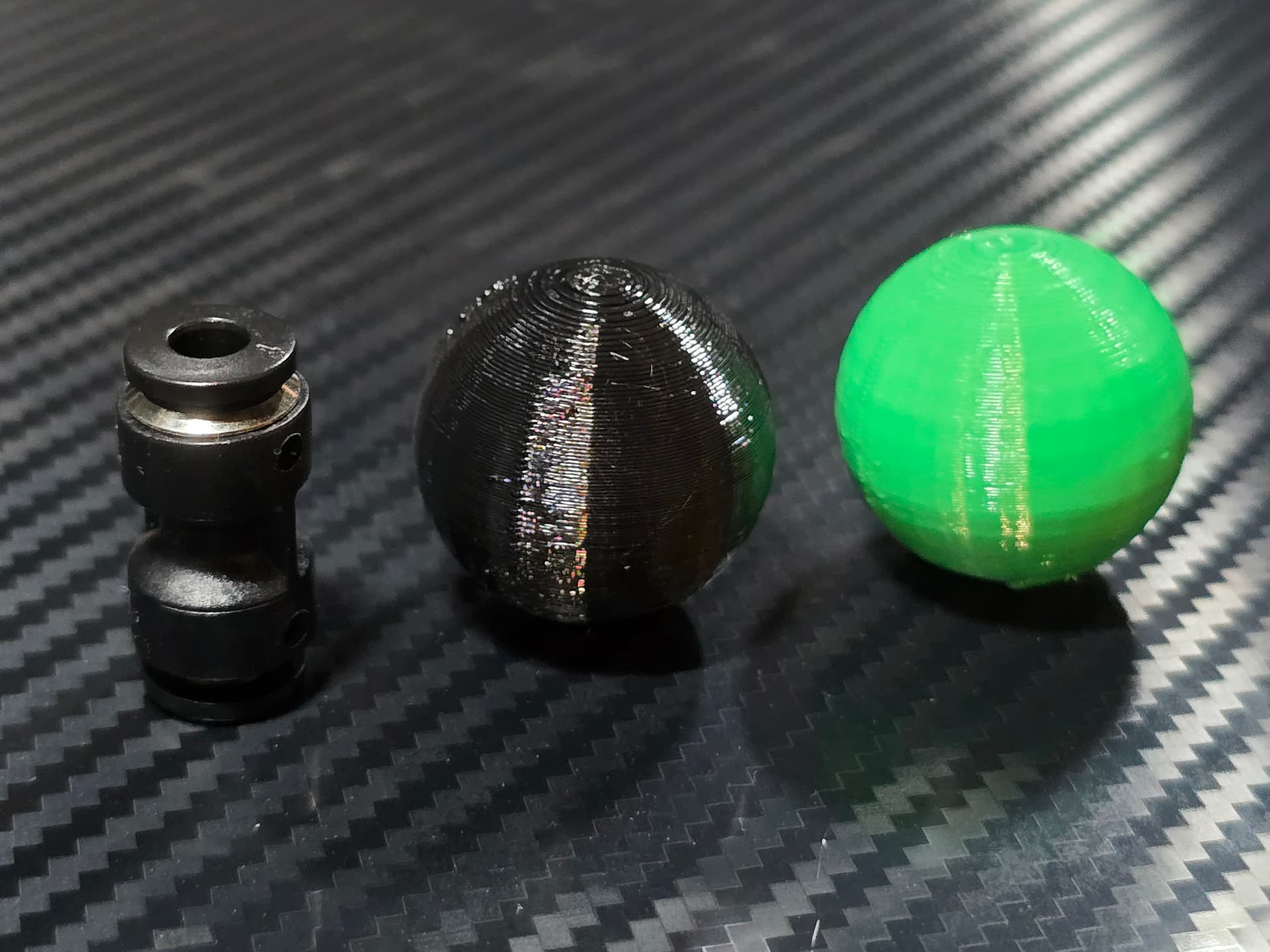

when I printed this ball in TPU, its imperative that PA is disabled, or else you can’t print things like this, you just use PA “values” to dial in the spring (or in my case screw tension)
(black is TPU, green is PETG) prints perfectly without a brim or any supports..

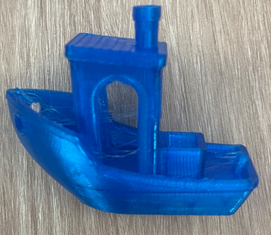

I printed the Benchy on the K2 and it turned out fine, using the non-spring method you shared.
a little stringy…temperature too high?
Either temp too high or retraction distance/speed..
If you are printing low volumes just play with the settings before next print, if you want to dial it in use the temperature, & 2 retraction calibrations..

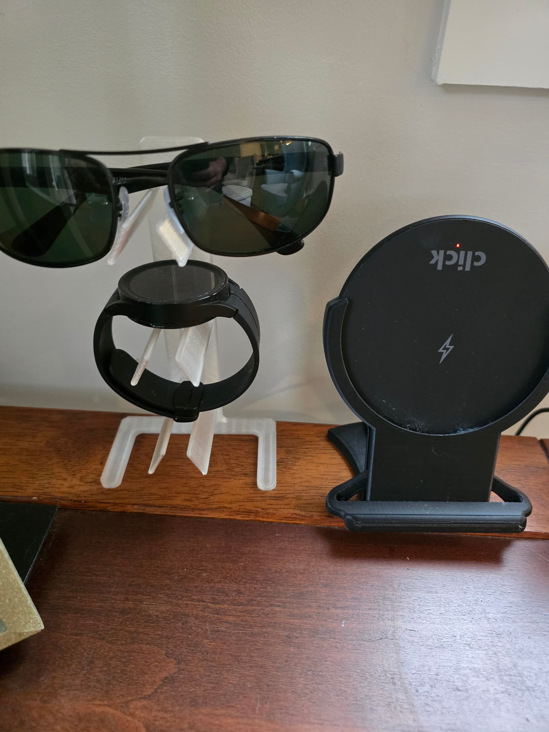

I print transparent PETG stuff..
This is the type of things I make/print.. using transparent petg, sunglasses holders (or ABS QI phone charger/stands )
That’s cool. I have not used PETG. I also print stuff that I find useful. If I have something made of plastic and it breaks, I’ll reverse eng it and print. I found myself at one point wondering where I was going to get a replacement part for a three-corner support for shoe shelf and I slapped my forehead and grabbed my calipers. Cheap plastic ones were breaking. So I printed 24 of them and replaced.
