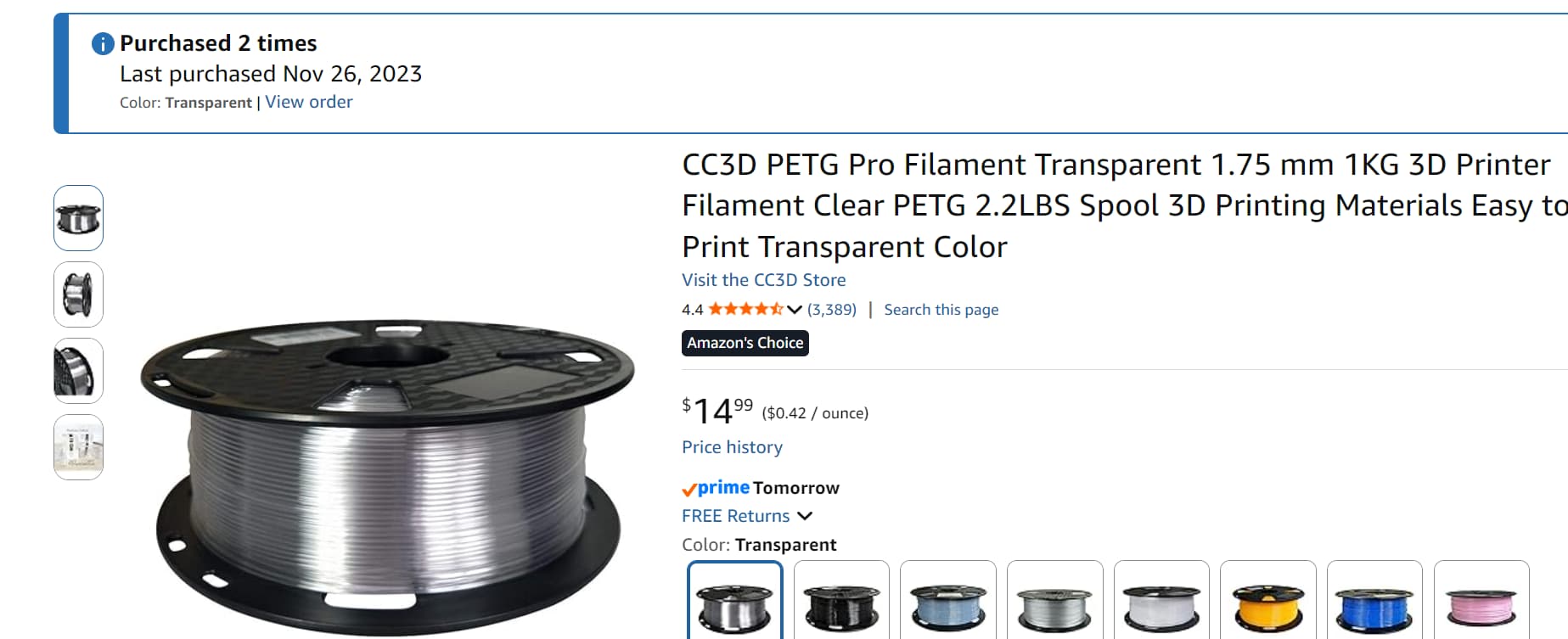

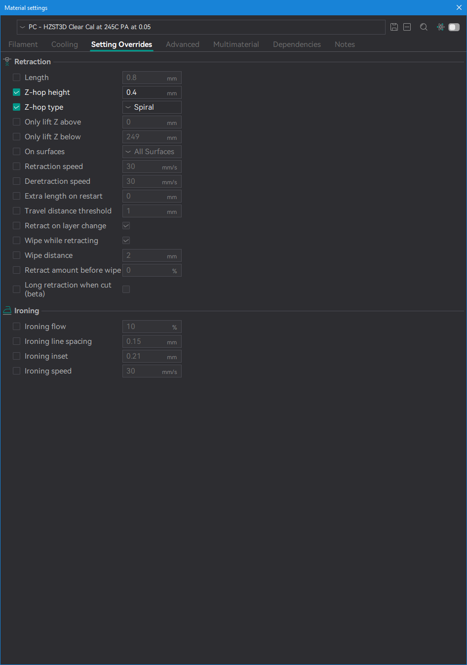

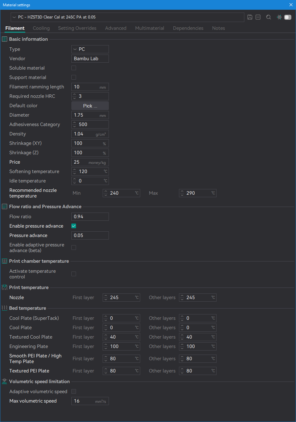

- It took a lot of trial and error with so-called “transparent filament.” Out of six different PLA and PETG options I tested, only one really delivered, and I mean only one. It is sold under two brand names, CC3D and HZST3D:
Amazon.com: CC3D PETG Pro Filament Transparent 1.75 mm 1KG 3D Printer Filament Clear PETG 2.2LBS Spool 3D Printing Materials Easy to Print Transparent Color : Industrial & Scientific

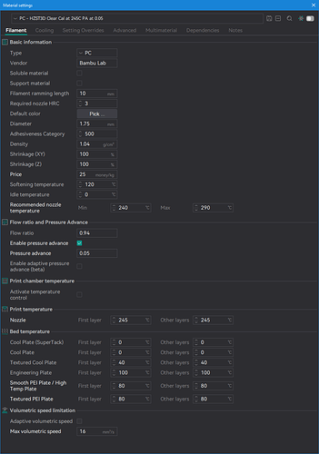

DRY YOUR ALREADY DRY FILAMENT!!!
I’m not kidding here, I went through two spools before I realized they were indeed still wet out of the dryer, I put them back in the dryer for 48 hours and the difference was night and day. Or as in this case, cloudy vs clear!

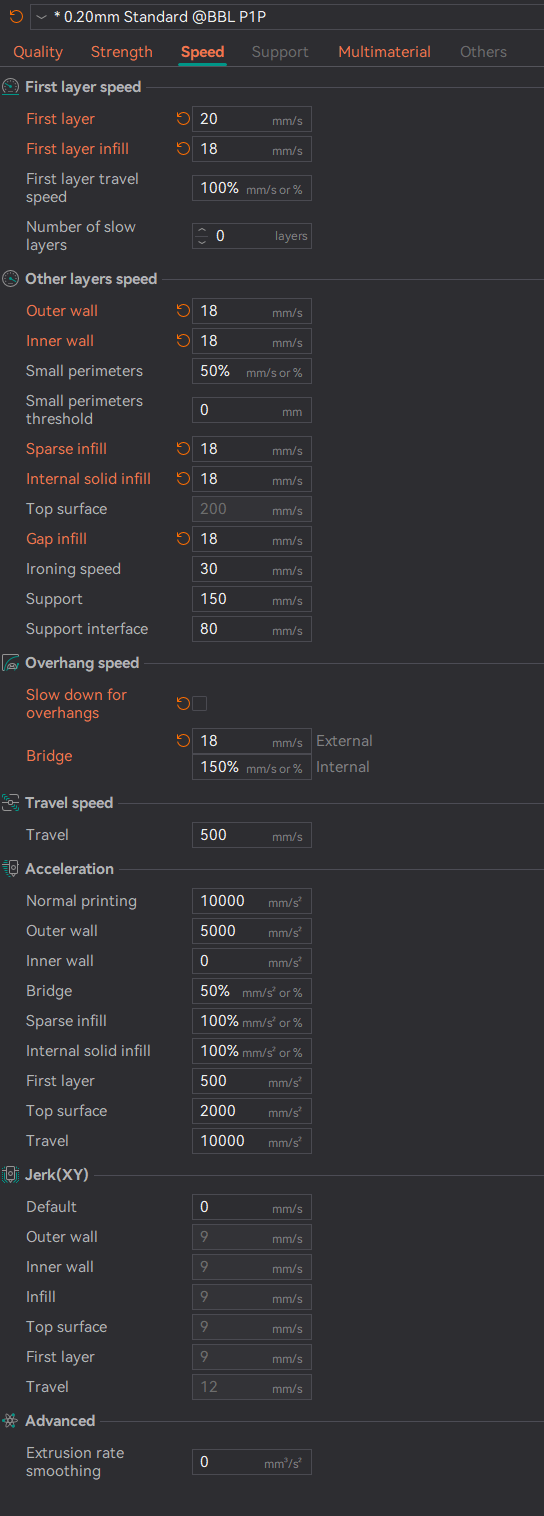

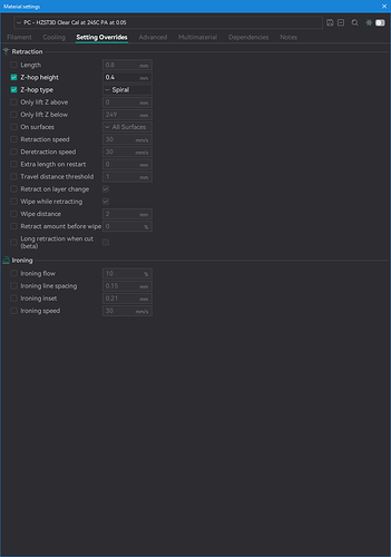

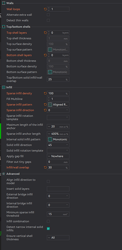

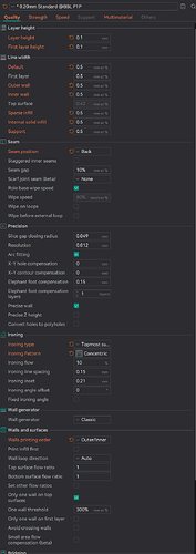

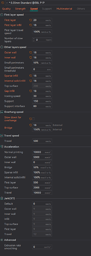

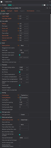

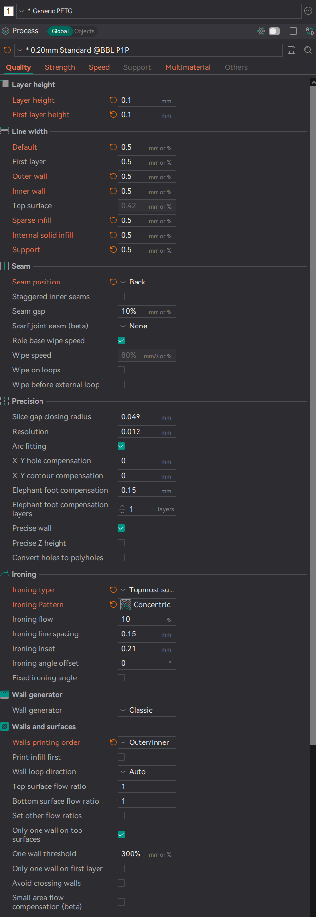

Good filament alone is not enough. You also have to slow the print speed way down(10% of actual full speed). Search MakerWorld for “How to Print ICE” and start with that 3MF profile. I will not direct-link it here out of courtesy to the forum admins since that is a competitor site, but I can at least show the image of the profile you should start with.

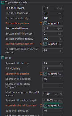

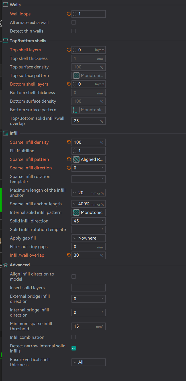

From there, I had to slow it down even more. The big trick is that all nozzle strokes need to run in the same direction on each layer, including the top and bottom surfaces. That seems to reduce internal turbulence, bubbles, and haze.
Print outer wall first and only one wall layer.

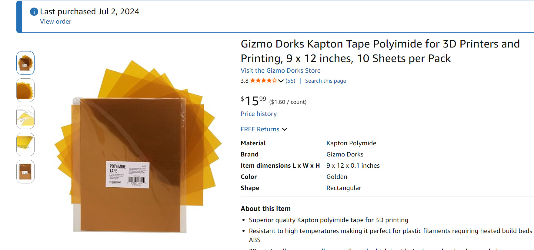

- A smooth plate with Kapton tape on top can also give you a glass-like finish where the print contacts the bed. Gizmo Dorks makes a good 9x12" sheet for this, but any decent Kapton tape should work. Just take your time smoothing out the bubbles when applyin the tape.
- I apply it using the wet method, similar to putting tint film on a car window.
- Amazon.com: Gizmo Dorks Kapton Tape Polyimide for 3D Printers and Printing, 9 x 12 inches, 10 Sheets per Pack : Industrial & Scientific
Speed is your enemy, it introduces turbulence and has to come down dramatically. See my settings below. I have never been able to print faster without ending up with a foggy interior. Maybe a high-flow nozzle would improve that, but I have not tested it. When I say SLOW, set your expectation for a 1 hour print to take 12 hours.

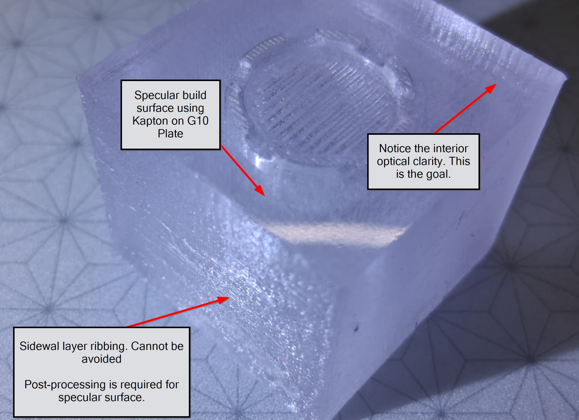

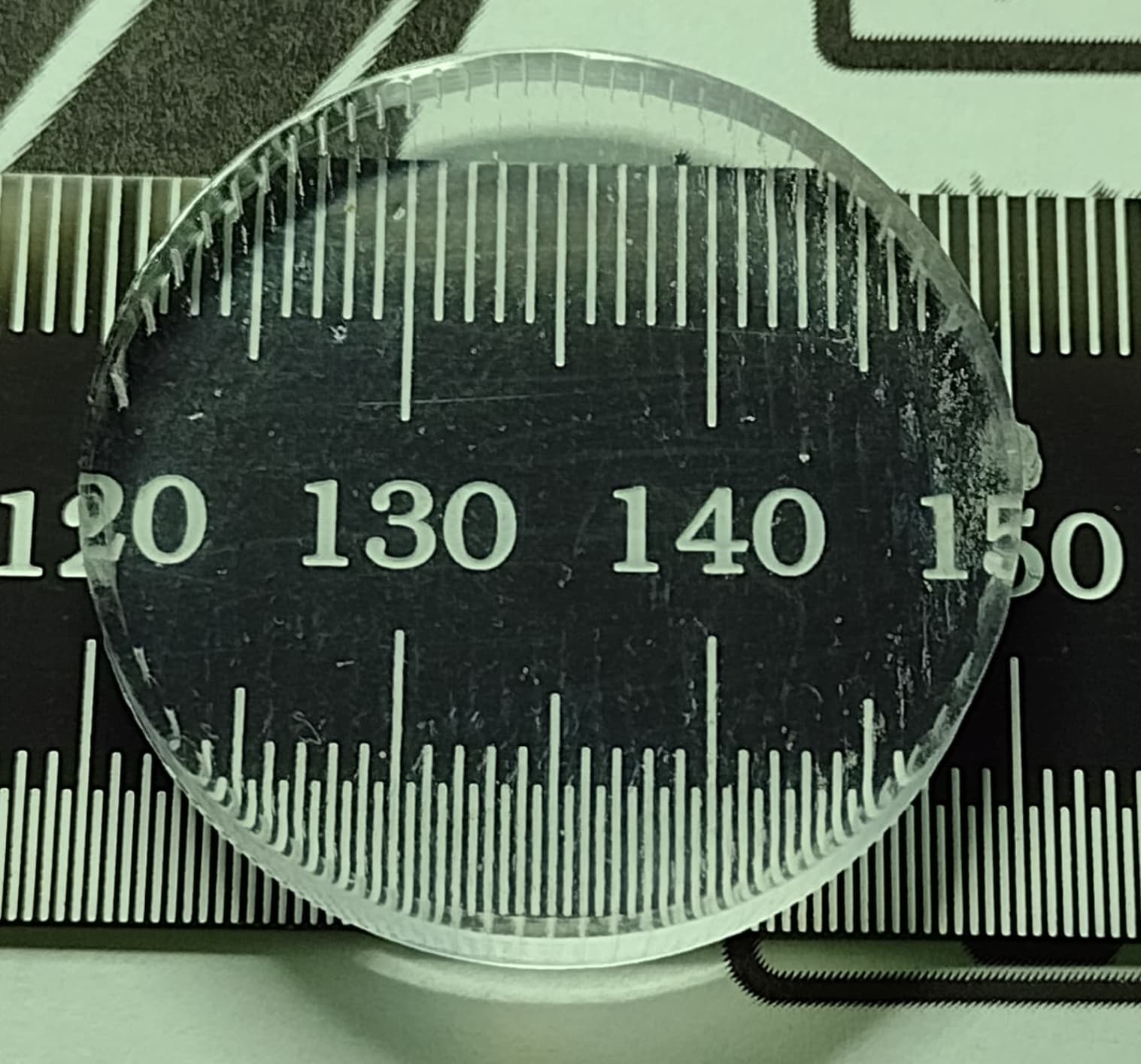

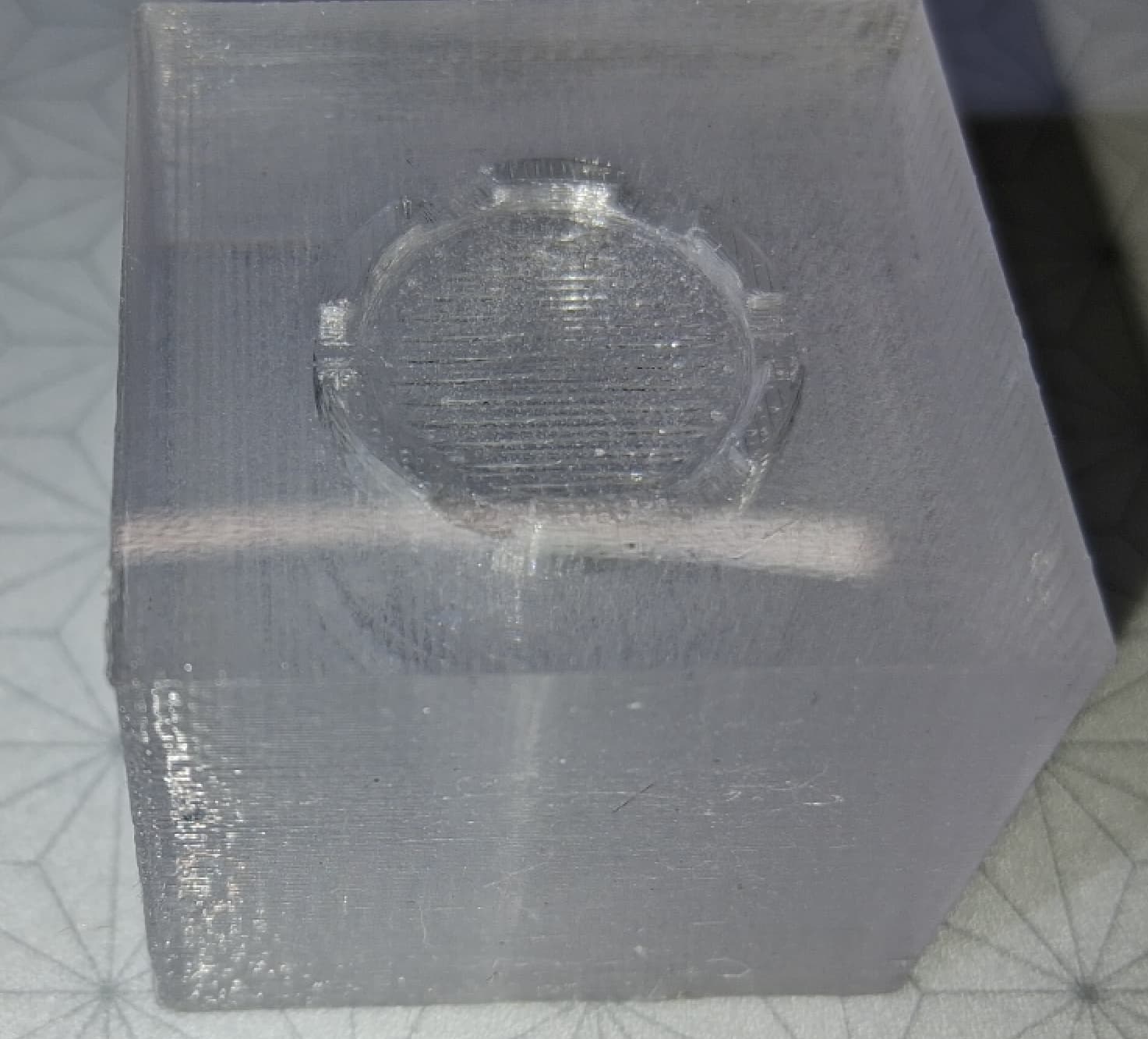

Forget about getting an optically smooth surface straight off the printer. I got my best results by post-processing with wet sanding followed by a final clear coat. Once you achieve good internal clarity by laying down smooth, consistent filament paths, sanding and clear coat are what give the part its final transparency.
For sanding, I started at 240 grit and worked up to 600. I also tried polish and jeweler’s rouge with mixed results. Clear coat was faster and gave me better results. Your mileage may vary, so it is worth trying both.

You also cannot expect an FDM print to come off the build plate optically clear. Physics is not going to let that happen. The layer structure alone creates enough surface variation to produce visible ribbing along the edges.

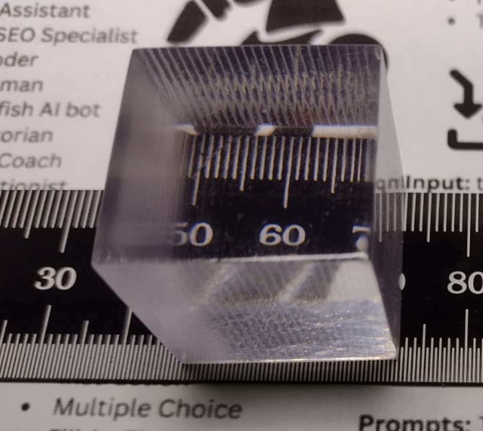

Here is an unfinished project that shows what the part looked like directly off the build plate before post-processing:
Once you get the interior as clear as possible, then post-processing can do the rest.

These settings have NOT been tested on a Creality printer. Use at your own risk.
