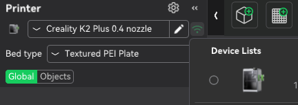

I had the same on my K1 MAX when upgrading CP, so might be the same issue , I had to click the WiFi icon on the top left of the screen at “printer”, it showed my printer & a tick box, I selected the box & all the filiments then auto mapped from the cfs.
Hopefully it’s the same for you.
