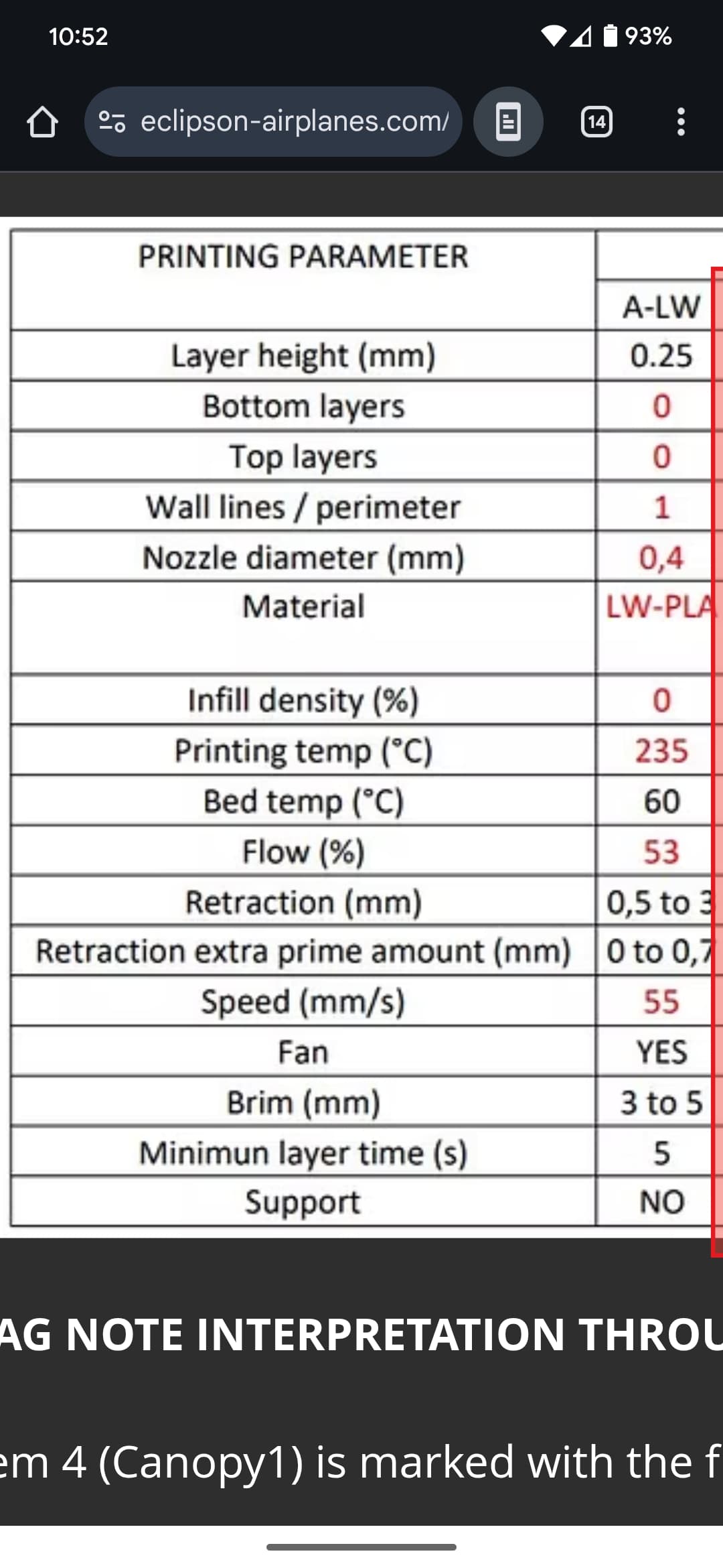

K2 printer settings
I am new to using the Creality slicer and have to find the settings in the image. Can someone help translate and guide me to the right settings.
