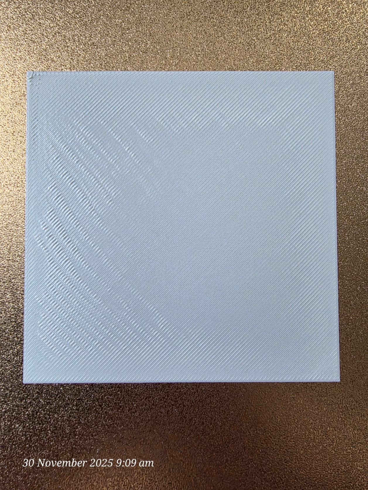

Since day one I’ve been having constant issues with the first layer. Starts fine then goes really bad about 1/3 through the test print. Being a beginner I didn’t know any different and thought that was normal. Now I’ve got a little time working with the K2 Pro (and Plus) I know that’s not right.
If I manually adjust the z offset during the test print I can get a really good first layer (a -0.125 adjustment). But I work and can’t be home 24/7to make sure the first layer is layed down (at least) good. You shouldn’t need to be a programmer or engineer to get things right. I have to manually adjust the Plus z offset by -0.11.

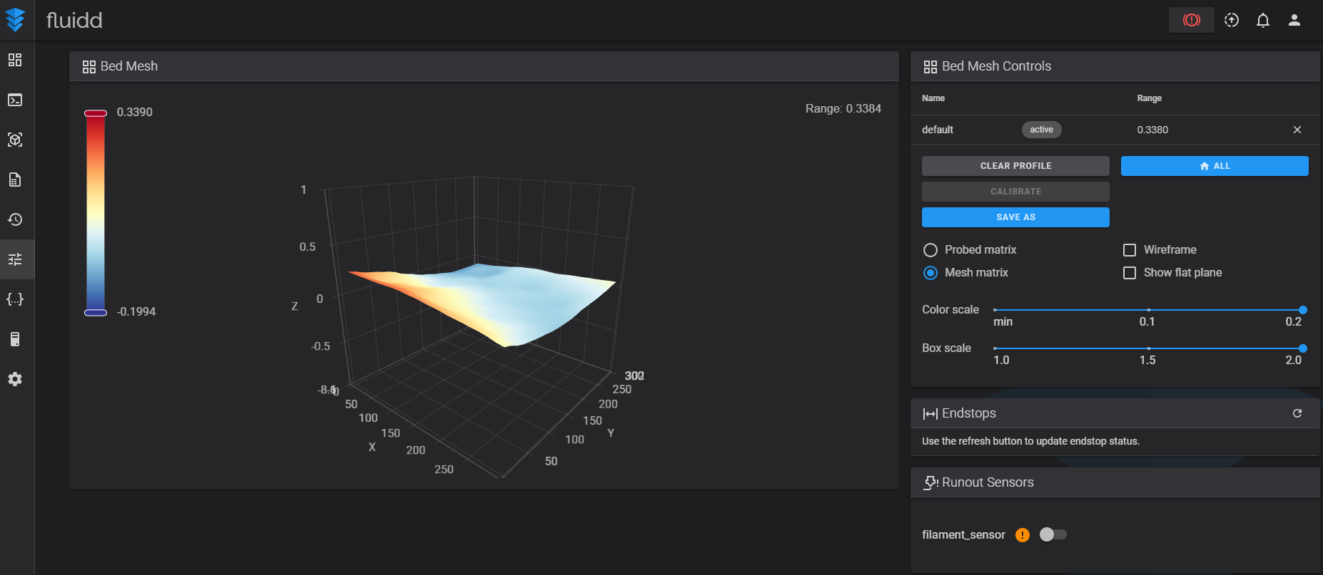

The only thing I can think of (after seeing the bed mesh in Fluidd) is trying to set the bed level. According to what I’ve read, if you try and set the z offset in Fluidd the g-code just resets it back to 0.
Just an addendum: what I can see (from an untrained eye) is that the issues with the first layer follow the curvature of the bed mesh. Right hand side starts fine (a lille low and squished) but then as it heads left (where the mesh shows the bed rising) is turns to custard. It’s like there’s no compensation for the rising level of the bed.

Could you share a picture of the first layer ?
And can you share a picture of the bed leveling map ? You can find it via Fluidd ( IP of your printer followed by :4408 in the URL bar of your navigator)
Sometimes it is not an issue due to the Z-offset but the leveling of the bed

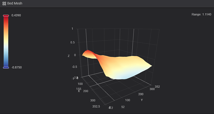

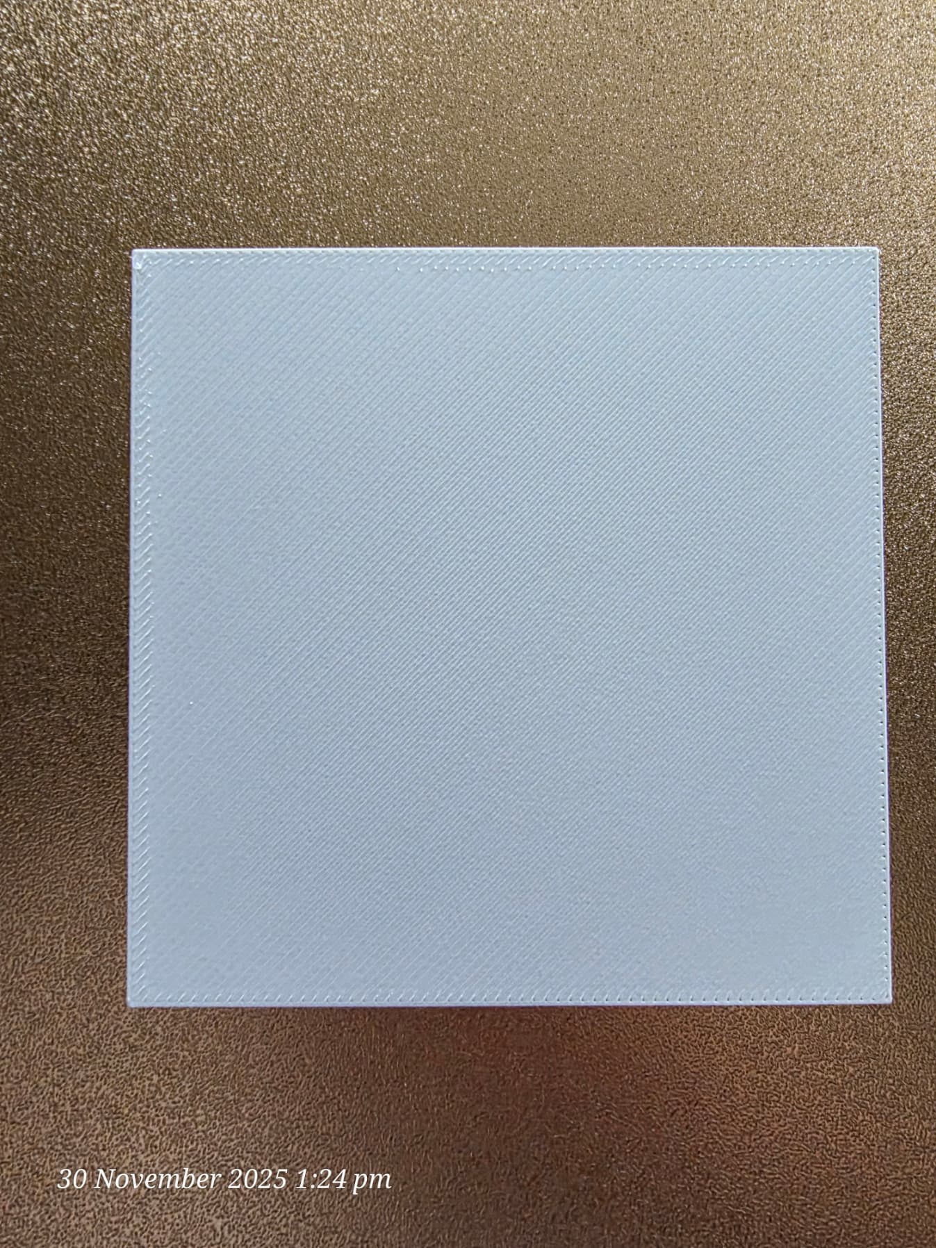

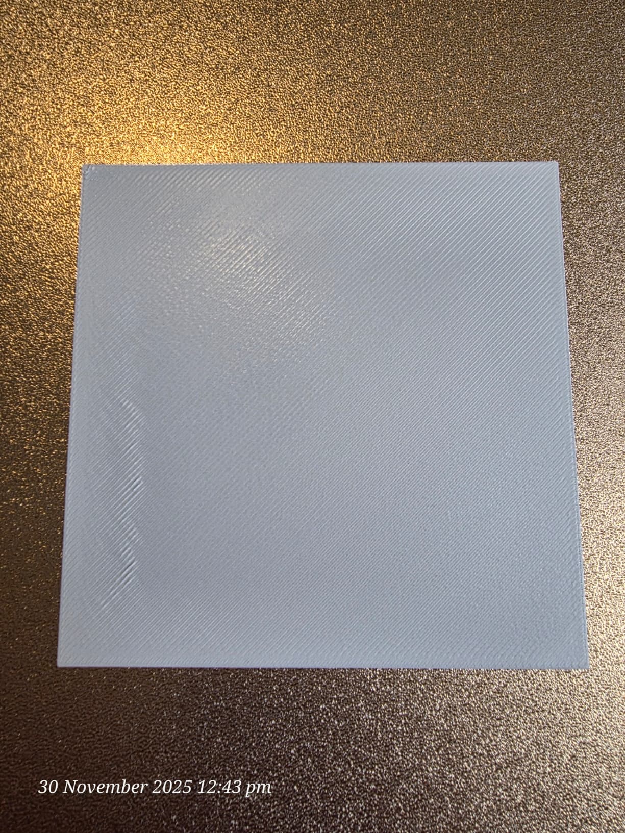

It was the bed leveling. DnG Crafts on YouTube updated his K2 Plus bed level macro to work on any bed size and I’ve gone through and run that several times. The bed level range is now 0.3384 (from 1.1342). The first layer is good now. Now I need to work on the K2 Plus :frowning: . The first mesh os the Pro (0.3384). The second is the Plus (1.1140). The two print pics are showing the improvements after each bed leveling using DnG’s macros on the Pro. Trust me you don’t want to see the mess the Plus makes with the first layer.
