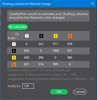

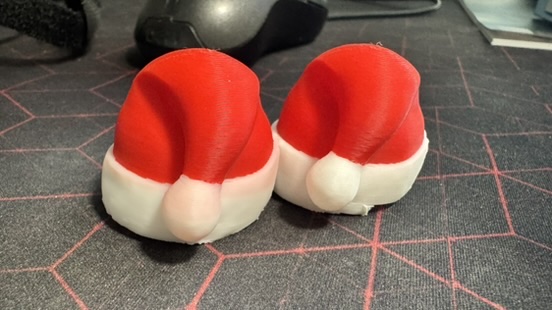

What setting should I check to prevent color bleeding between red and white? I have Flush at 1.40 and 1000. The only difference that I know of between the correct one and the other is, I didn’t tinker with the support settings on the pure white one. The pink one I adjusted supports.

You might have already done this but just curious what did the flushing volume chart show between the red and white…?
From Red to White is 960. I had it up to 1000. The multiplier at 1.40. I then printed a fidget and painted it red and white. It also bled but cleared until a layer of red. Testing a cylinder now. Red to White 1060, 1.40 multiplier. It came out better. I guess I just didn’t run out enough. Time to reprint the Santa hat. Just to be clear, this is Creality PLA.
