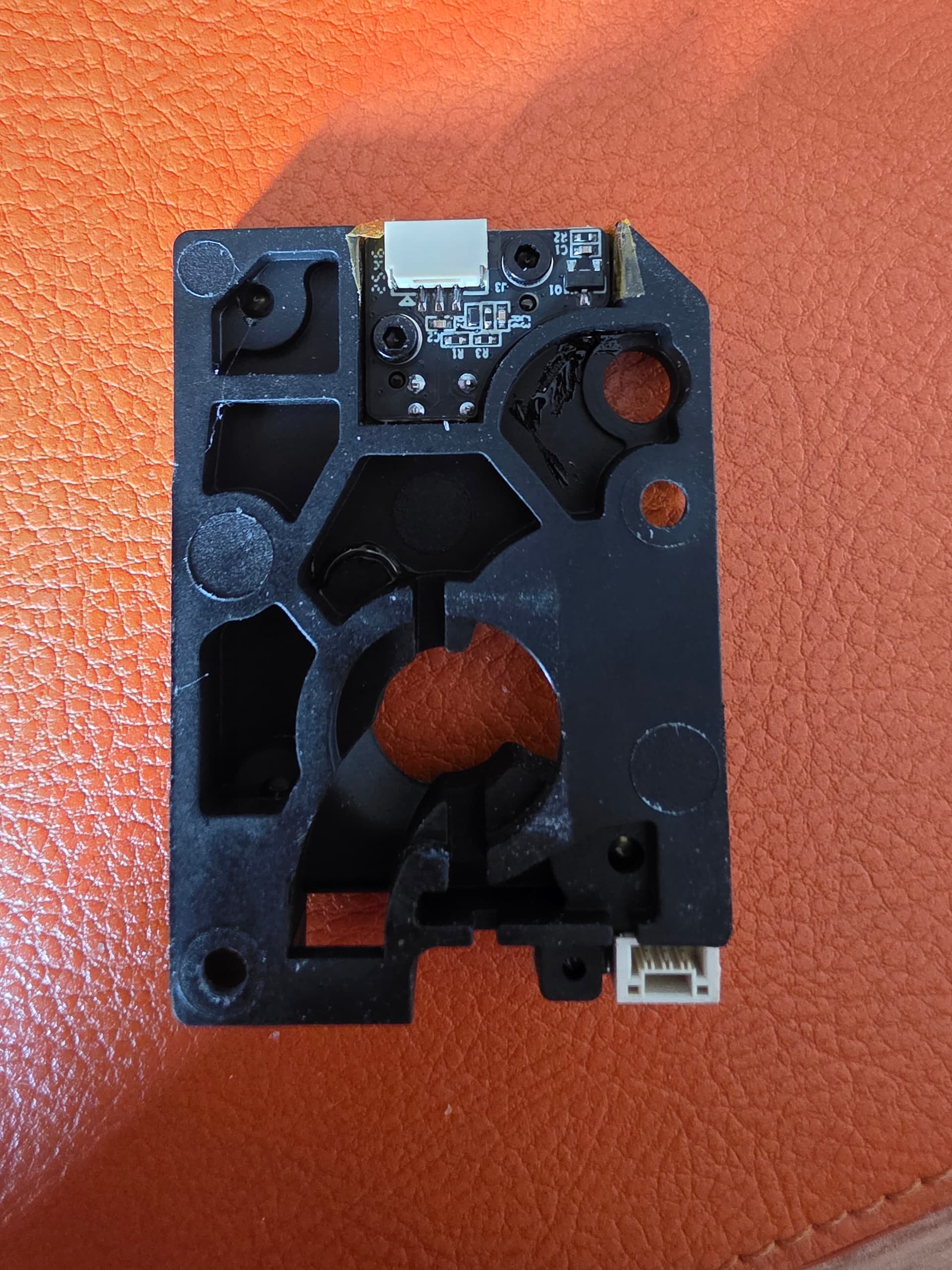

Update — current configuration, remaining DXC2 symptoms and next tests
First off, thanks to everyone who has contributed ideas and test results in this thread. Also apologies I have not been as active on this as before — work has been busy, so I have been testing in smaller chunks rather than updating as often.
I’m still chasing this, and I’m now fairly convinced this is not one single DXC2 fault. It looks more like several small thermal and mechanical margins stacking together:
  • rear DXC2 cavity heat soak;
  • filament sensor heat exposure;
  • Bowden path / entry-angle drag;
  • cutter travel or cut quality being marginal;
  • CF filament biting into the extruder gears;
  • possible adhesive/grease/resin-like material softening around the rear of the DXC2.
Current setup / modifications fitted

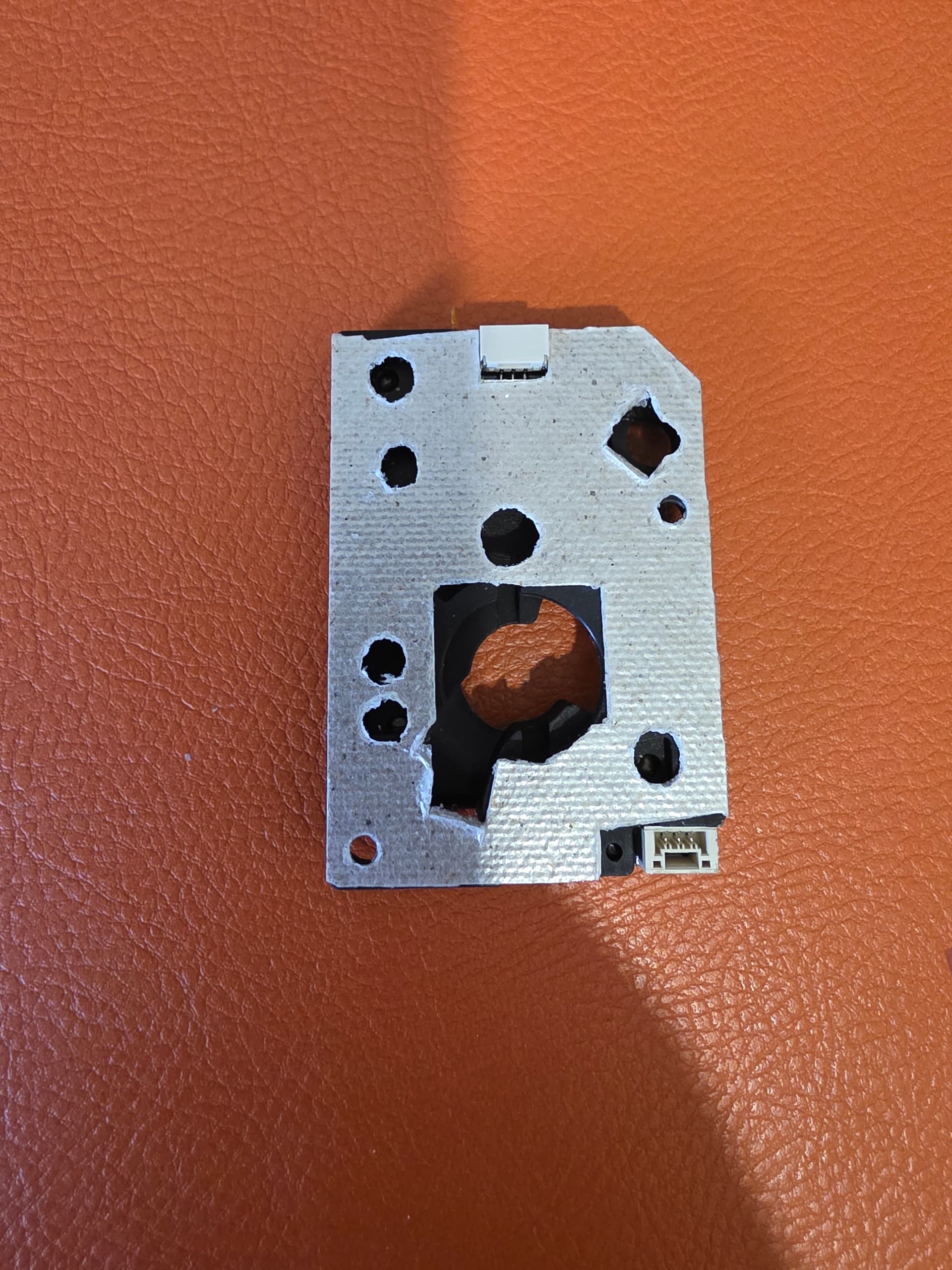

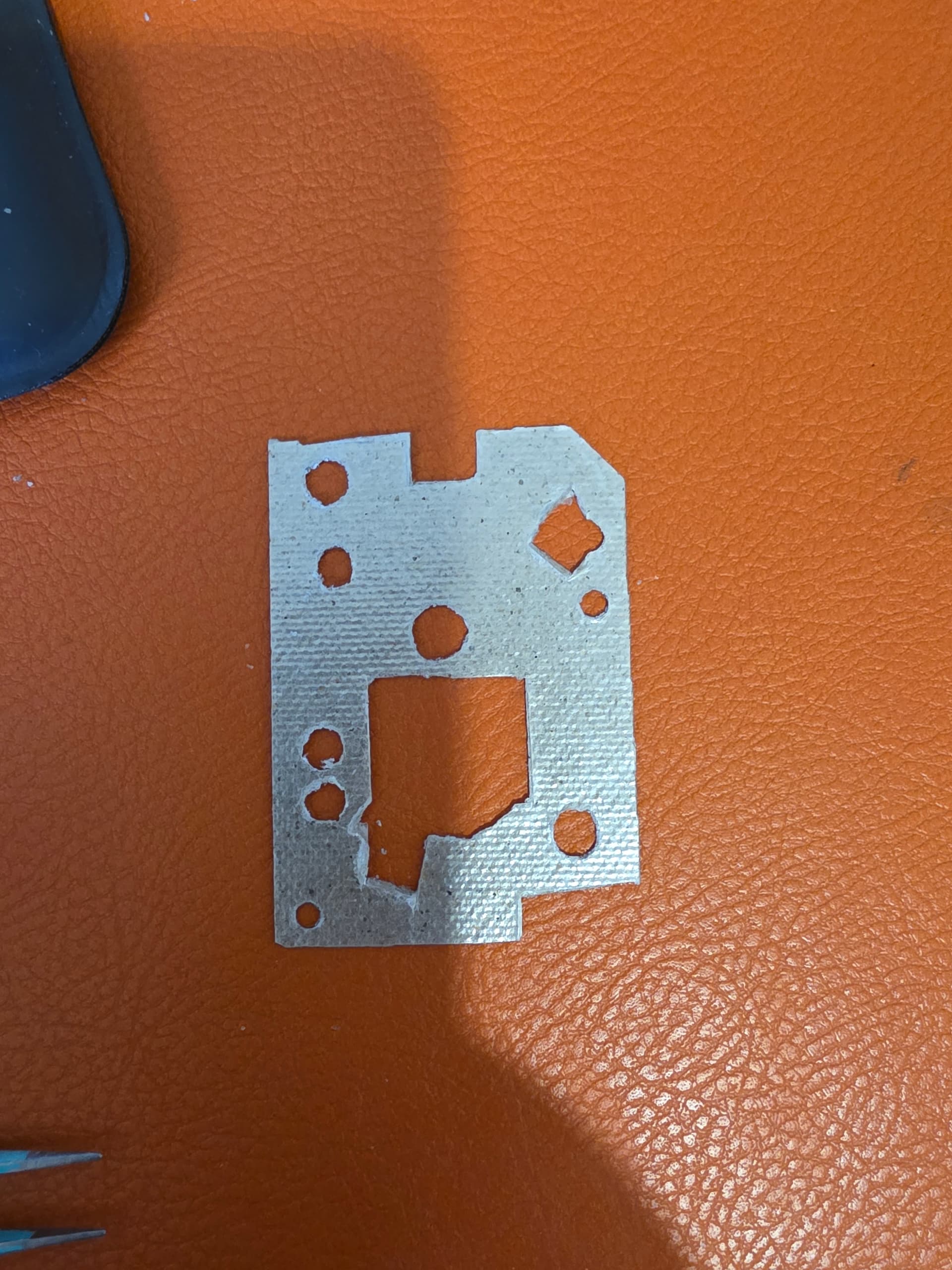

Current setup now includes:
  • mica paper thermal barrier between the extruder motor and the extruder body.
The major practical finding for me is that the Bowden path and the way it enters the extruder make a massive difference. I would not treat this as a minor routing detail. The entry angle seems to directly affect feed resistance, unload reliability, and how close the cutter/CFS system is to failing.
Filament sensor / rear DXC2 heat
The filament sensor behaviour is still much better than it was originally.
Before the changes I had:
  • filament sensor stuck on;
  • LED brightness changing randomly;
  • false detection;
  • intermittent detection;
  • no filament present but the machine still thinking filament was loaded.

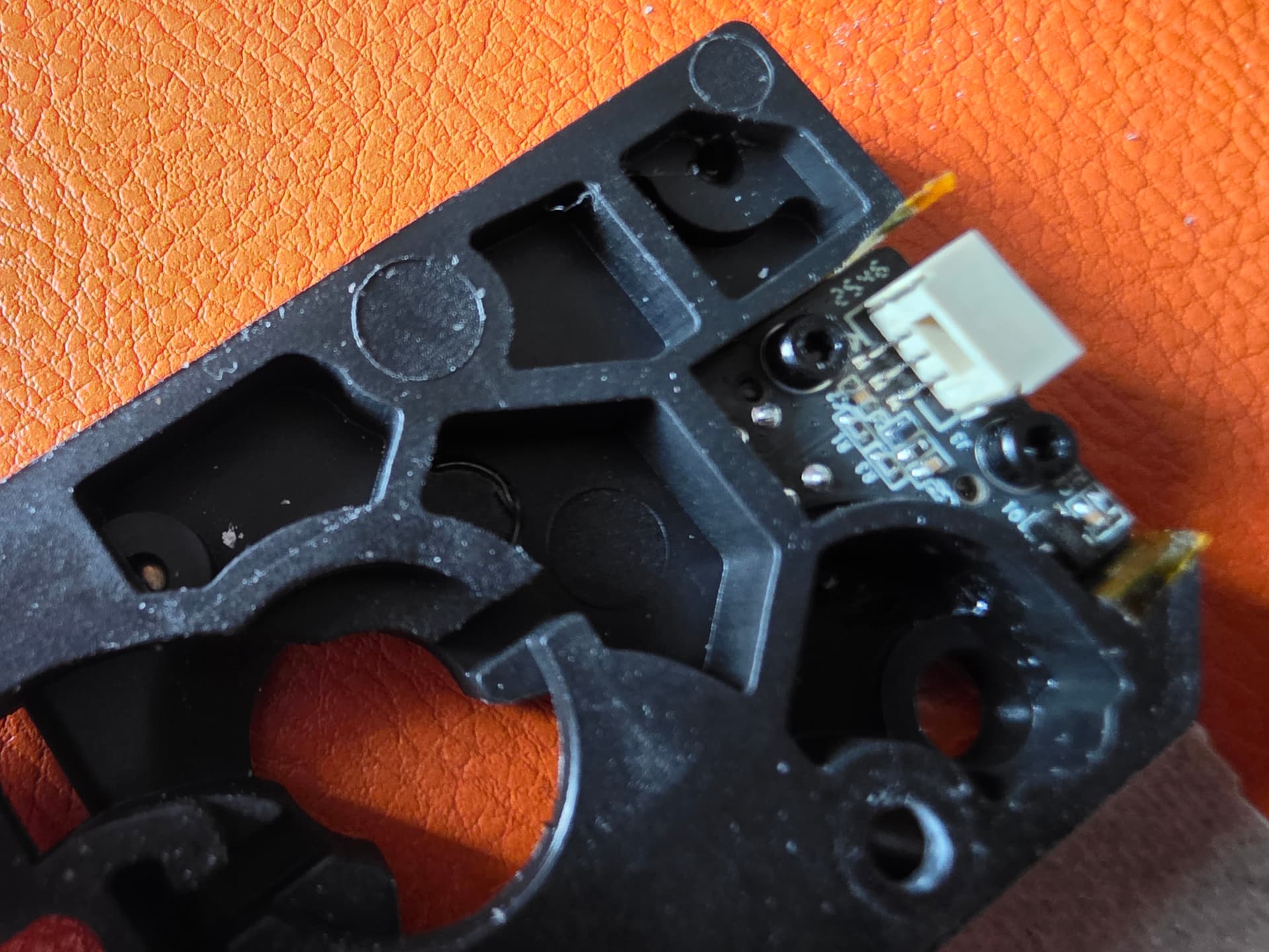

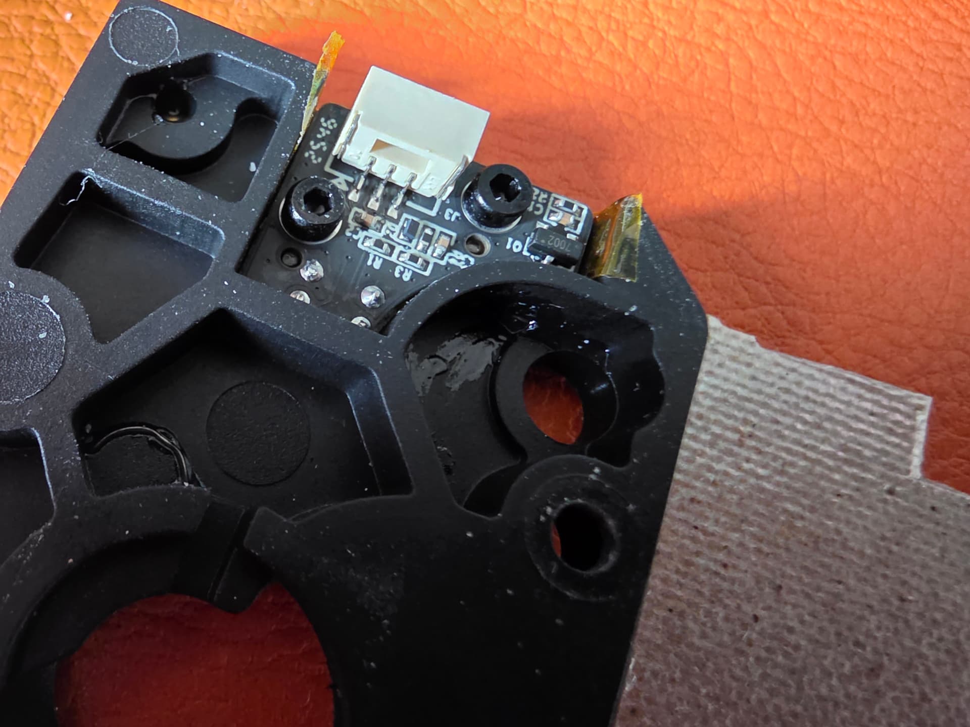

After replacing/refitting the sensor, adding Kapton insulation, adding the mica paper between the motor and extruder body, changing the rear cover, and improving the Bowden route, the sensor behaviour is much more stable.
However, I am still seeing some resin-like/sticky material softening or melting from the rear of the DXC2, although not as much as before. So I do not think the rear-cavity heat issue is completely gone. It has improved, but something in that rear area still appears to be getting hot enough to soften, migrate or outgas.
I do not yet know whether that material is adhesive, grease, printed material, residue from the sensor/magnet area, or something else. But it still points to the rear of the DXC2 being thermally marginal during long enclosed prints.
