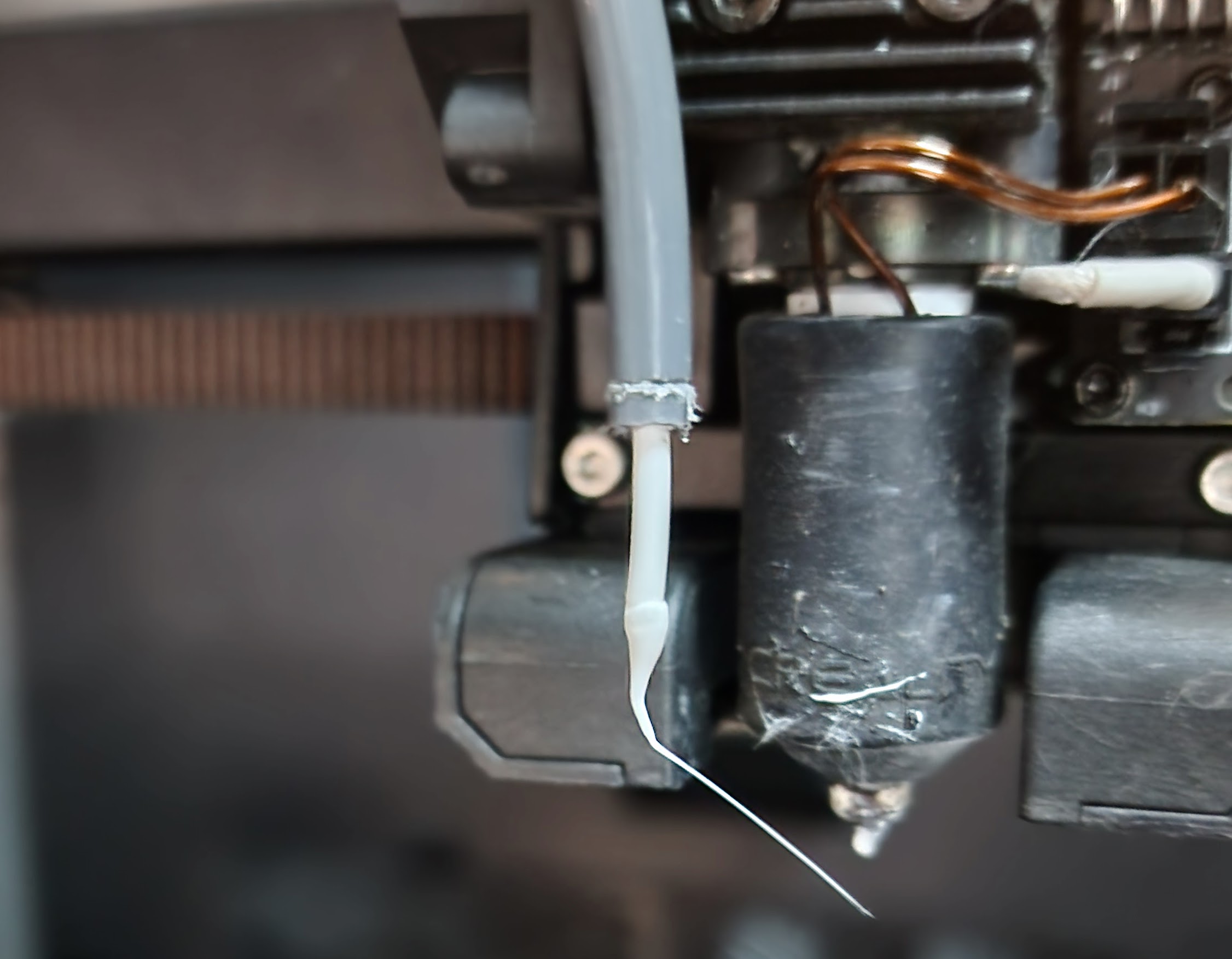

Thanks keeping an eye on this. I found another issue today would not load filament. It would pull some through but then just not print. I took the DXC2 to bits and found the feed cogs would not turn properly and had stiff points. I took the main double cog out and under a magnifying light found loads of little bits of filament in the metal part. Cleaned it up and all is well again. The bits were very small. Could just make them out with the naked eye.

I have just resolved an issue with my DXC2 that maybe worth checking for some. I print ASA in preference to ABS and was having issues with nozzle blockages becoming too frequent. What I found was the cutting blade was not performing a clean cut and when the filament retracted it was leaving a tail instead of a clean cut. When the filament reloaded this tail was bunching up and eventually caused blockage. Long story short the fix for me was inserting a 2.3mm spacer behind the cutter operator. STL for this part is on creality cloud.
@garrye061 Thanks for pointing me towards the spacer fix — it definitely helped me understand what is going on!
I originally printed a 2 mm PETG-CF spacer, but on my K2 Pro/DXC2 setup that was actually too much. After stepping down to a 1 mm spacer, recalibrating and testing, the cutter issue appears to be resolved for me. It looks like more of a tolerance-stack problem between the DXC2, the printed front cover, the cutter operator/rod, the blade position and each individual machine.
For reference if anyone needs to print it the link is: 3D Printer Files | 3MF File | K2 Plus Cutter Rod Spacer | Creality Cloud
My current theory is that the DXC2/front-cover setup changes the effective cutter geometry just enough that the blade is operating right on the edge of its required travel. If the cut is even slightly incomplete, the filament retracts with a small tail instead of a clean end. On reload, that tail can fold or bunch up and eventually cause the blockage. In my case, the 1 mm spacer seems to restore enough cutter travel margin for reliable operation again.
I also think the printed front cover itself may be a big variable. The final thickness and shape will depend on the material used, print orientation, warping, first-layer squish, elephant foot, support clean up, flow calibration and even how tightly the cover is screwed down. So two people can both have a “DXC2 front cover” fitted, but the cutter contact geometry may not be identical.
Material choice could also matter thermally. PLA, PETG, ABS, ASA, CF-filled materials etc. will all behave differently once the toolhead heat-soaks. The issue probably is not that thermal expansion moves things by 2 mm; that seems too much. But if the cutter only has a tiny margin, thermal soak only needs to soften the cover slightly, change stiffness, increase drag, or shift alignment by a small amount to turn a borderline cut into a failed cut.
So I think the spacer is not directly “fixing thermal expansion”. It is restoring cutter travel margin. The wider K2 thermal regulation and heat-soak behaviour may simply expose the problem during longer prints because the toolhead, extruder motor, PCB area, cutter area and printed front cover are all sitting at a higher equilibrium temperature.
That would also explain why some people need 2.3–2.5 mm, while mine only needed 1 mm to resolve the issue. The correct value may depend on the individual printer, the DXC2 install, the exact printed cover, the material the cover was printed from, and how much the toolhead heat-soaks during long prints.
So it looks like thanks to you part of the thermal issues are fixed!

@Dozi3 I’ve tried with and with out cover. The config file values had reverted back to the pre-Phaetus values! set them back. re-booting and testing in progress.
No CFS involved. Hot end is clear. I have big hope for the config corrections.
@Dozi3 @garrye061 I had great hopes for the config update, and it kind of sort of worked. Same problem with the head shell attached, but UNLOAD usually works (sometimes needs 2 tries) with the head shell off. I’ll run headshell off for a while and let you all know how it goes. Thanks for all the help!
Try the spacer it was the key to my problem. You can print a few at different thickness until you find the right size. You need to do cutter calibration after each change. Also found some filament types behaved differently so you need to check all you are using and adjust to worst case. Mine woks perfectly now with cover on.
