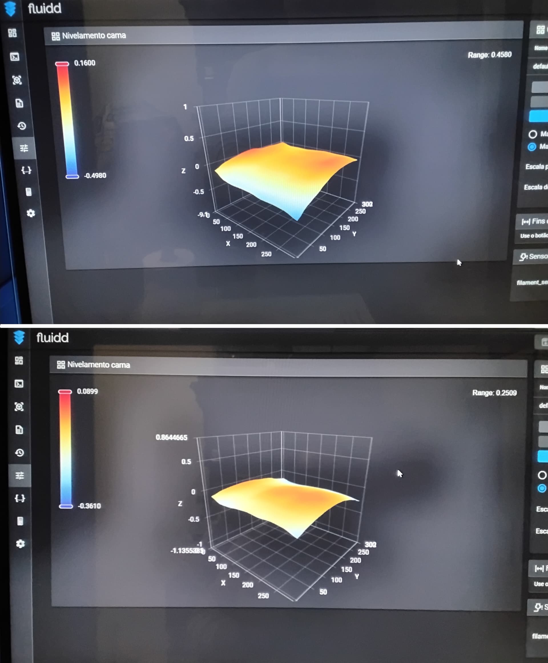

Bed Leveling:
I’ve done a perfect bed leveling on my K2 Pro. There’s no need for extreme measures. I leveled the bed using the Paper Method, turning the knobs to perfection. I didn’t need sanding, aluminum tape, or anything else. It went from 0.45 to 0.25. Even when it was tilted, my printer was printing flawlessly. You can follow this official Creality video tutorial to perform your leveling, the leveling method starts at 6:24. You must fine-tune each corner at least four times in a circular pattern because when you fine-tune one knob, you mess with the level on the other side. Don’t forget to perform all calibrations after you leveled the bed. You can access the Fluidd web interface by entering the printer’s IP address in your internet browser, plus the door :4408 (example: http://192.168.1.3:4408/).

I applaud your optimism. If I only had a 0.45 Bed variance I would have left it there. I started from a 1.2 bed variance and got it down to 0.68 with foil tape.

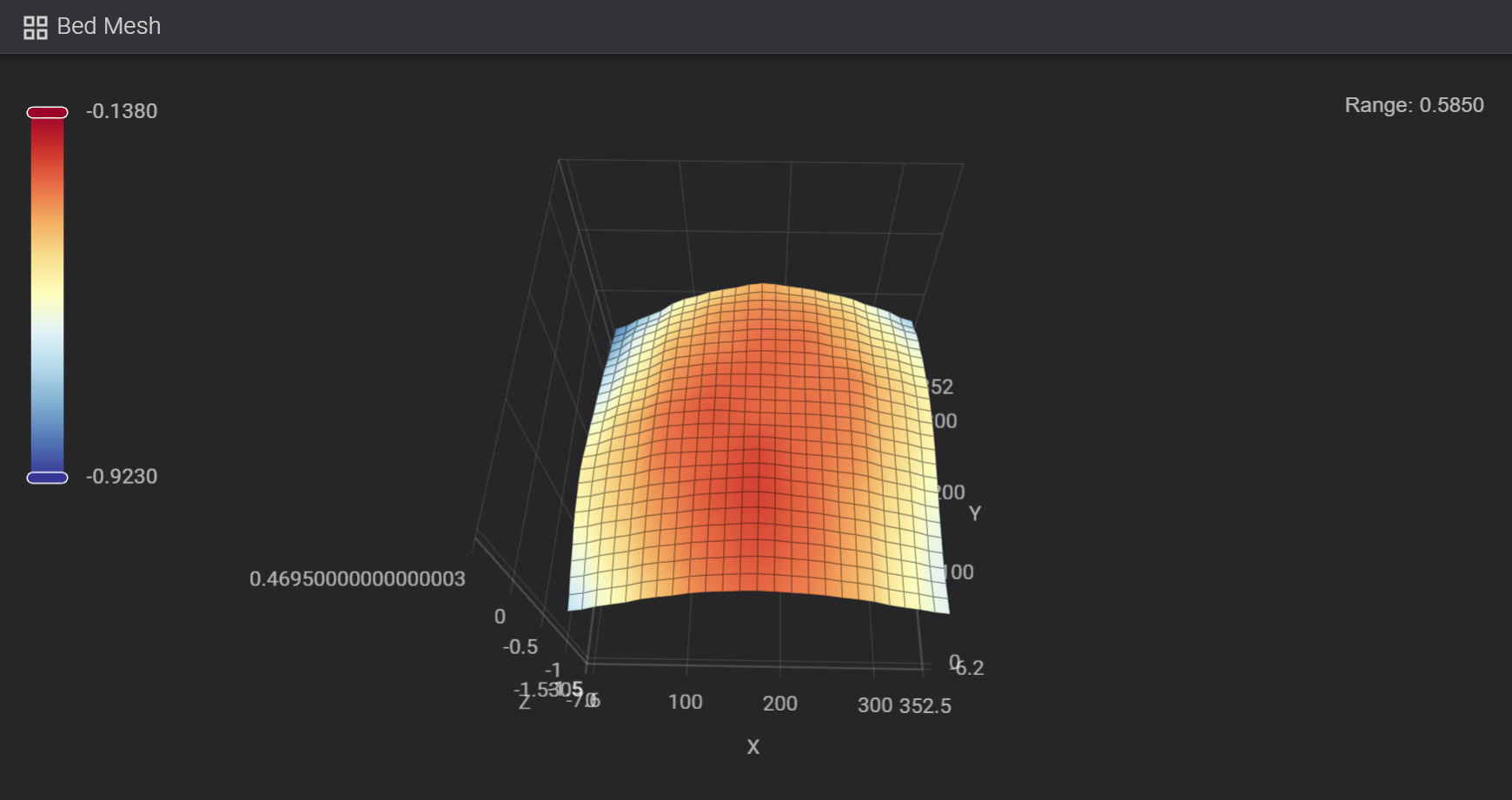

Here’s what I got after going around the plate 9 times. I would say Nuno’s 3 times around the plate is a minimum. I kept going around the plate until no adjustments are needed to achieve equal friction on the paper in all corners. It took 9 times around the plate to achieve stability.
Definitely each corner messes with the other. Even with 9 times around the plate, this is the best I got. IMHO, that is barely adequate.
BTW, in this configuration, the plate guides are below the top of the plate. Fortunately, I had already printed some extenders. I wish there were a way to raze z-naught. I have read about people adjusting the z-offset, but the procedure they describe looks like the bed leveling procedure. There may just be a confusion on the terms.
With that said, one thing I find very odd is that my entire plate is in negative z. I can not rase it any more unless someone knows a trick for that. Also a bit odd to me, even though all of the plate is in negative Z space, It is still to high for the back plate guides to operate.
The plate is clearly bowed. Looks like a strip of aluminum foil down the left and right side with another small square of aluminum in the back corners should bring things into range.

Yep, better than before. Going around all the extra times and securing the adjusting screw was the trick. However, not as good as judiciously placed aluminum foil. I think I’ll fine tune this with foil until the Epoxy Resin Build Plate comes out for the K2 plus, although the R3MEN Graphite Bed is very interesting.
Just for grins I tested the flatness of the plate at room temperature. It came in great. Looks like the real issue here is that the base plate bows when heated to 50c and does not have enough adjustment range at 50c. That lines up with another weakness of the original Creality base plate, uneven heating. I do not have the instrumentation to quantify it, but it really seems from the print quality, that the original base plate does not heat evenly (particularly the edges I have trouble with and the corners). Combine that with a low quality Aluminum alloy and all the symptoms line up. Aluminum is awful for thermal expansion (23.6 10−6/°C linear coefficient of expansion). The very best aluminum alloy for expansion is 4032, at 19.4 10−6/°C. That’s still pretty bad. There are several Stainless Steal alloy’s running in the 5.x range (nearly all of the 4xxxx series of stainless alloys are below 5.8) That is nearly 4 times better performance for very little cost change. That’s just poor materials engineering.
