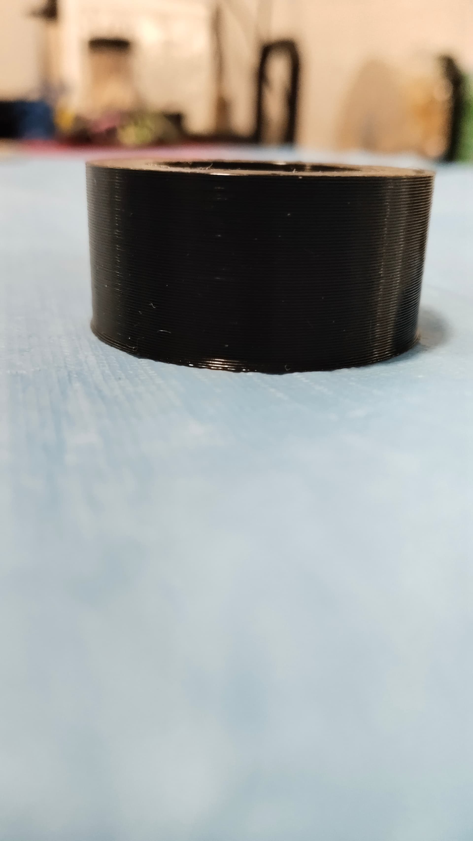

Finally I got what was the problem, or at least how it looked like: something bacame to happen with few first layers of the printed details. It looked like as these layers were much more pressed to the plate. I’m not able to show you those models because I’ve already done some “tunings” of them with help of knife, but I have the other ones:
In the picture above, on the left hand side (without shadow), you can see something like rounding in the bottom on the lower layers, or it looks like some layers were spread out much more than it needed, though it should be like a default cilinder.

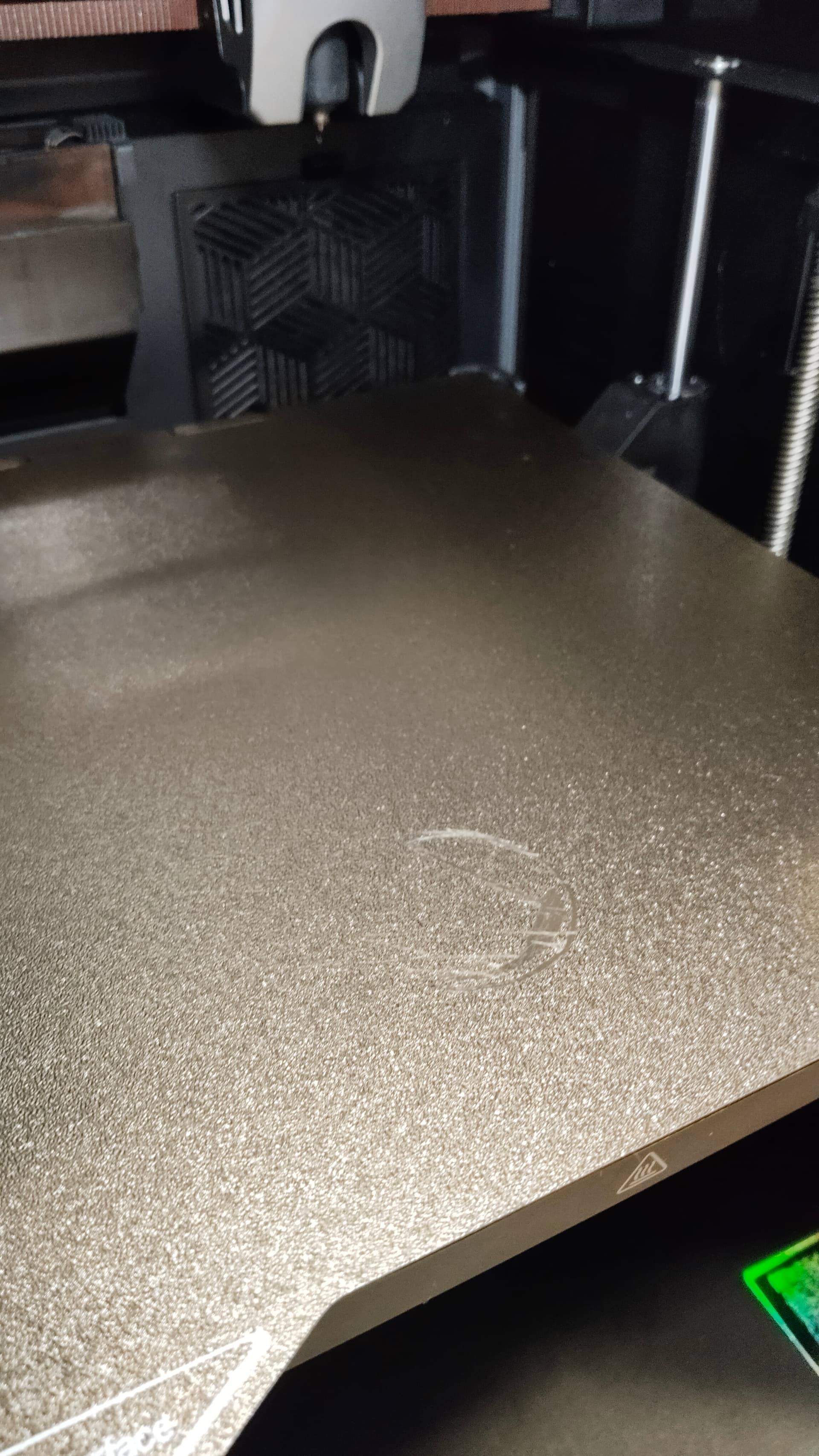

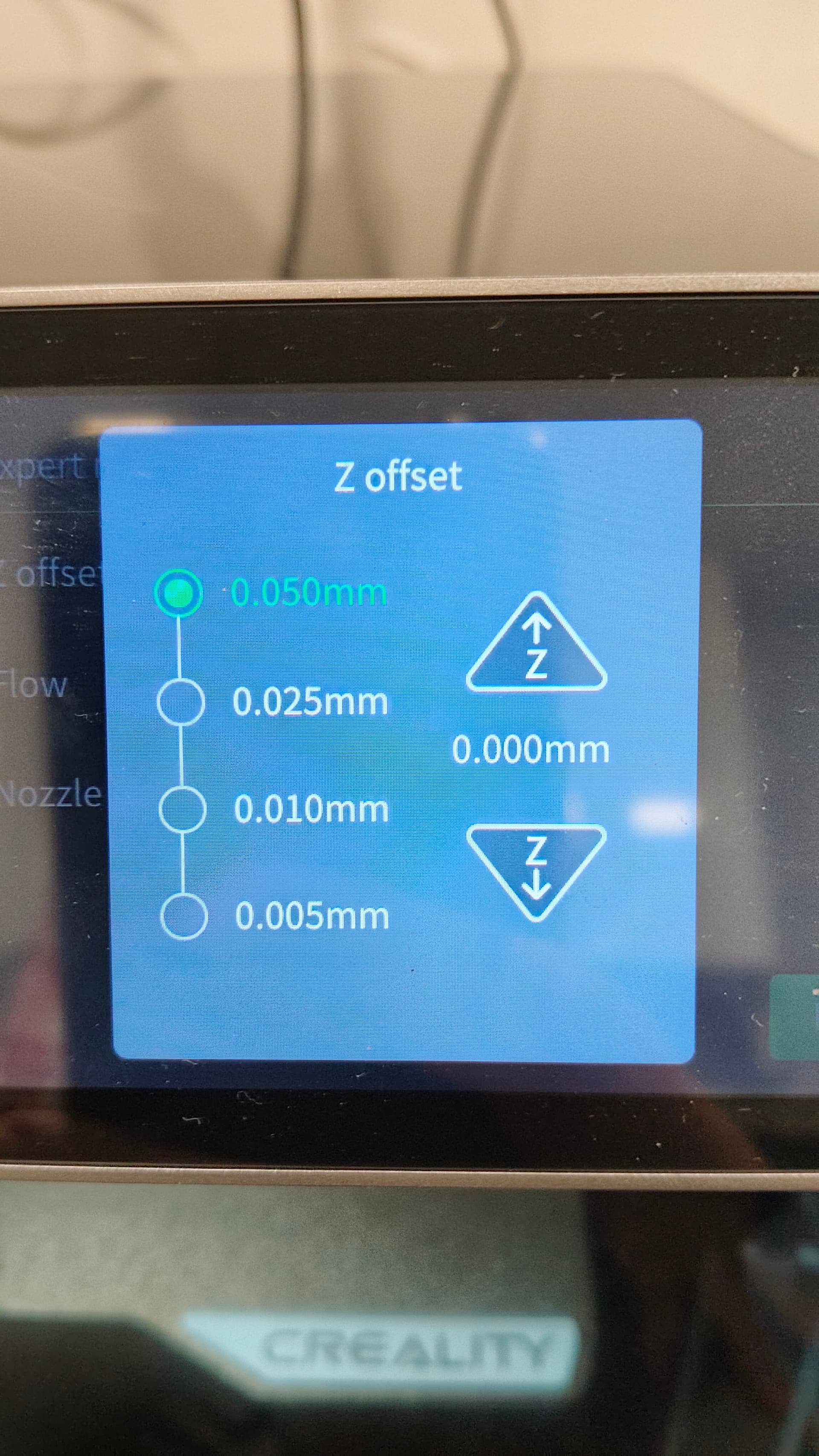

I tired to debug it and experiment with z offset setting from printer console, until I destroyed nozzle and put some atifacts to my plate by it. :slight_smile:
Why I decided to touch z offset? Because I had some suspect or hypothesy, especially when I started to pay attention that the purge/prime line for each new print became wider then it was when I changed the nozzle. Therefore I tried to check it, until the experiment went wrong…:slight_smile:. Fortunately I hope that hot-end was not affected by this performance.
By the way be very carefull with z-offset tuning from printer console, and think in advance if you really want to touch it. For me, for example, I chosen the wrong pill: neither blue one nor red one, just another one in the picture

  1. could these profile form changes of the detail be caused by quolity of the nozzle? For example the printer calibrated well before printing, but once in started to print the pressure inside the nozzle moved a bit of the nozzle tip to the plate, by causing of spreading few first layers more widely than it should be? Again it was not vissible from first few times of printing by this nozzle. I was using of creality app presets for 0.6mm nozzle, which exists there for PETG filament.

It could be the nozzles you purchased were not of good quality. Or when you installed the new .6 nozzle you did not seat it properly. Did you have the hotend heated when installing?
Definitely want to run threw full calibration after any nozzle change.
Hey! Yeah I belive it happened because of the nozzle quality. When I started to use it all looked good - I pushed the button for printing one more “table”without any changes related to nozzle, hot end, etc., with help of display of the printer itself (I was printing “cat wheel” project from creality cloud site, and there were a lot of little parts which could be printed by sending the table only once and repeating it few times). After couple of printer kilograms of plastic, the deffrect were appeared more and more, but fortunately only for first layers…
Anyway the old 0.6 nozzle were broken, as I wrote before, I bought the new one and finished the project)). Other nozzle from that purchase (0.4 and 0. 2) I’ve not used because of the original 0.4 is still good, and craalty print does not like 0.2
Do an elephant foot compensation check.
As PETG tends to flow. And yes one roll to the other can be different also humidity changes can cause it.
Standard elephant foot compensation is set to 1.
