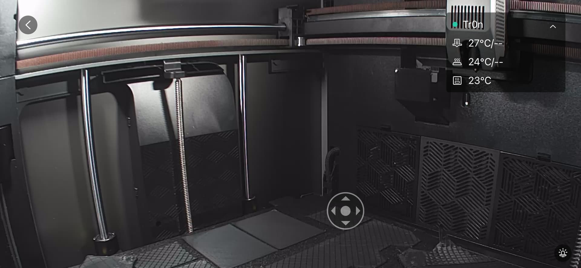

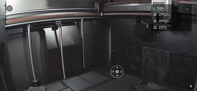

This is a screenshot from the k2 camera. I’ll post a better pic when I’m home later.

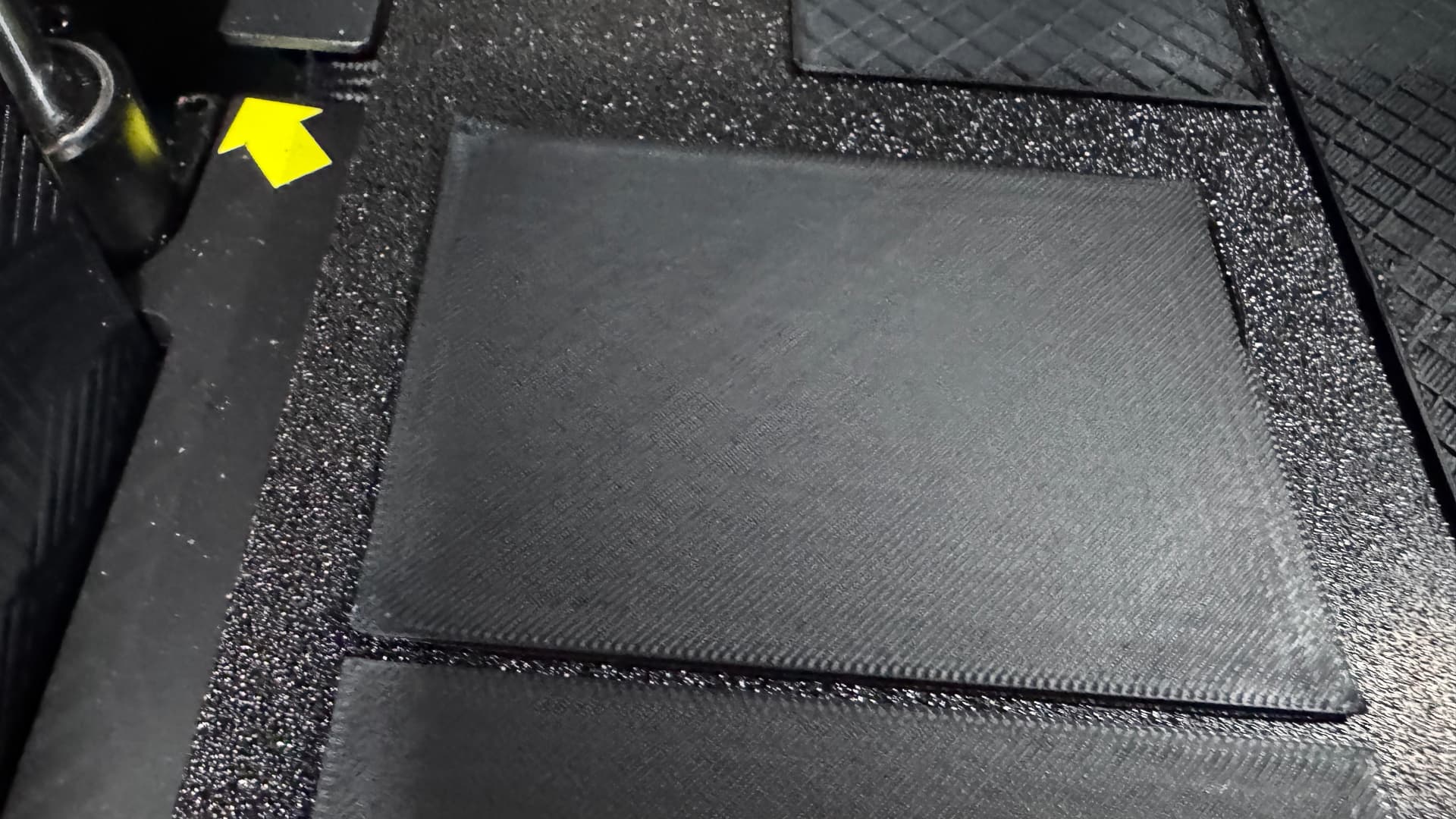

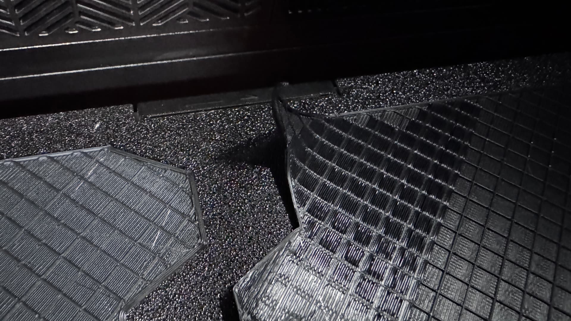

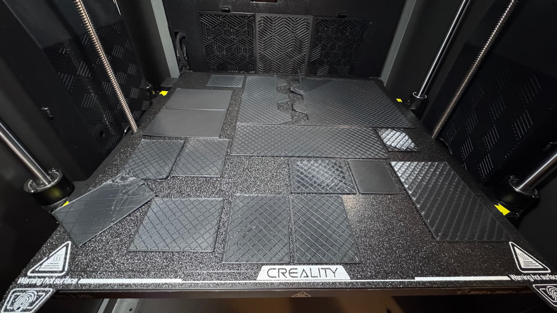

Here’s more pics:

Thanks for the response! I will look at those settings in creality print. One thing I did find is that the tolerance for the build plate for pla in general is between 50 and 60. The default is 50. When I kicked it up to 55, I didn’t have any of that corner peeling the first big print I did. But, now on the second print, I am getting some of that again.
Hmmm. Looks like adhesion issue. When you did the bed leveling, did you have 10-15minutes with the bed at 50°C before doing it ? And how is your bed mesh by the way ?
And how is your Z-offset ? When I look at the print in the middle, the first layer seems to be really ugly
@dogeared The plate temp will vary with filament brands. On Hatchbox I usually run 55 and occasionally go up to 60. With Polymaker, 50 top 55 works. @Alex2Lab makes a good point. These hot beds don’t come up[ to temp as fast as they indicate. Give it a good 10 minutes to stabilize temperature at the outside edges. the edge curling looks like something else. How are the fan settings? That last photo looks like flow rate (which can also affect curling and adhesion. All in all, the settings interreact quite a bit (especially hot end temperature).
Since there are so many interacting settings happening all at once, I’d bite the bullet and go through the tedious calibration process. Go in order. you can skip some. I highlighted the most crittical ones.

Thanks for all the replies! It’s really helped. I think the combination of making sure the filament’s dry, raising the bed temp slightly and tightening everything up has made a huge difference.
