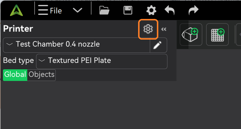

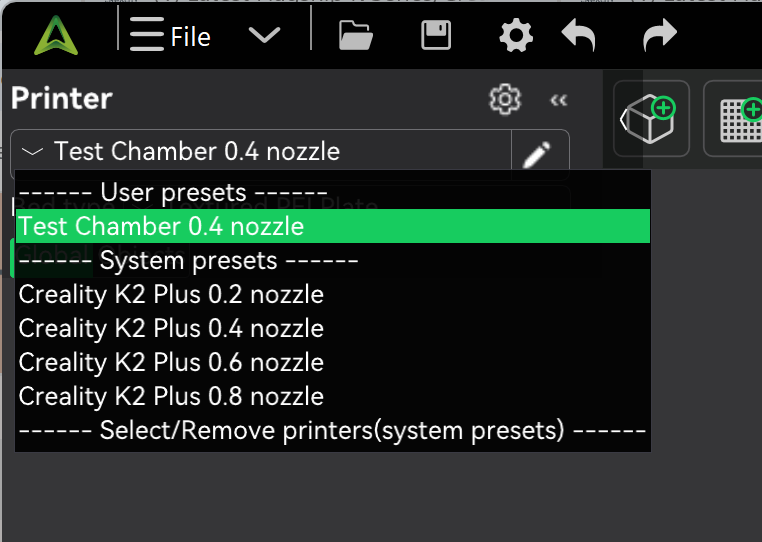

For the nozzle sizes, you have to add the machines (nozzle sizes) separately. Click the Settings icon up top, and wait patiently.

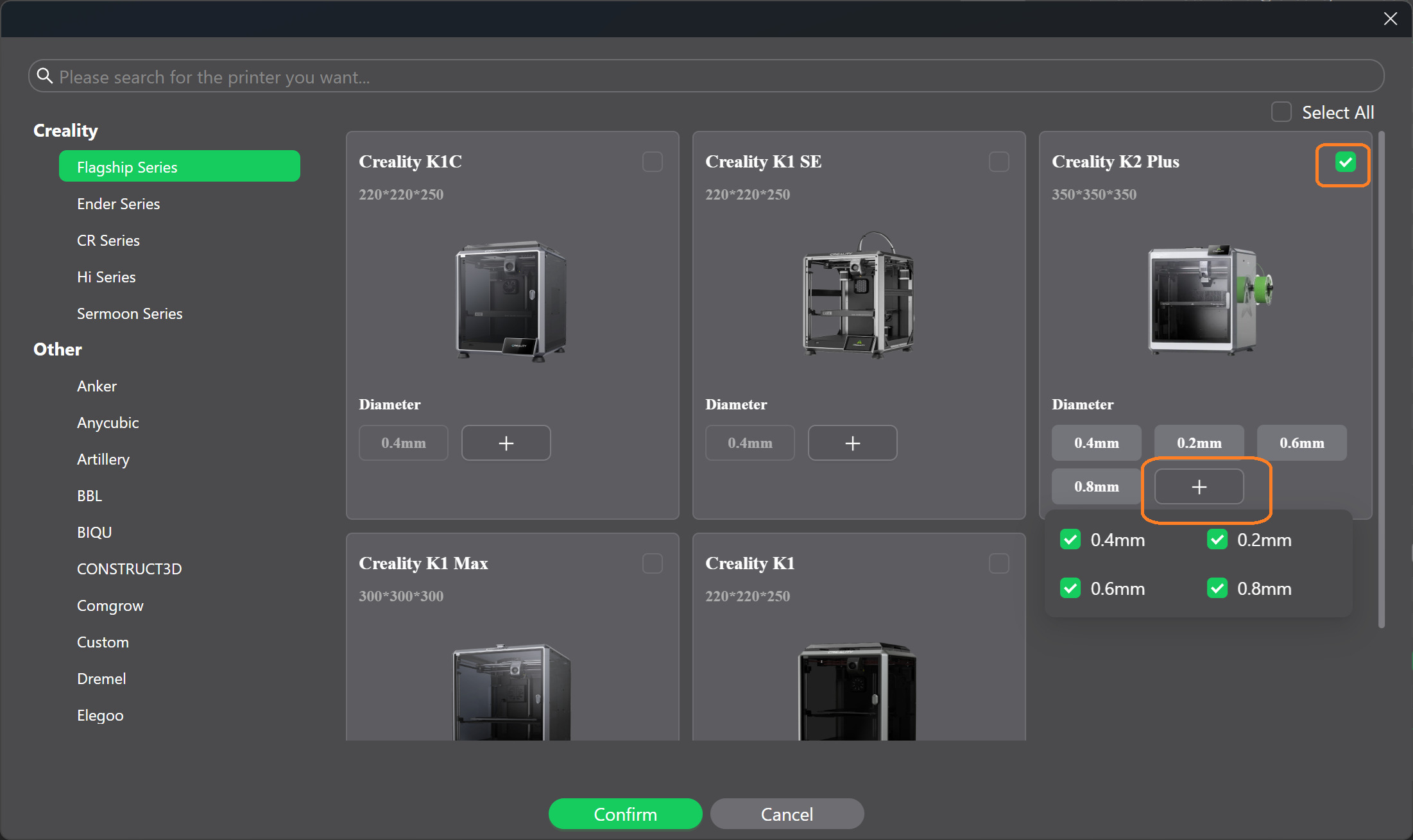

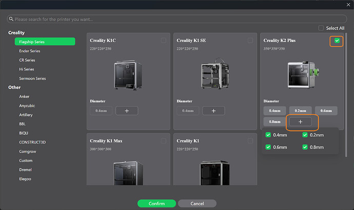

Until you see the settings page. You have select your printer, then use the “+” button to add multiple nozzle sizes.
Then you have be sure to choose the correct printer from the list:

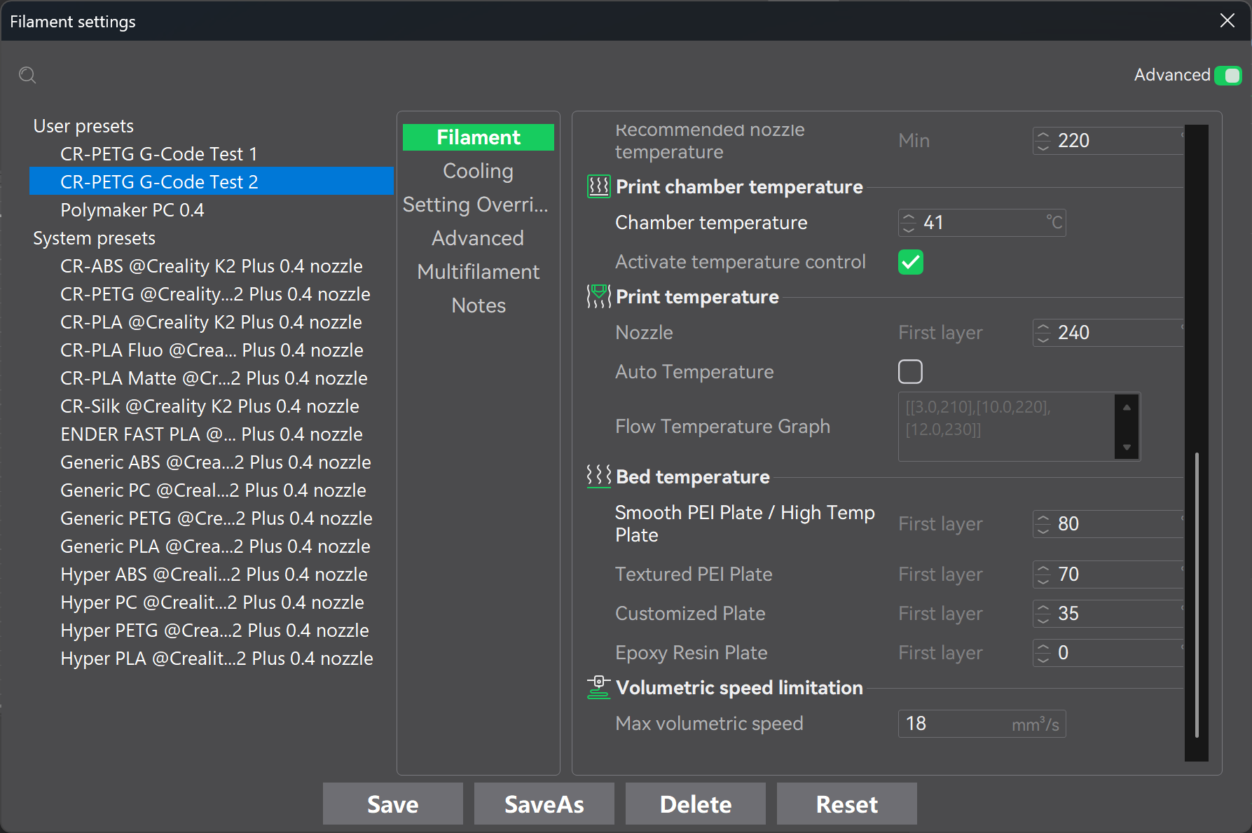

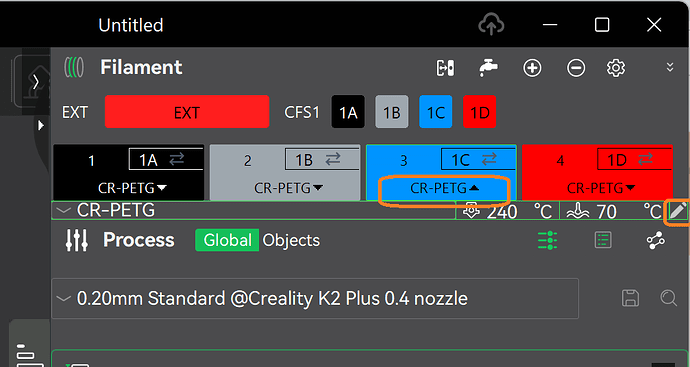

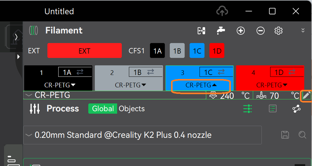

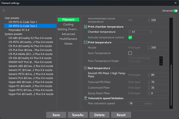

Filament settings can be accessed by clicking on the filament listed in whatever this is called. It will open a dropdown list to choose a filament, but the pencil icon on the far right will open the filament setting window.
There are a whole bunch of settings here, including nozzle and bed temps:

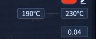

Sorry guys i may have typed poorly… I mean the pressure advance and the nozzile temp that you put in the printer when you get new filament here is the photo i you still dont understand.
