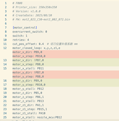

I was able to start normal printing on the latest firmware (1.1.4.11) after swapping X and Y motor pins (step and dir) in motor_control.cfg:
And if after that you still have issues with homing on X and Y axis you could try to add at the end of printer.cfg file this lines:
[motor_control]
  x_param_stall_pos_err_rad: 0.016
  y_param_stall_pos_err_rad: 0.016
This decreases stall position sensitivity and motors moves further to home position despite of some resistance.
