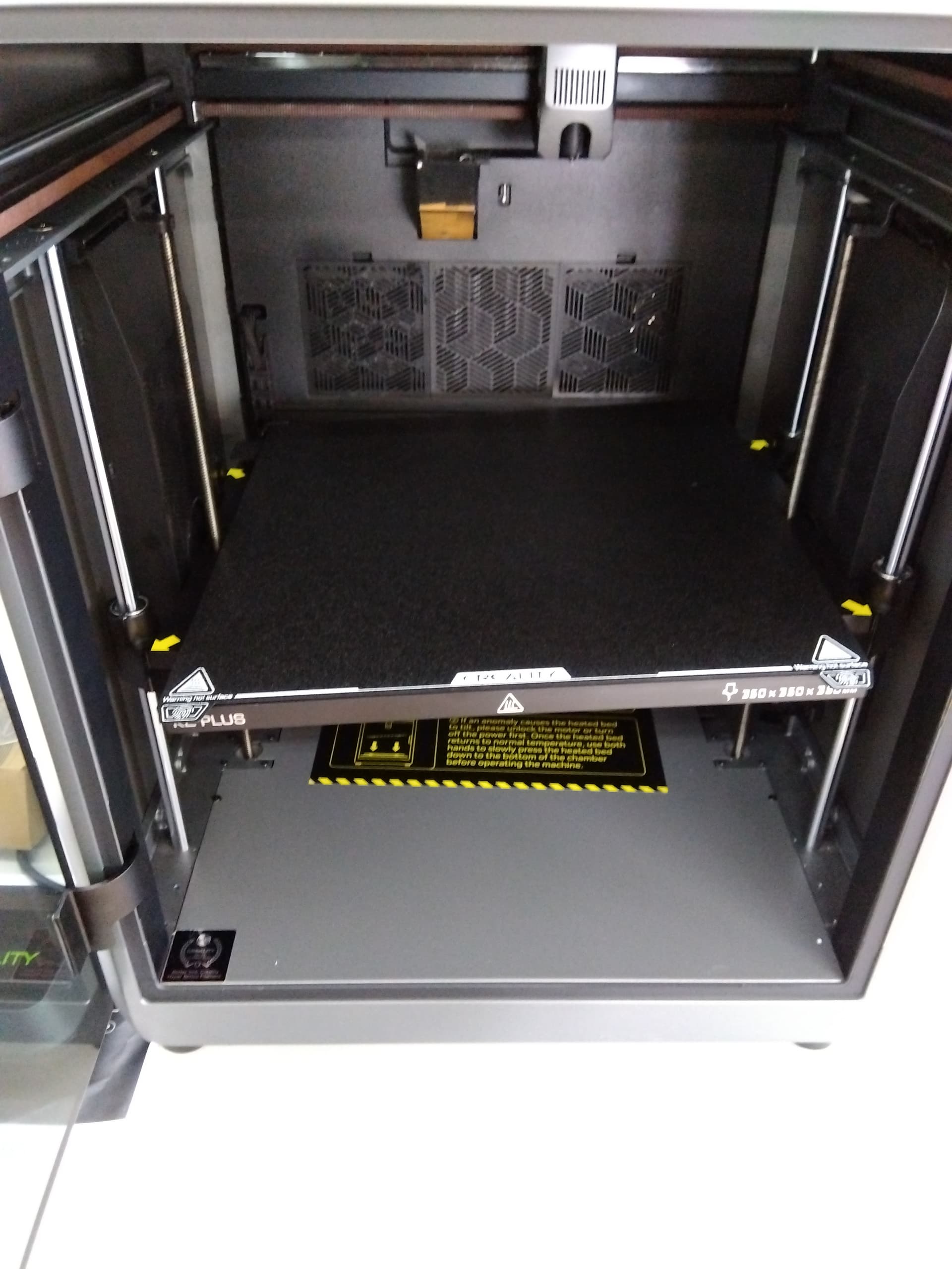

【K2plus】It prints fine, but when I turn it off, the bed is tilted
I am using K2plus and when I turn off the power after printing, the heat bed tilts. Is this normal? When I make a new print, it adjusts at that point and prints fine.
Is it wrong to turn off the main power (red button) immediately after removing a print? However, I don’t know how else to turn off the power. Because I can’t find the option to turn off the power on the device screen.

Bed is heavy. It’s normal when bed lowering without power. If it stuck tilted, just slightly push it down.
It’s OK to turn it off with main switch, but I would not do it if you print in 30 minutes something else. because every switch cycle puts more stress on the system than 30 minutes idle time.
Anyhow, it just seem that the rods on right side seem not to slip that easily than the one on the other side.
Give them some cleaning (also look how to clean the Z-Spindle on the Wiki) and then some grease (I think they propose WD40 silicon spray).
Mine mostly goes down evenly when powered off, but occasionally does what yours did. Again, a light push down on the high side (or even up on the low side) gives it enough level to align the bearings on the guide rods, and it’ll fall on it’s own.
Also, if you need to power off the printer (again, I’ll echo other advice here, that you should leave it powered up if you’re going to print again within a day or so, as you don’t want to lose the bed mesh config) you can plug it into a TAPO wifi controlled plug. My printer is set up in the corner of my office and it’s really difficult to reach the power switch in the back. So I simply use my 'phone to access the TAPO app and power it up or down. One added benefit is that the TAPO plug monitors the power consumption of the printer, giving me instantaneous and historical usage stats :-).

I only use it a few times a week so I guess I should turn it off at the end of the day. I received the lubricant you taught me today and have put the maintenance instructions into practice. Once again, thank you very much.
