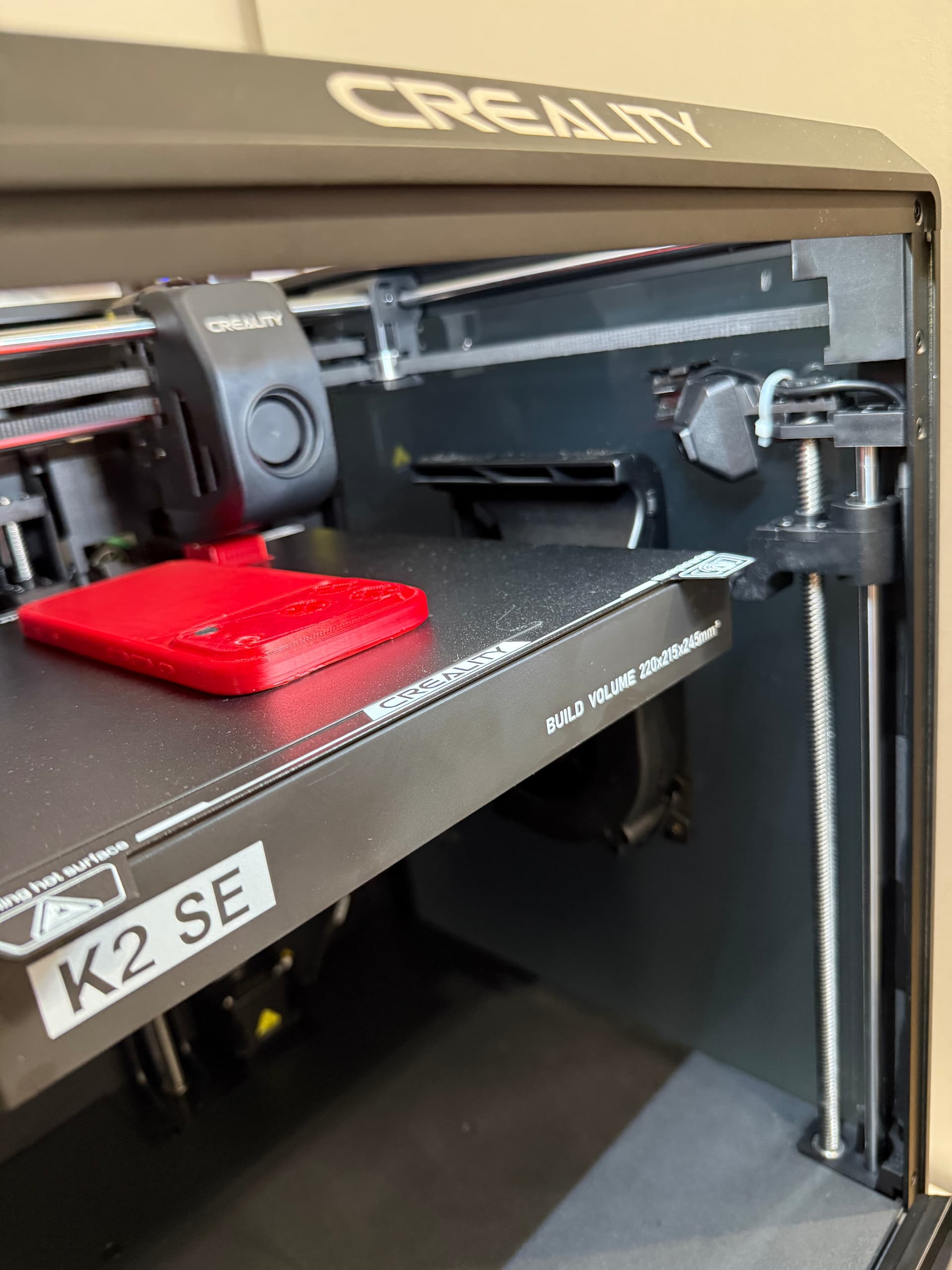

Hello Guys, so I recently got my daughter the k2 SE combo and thought it came with a camera when I realize it didn’t I ordered the k2 camera and the k1c adapter cable, I printed a different mounting bracket so I could mount the camera however it’s not recognizing the camera at all. The green camera icon doesn’t show up and when I try to turn on AI monitoring it says camera not detected. Did anyone run into this problem ?

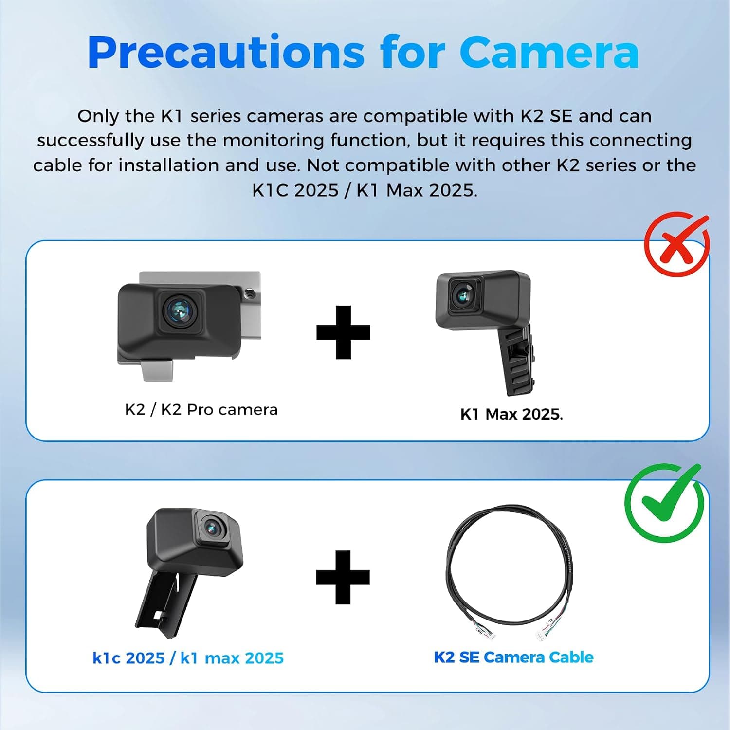

I tried 3 cameras:
  1. The K2 Pro - dosen’t work
  1. Then the K1c 2025 / k1 max 2025 - doesen’t work too

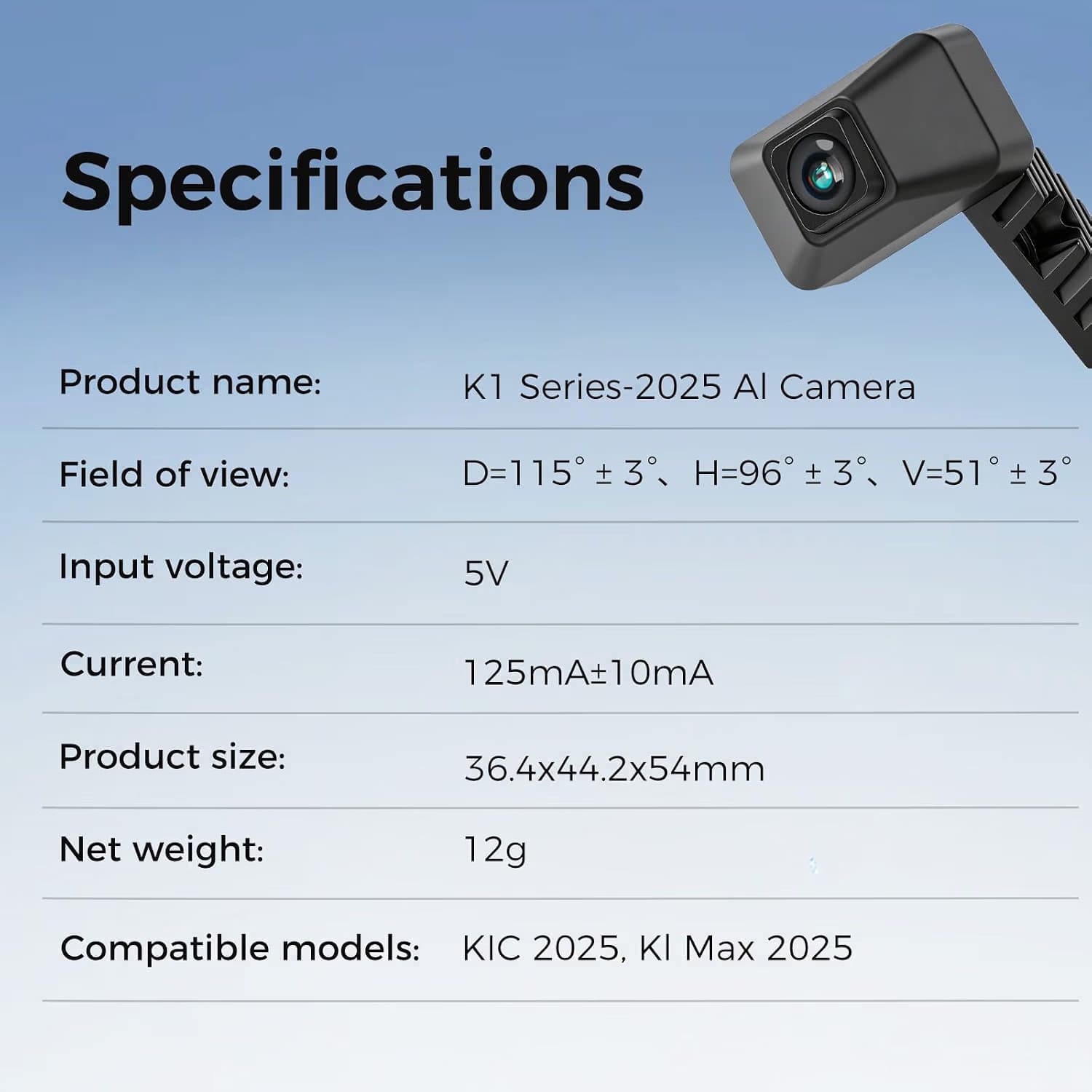

I bought this cabel:
but the information about the compatibility isn’t true:
My setup is the cable for 13,59zl and the “K1 Max 2025.” with the riffles:

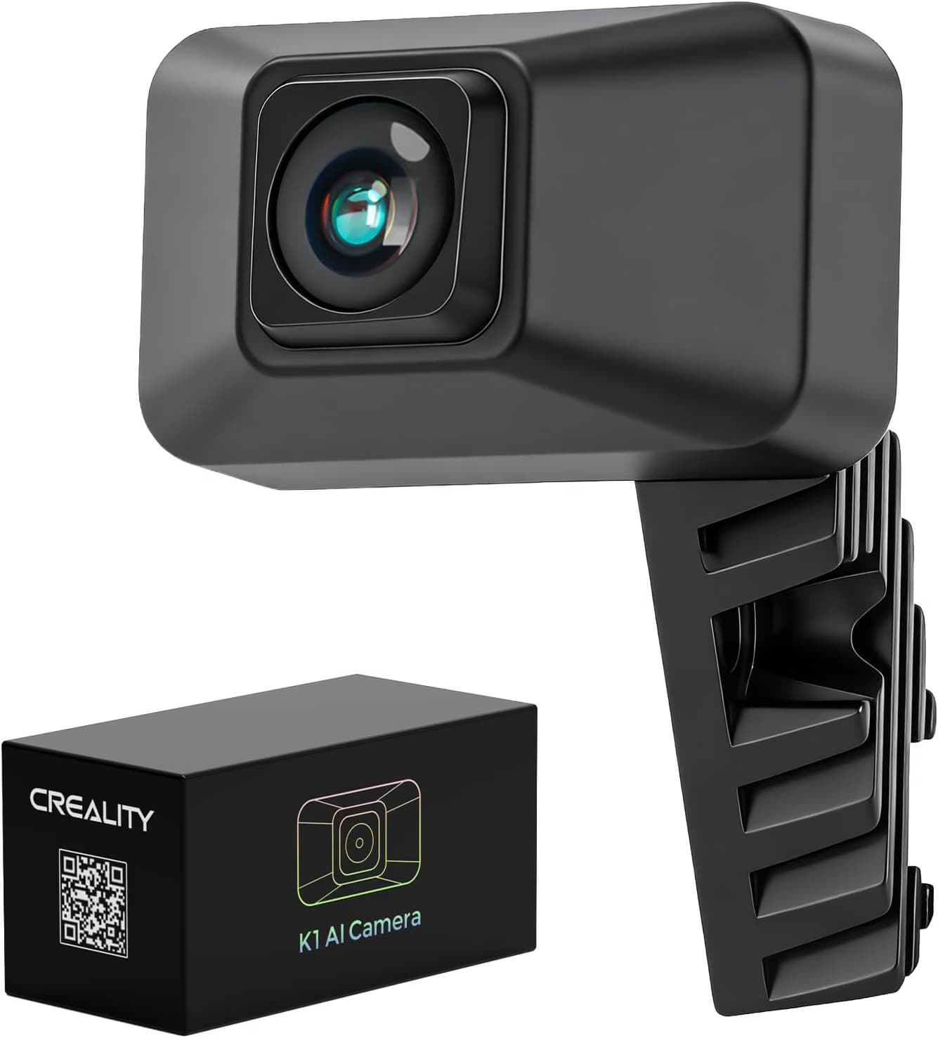

I just want to ask you if this is the right one, cause I want to add a camera to my K2 SE, I think the cable is the right one but not really sure about the camera cause looks different from the picture, its called K1 C 2025 but…
its the right one?
I have just installed a camera and it does work. Use the Camera for the K1 with the extra long cable. Both are available from Amazon .
Creality Official K2 SE Camera Cable, Original 3D Printer Camera Wire, Compatible with K1 Series AI Camera, Time-Lapse, Connects the K1 Camera to the K2 SE 3D Printer for Remote Monitoring : Amazon.co.uk: Business, Industry & Science
and this camera…
Creality Official K1 AI Camera, HD Quality Camera,Time-Lapse Filming, Real-time Viewing, Easy Install- Real-time Monitoring on Your Phone and Enhanced Efficiency, K1 MAX/K1 SE 3D printer : Amazon.co.uk: Business, Industry & Science
