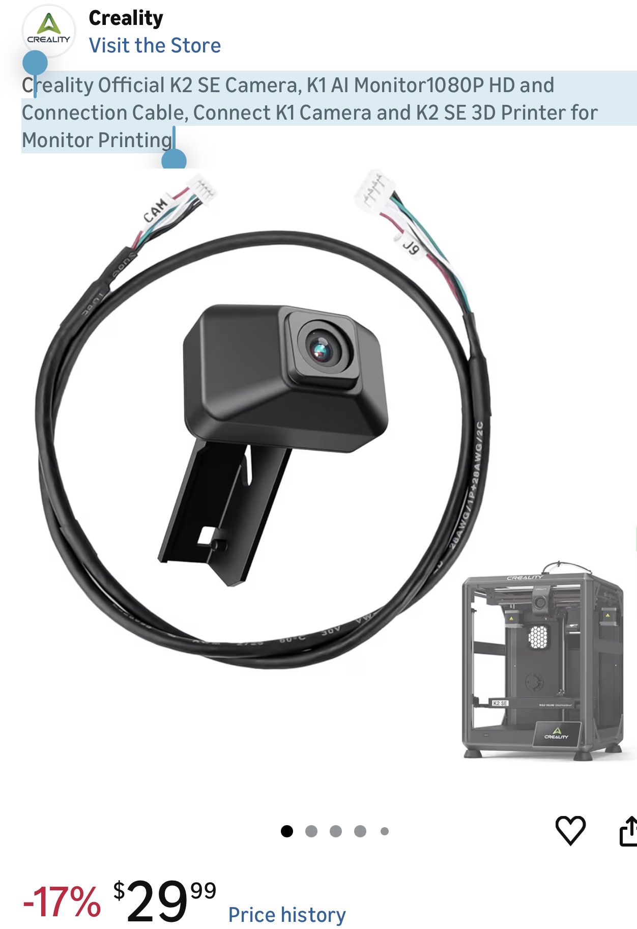

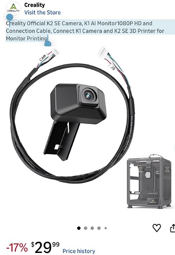

Found this “Creality Official K2 SE Camera, K1 AI Monitor1080P HD and Connection Cable, Connect K1 Camera and K2 SE 3D Printer for Monitor Printing” for $29 on Amazon seems to have camera and cable bundled. Going to give it a try.
