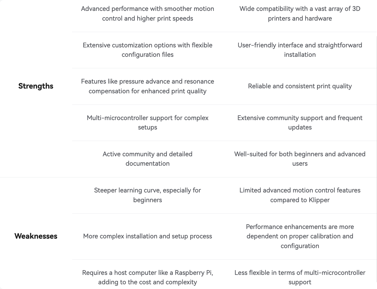

Klipper vs Marlin Pros and Cons Overview
Conclusion
In summary, both Klipper and Marlin have distinct strengths that cater to different user needs. Klipper excels with advanced features and performance, ideal for experienced users seeking greater control. Marlin offers wide compatibility and ease of use, perfect for beginners. Choosing the right firmware depends on your specific requirements and technical expertise. For high performance, Klipper is the way to go, while Marlin suits a broader range of users.
