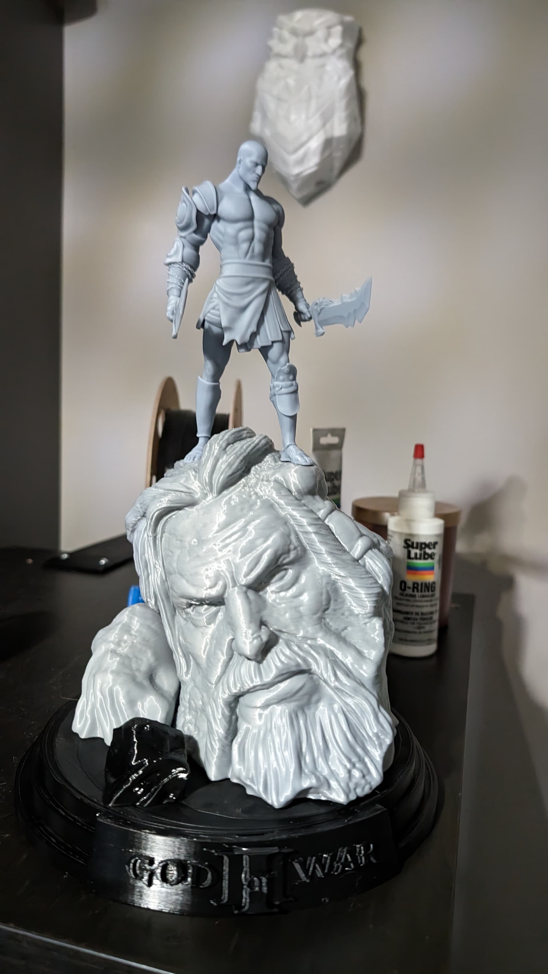

First time posting as I’m new to this. This is a mixed format using filament and Resin. The base and Head was created on the Ender3 s1 and Kratos was created on the Halot mage non pro. On the Ender, used Petg filament at 250/65 80mm .20 layer on a .4 nozzle. The Halot Mage was .05 layer, 8 height, 2 speed, 3 light off. 27 Int Ex and 6 bottom with a 2.1 time. Model came from Etsy. This was a fun project and enjoyed printing and painting this project as it will be a gift for my dad for father’s day.
