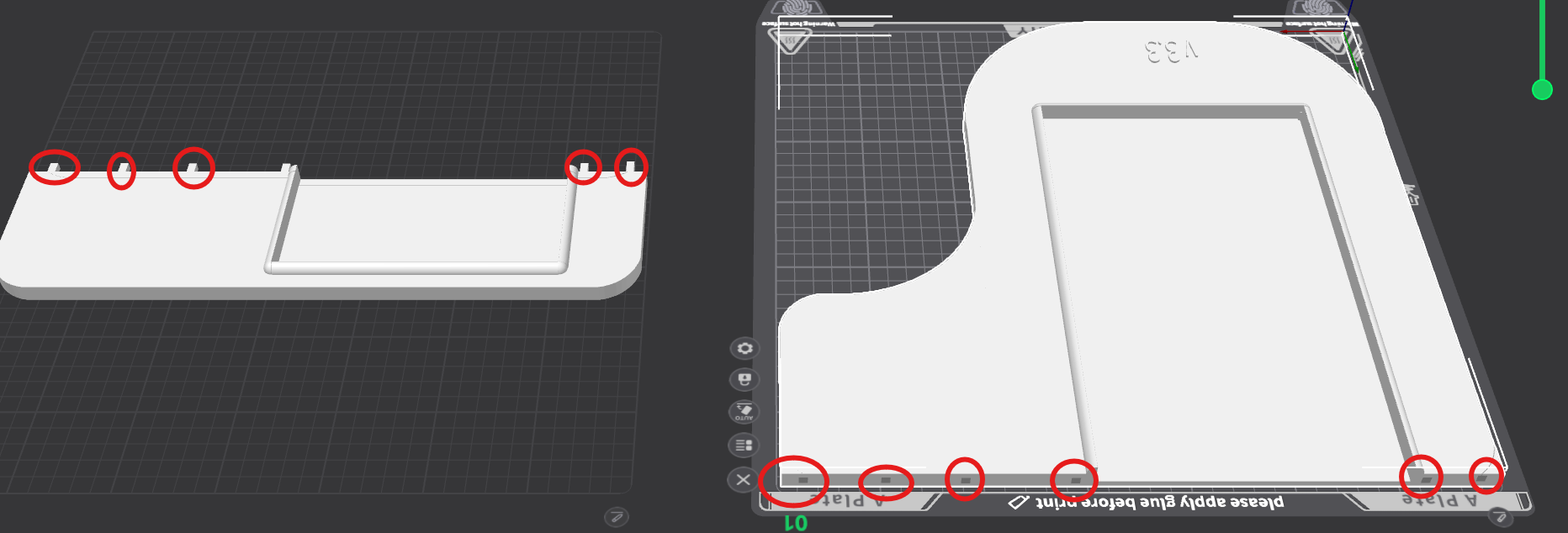

i have a creality k2 - can a make a larger print (bird house) ? thanks

The print volume is the print volume. If the bird house doesn’t fit in the print volume, then the next thing is to cut the parts into smaller pieces. I just discovered (doing a large print myself) that Print-7 has some nice new connectors to make putting the pieces together work better.

I was assuming you used Creality Print 7 for your slicer. The latest version (7.2, I think) has added some nice slicing and joining tools.
here’s one I’m working on right now. It didn’t fit, so I sliced it into 2 plates and used teh connector (button in the slice tool) to make the pins and holes circled in red.
Yeah, that is very cool. Unfortunately I’m not using Creality slicer. I’m using CURA.
Try the Creality slicer. I was a total CURA guy for years but then wanted to send a print to the next room over, where I have my printer. Once I did that, I was hooked. Just one more thing to broaden your experiences.
