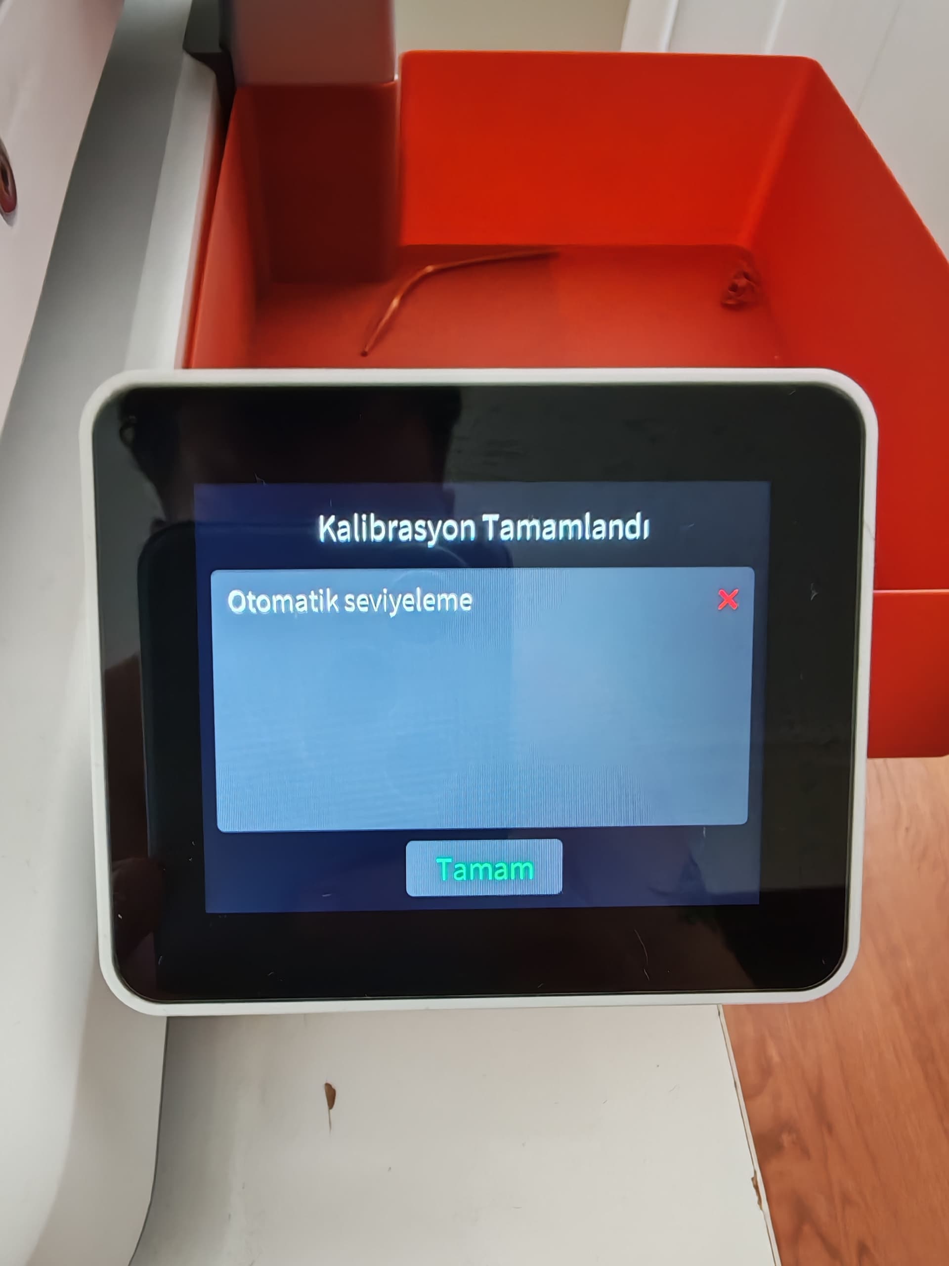

I did everything, I uninstalled the last update and went back to the previous one, I turned off all artificial intelligence features, I calibrate, I always get a cross like this in this leveling setting part of the 3-stage calibration, there is no problem with my prints or the printer, or I don’t see this as an error on the message screen, but is it normal for this to always be crossed since the first day? Is there a screw etc I need to tighten?
The red X during the auto-leveling phase does not mean your printer is broken. It means the sensor detected a value that it flagged as “out of range” or “failed to verify.” It is not a actually a problem.
Since your first layer is consistent and the prints adhere, the “red X” is just a UI artifact. Many users ignore it because the printer’s mesh compensation (which actually adjusts the print height) is still active in the background, even if the calibration screen displays an error. However if you want to get rid of the red x, try the steps below

  1. Hard Power Cycle: After you run a calibration and get the X, turn the printer off via the physical switch on the back. Wait 30 seconds, then power it back on. This forces the printer to clear the volatile memory (RAM) and re-initialize its status registers.
  2. The “Ghost” Build Plate Fix: Remove your build plate entirely. Use a flashlight to inspect the black heating bed underneath. If there are any tiny flakes of filament or “blobs” of plastic stuck there, the sensor will hit them and flag a failure. Scrape the surface clean.
  3. Perform a Factory Reset (Again): Try it one more time without connecting to the internet (or ensure your Wi-Fi is disabled) so the printer doesn’t try to pull an automatic update. Run the calibration before setting up the network.
  4. Check the “Z-Hop” and Probe Settings: If you have access to the hidden or advanced settings in your current firmware version, look for anything related to the “Z-offset” or “Probe.” Sometimes, setting the Z-offset manually (as discussed earlier) overrides the “fail” state that the auto-leveling system is stuck in.
