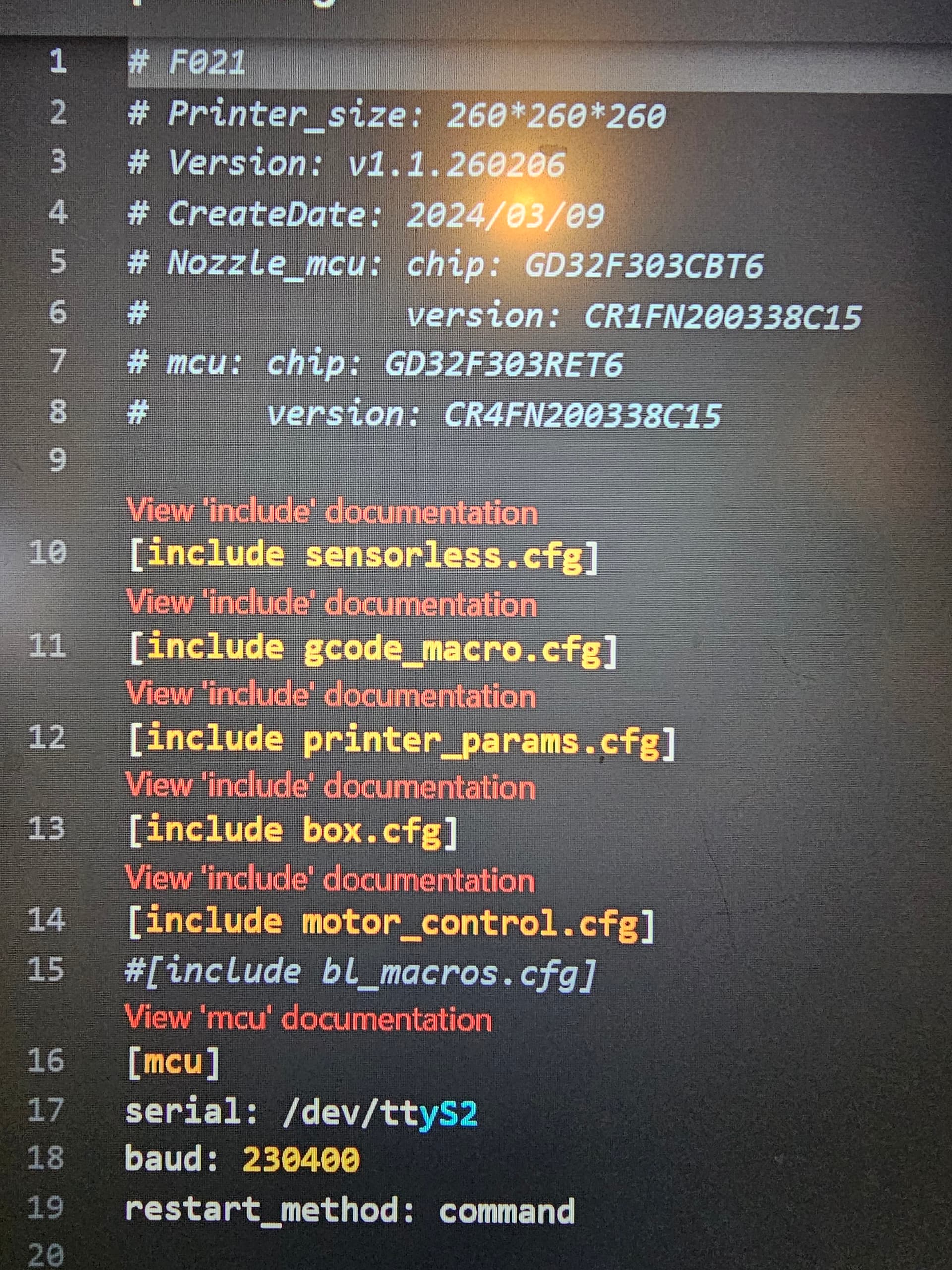

Go into printer.cfg files, find [include bl_macros.cfg] (mines is line 15) and put a hash at the start of the line, save and restart.
Worked for me.

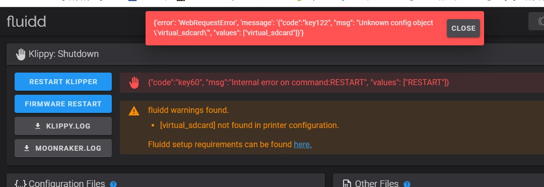

First of all. The printer magically powered on.
So I am now back to square one with Error XS 3002 on the printer and this Error from Klipper.AI said to delete this line and I did with no help.

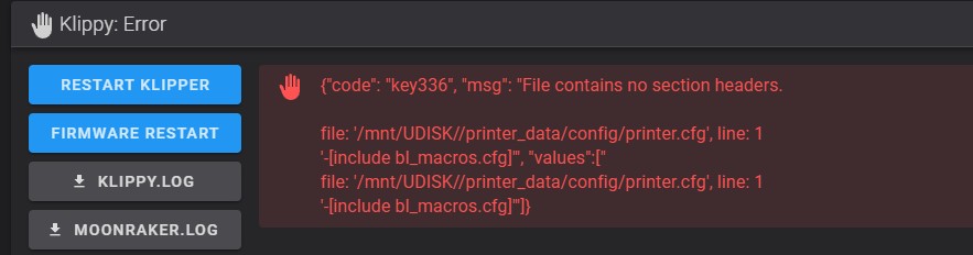

I tried what you said and I get this:
Still waiting for help from Creality. Thanks for your attempts Barry.
This is how my printer.cfg looks
after adding the hash.

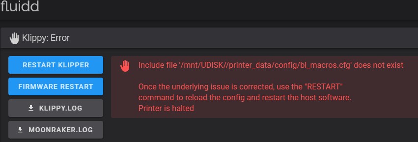

This is what I get with a hash:
Is the hash still there when you go back into printer.cfg.
Yes the hash is still there. However it is greyed, as I now see yours is, Is there a way to insert a whole new, supposedly good, configuration? Somehow the update caused it so I find it hard to believe I’m the only one effected.

Try deleting the whole line then press the save & restart option.
I failed a few times, i had a space before the hash at the start of the line and i pressed the save option rather than save & restart.
