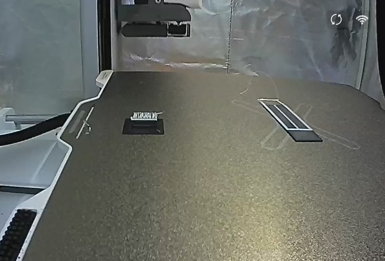

The printer sometimes loses position mid-print, ending up with shifted layers for the rest of the print.
It’s happened on a handful of prints so far, and I’ve just now seen it live – at a filament change. After flushing, the print head went back to printing and there was a loud clunk, and started printing off the side of the part that was already there.
Any help is greatly appreciated!

Thank you! Didn’t see that part of the wiki.
It appears to have been resolved after lubricating the machine (fingers crossed) and slowing things way down below factory presets
