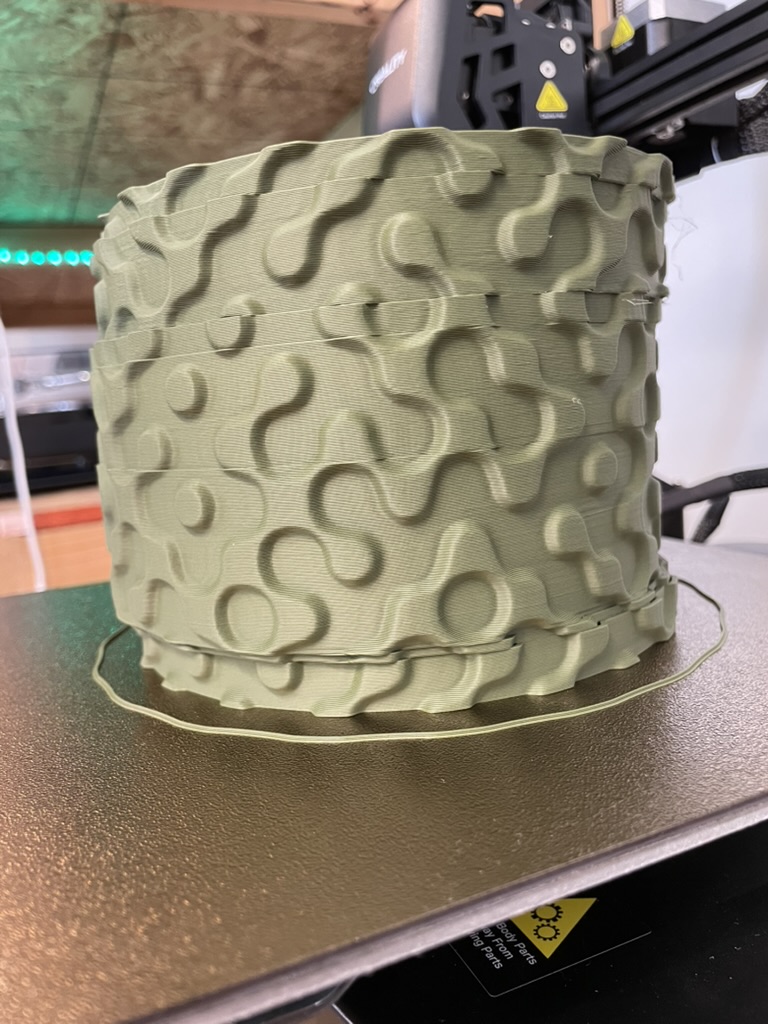

I have an Ender 3 V3 SE connected to a Sonic Pad as well. I’m getting really bad Y axis layer shifts. Could you please walk me through changing the current in Fluidd. I would really appreciate your help on this.
Thanks in advance.
I figured out how to change the config file. :slight_smile: I’ll update the post with my results. Please share any other suggestions on how to fix this issue.

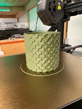

Update
Success! Changing the current made all the difference. I printed it smaller to save filament, just in case.
