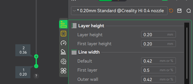

Trying to print a multi-color model with Creality Print 6.3.1.3548 on my Creality Hi, using the standard 0.20 layer height profile…
Initial layer is set to 0.20 mm, and layer height to 0.20mm - but when slicing, the initial layer height is 0.20, and the following are 0.16mm ? If using the same settings on a plate only utilizing a single color, things works OK.
Setting layer height to 0.21 mm (for both) does not seem to change anything but the initial layer height…
Found out, that someone did a layer height 0.16 on the object ….
