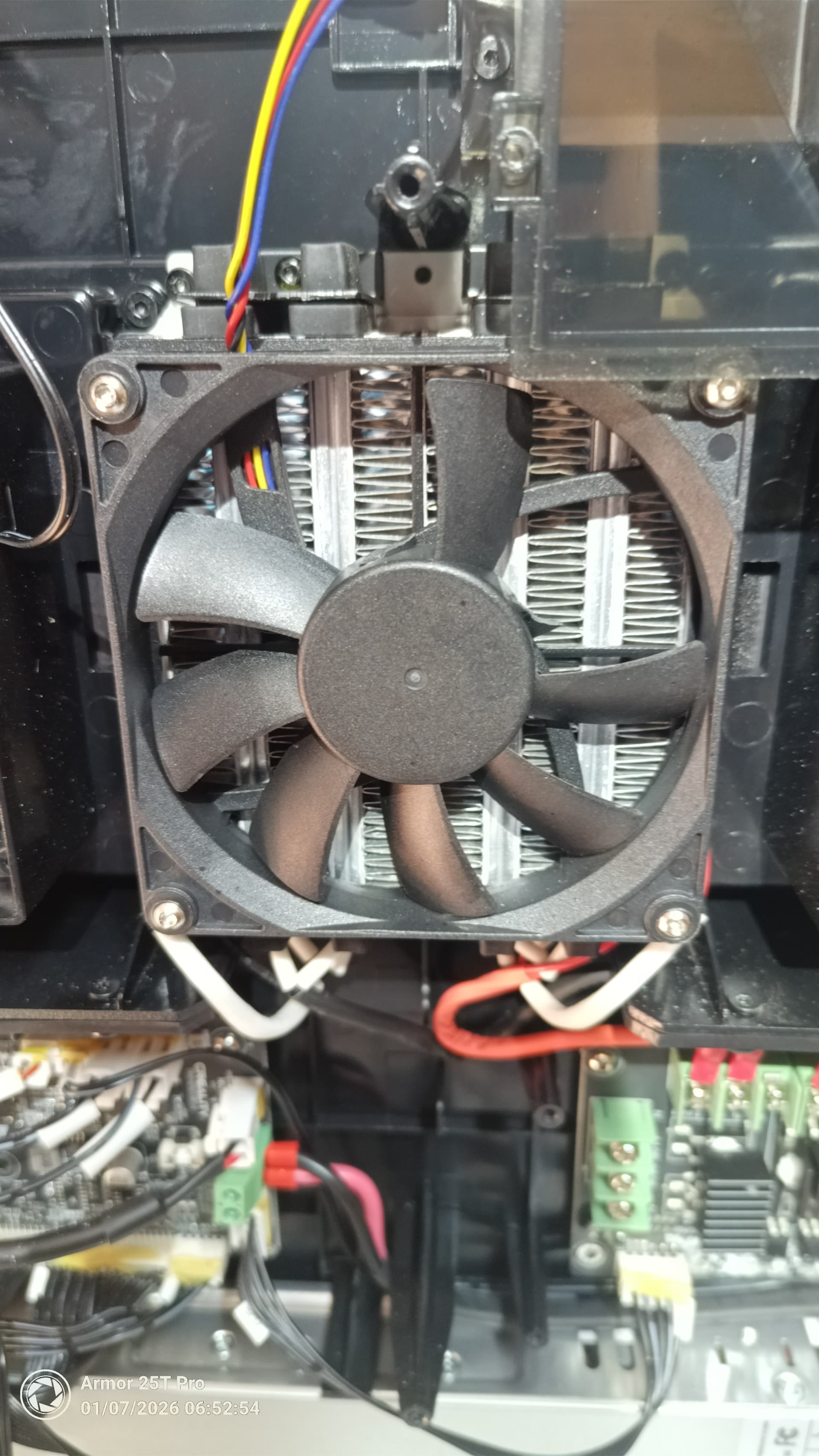

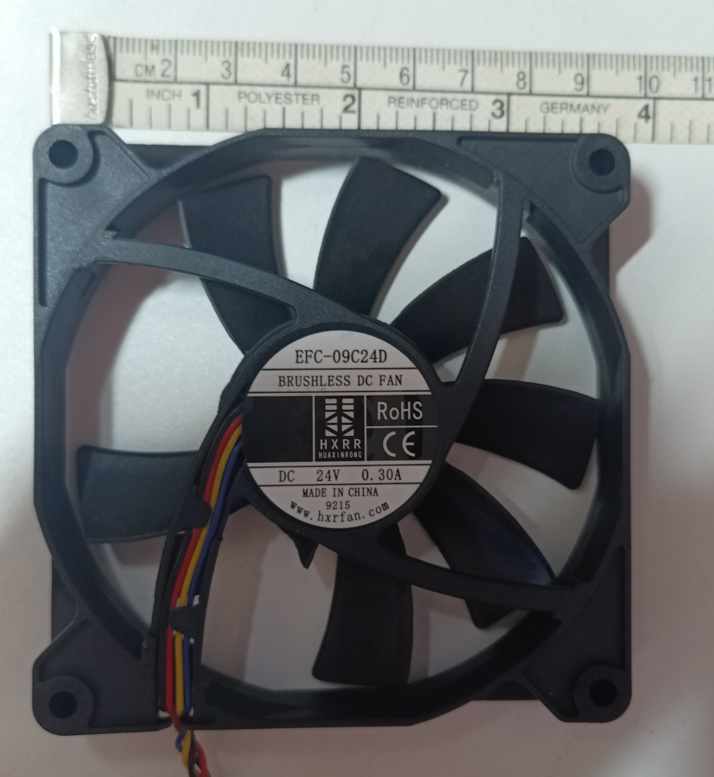

Looking urgently to buy a new rear heater chamber fan for my K2 Plus. Its a “92mm x 92mm x 15mm 4-wire 24v 0,30A fan”. I cannot find a replacement anywhere. Does someone know where i can buy this fan.
Don’t know what country your in but search EFC-09C24D fan yields ebay uk though from China. :frowning:
or may be
https://www.mouser.co.uk/c/thermal-management/fans-blowers/?height=92%20mm&m=Delta%20Electronics&operating%20supply%20voltage=24%20VDC&product%20type=DC%20Fans&width=92%20mm
It would appear to be a 3 wire Delta EFC industrial series 24volt
Thanks! but I still cant find one thats 15mm wide. There plenty that are 25mm, but then the back cover wont fit.
I cannot find that 15mm depth on the actual makers site and so I would guess it is only available via Creality.
Can only find a 20mm or 25mm depth on its site

At the moment, my printer is basically a useless brick without this fan. As soon as it starts up it throws an error code if the fan isn’t detected, so I can’t even print filaments that don’t require a heated chamber.
I’ve searched everywhere (globally) and cannot find this specific fan model in 24V anywhere. The only workaround I can see is fitting a step-down transformer and running a 12V PWM fan (which I can get from Amazon/Temu), but that really shouldn’t be necessary on a fairly new printer.

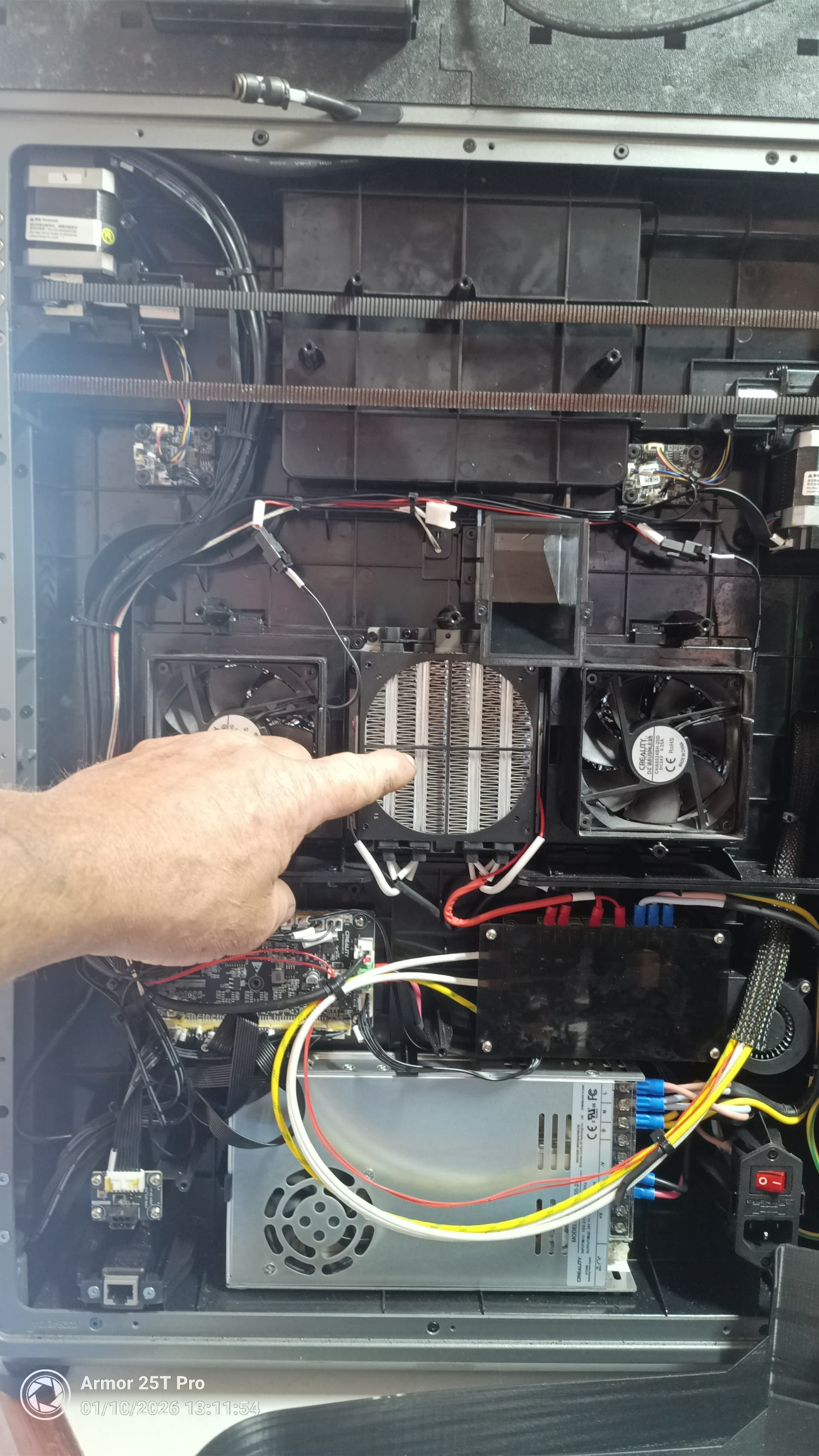

Not really just fan, but seem whole ssr assembly.
Have look at mouser/rs online/digikey for similar size voltage fans and crimp/strip your own wiring may be cheaper getting whole new assembly.

Thank you very much. Although I dont need the heating part it will have to do. Will see if they ship. :+1:
@Robert_Honneysett Can you confirm the distance from centre of holes across top of original ? Your picture with tape implies 90mm approx but overall width is 90/92mm. so confused.
The Aliexpress is 90 wide with 80 mm between centres. Will it fit ???

There is one model now available on Amazon. Amazon.com: DC 9215 5V 12V 24V 0.45a Ball Bearing Four-Wire PWM Temperature Control Speed Control Chassis CPU Cooling Fan 9cm(24v) : Electronics
